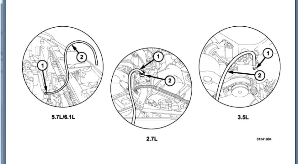

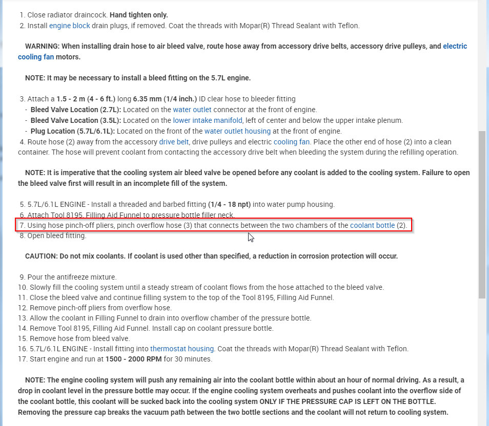

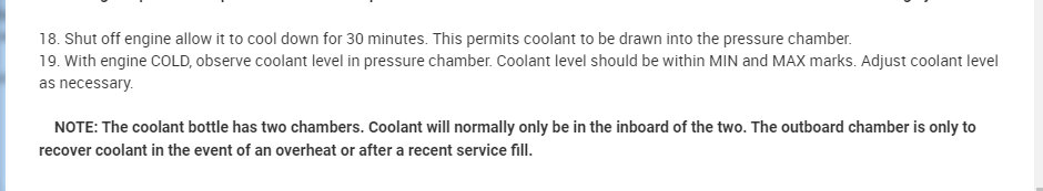

Okay. Sorry for the delay. Those do not seem to be too bad so I would not think you have a blockage. However, I just thought that because this is a 2.7L it does have a bit of an odd process. I attached what needs to happen to ensure you don't have air pockets. Take a look at this and let me know what you find.

Does it matter which one of the bleeder screws I bleed system? there is two
one in front on housing and one just behind it. I've been bleeding through the back one.
Jul 18, 2020 at 12:04 PM
The behind the housing would be correct. As for the leak, I doubt that will cause it but it clearly should be corrected.

Understand and I replaced the o-ring on the heater pipe and will now bleed system per the procedure you sent.I will let you know what happens.

Okay, did just like you said in the procedure and still same. I'm puzzled, I put new cap on small tank and still it building little more pressure than the 18 lb cap and coming out the overflow hose while driving! Just a little.
I can buy a new radiator I guess and see what that does. For now I'm going to put thermostat back in and fill it and bleed it and go from there. Not sure what else to do at this point.
