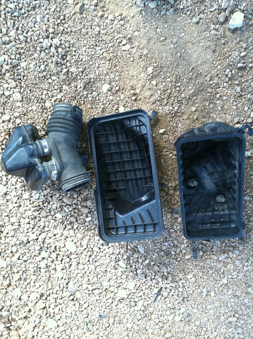

Its on the air intake
Thursday, January 21st, 2021 AT 2:52 PM (Merged)
JASONZAIDA
This is the air intake, no meter.

It has a MAP sensor on rear of intake. Check the vacuum line to it, if leaking it will cause the problems you describe.
