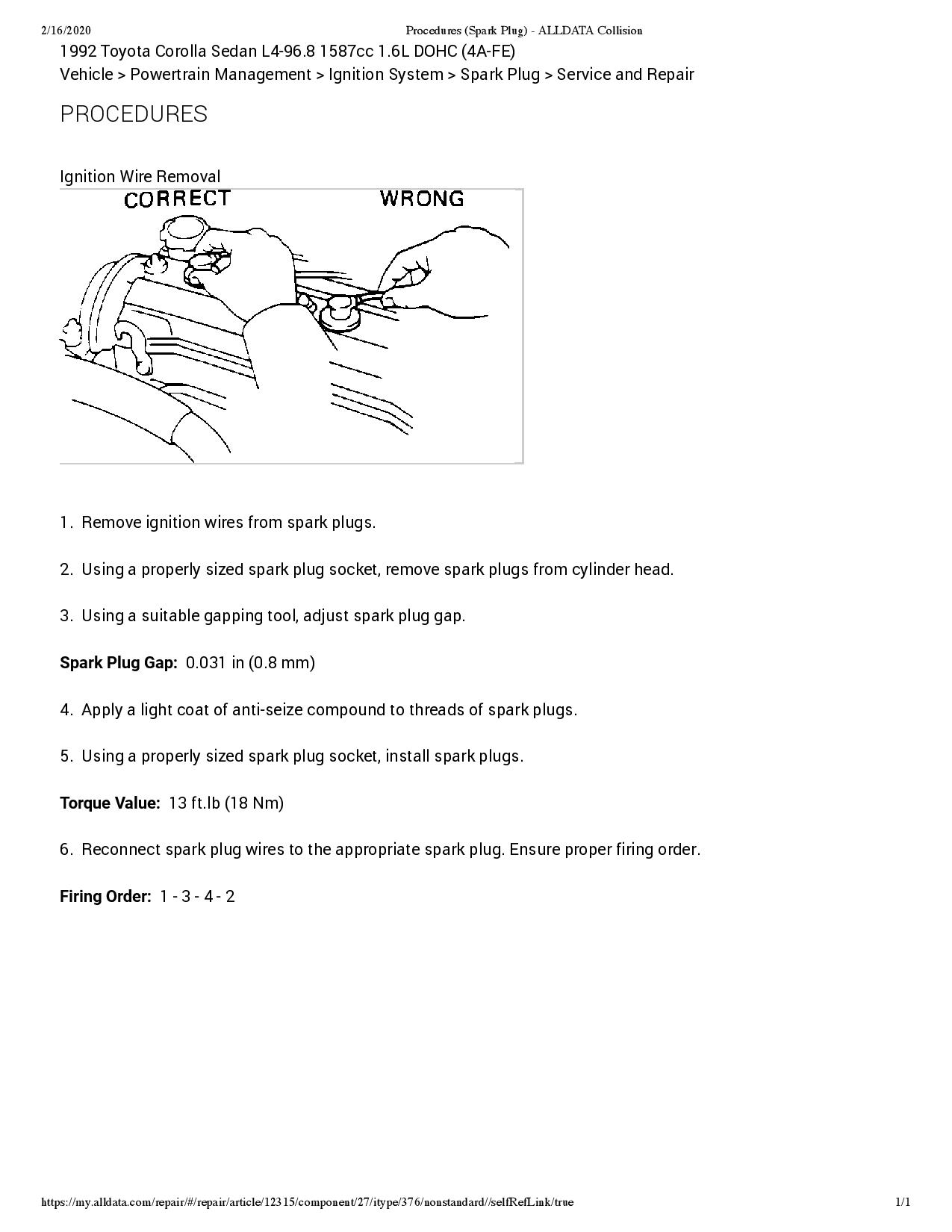

Car starts , but when I press on the gas pedal for more speed car engine shuts off. Why ?
Feb 15, 2020 at 5:46 AM
JOETECHPRO
  • 705 POSTS
Hey JOH,
The first things to check in this instance would be the spark plug condition and gaps.
Have the spark plugs been replaced recently?
I have attached instructions below on how to remove the spark plugs and it also shows specs for the gaps.
If not recently replaced i would advise starting by changing out the old spark plugs.

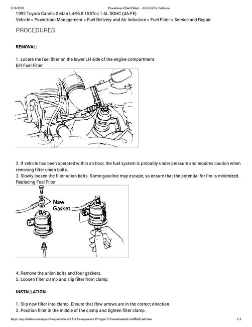

The next items to check will be the air filter and fuel filter.

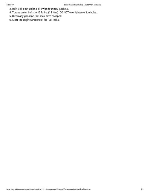

I have attached the procedure for replacing the fuel filter, if this has not been recently replaced please also replace this and retest.

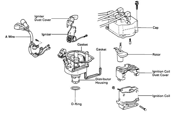

I would also replace the ignition wires, distributor cap and rotor if not recently replaced also.

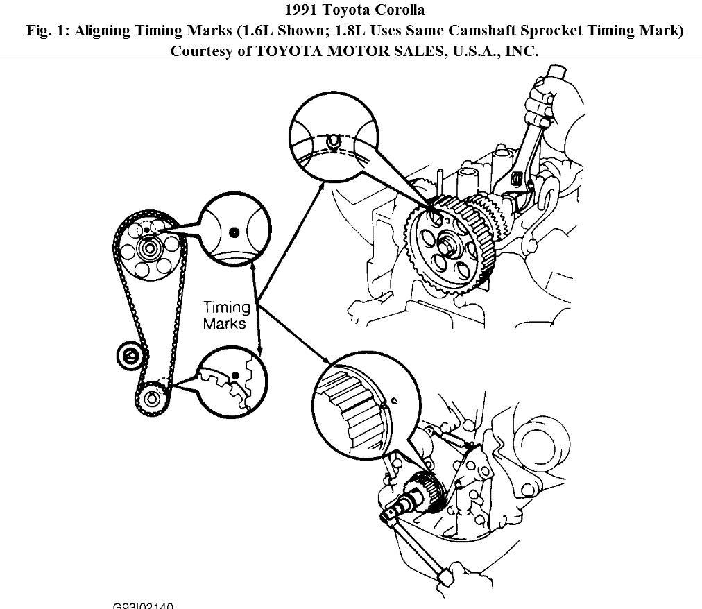

To: KHLow2008,
I check on the link you gave/type to me & it was legit to check it & experience it out. Also, when I totally took out the timing cover & check the top crank wheel above it didn't move nor rotate when I crank it to see movement? What do I do now? Do I open also to check the lower level of the belt below to see it the timing belt is warp out? & may I kindly know how to do the (TDC) for My Vehicle? Thank you...
Jan 21, 2021 at 6:52 AM (Merged)
KHLOW2008
  • 41,812 POSTS
When the top do not move while the crankshaft is being turned, the timing belt is bad. Push at the belt to check for deflection and if it has a lot of slack, the belt has stripped a few tooth.
You would need to remove the crank pulley and lower cover to replace the belt.
Diagram shows the timing marks.

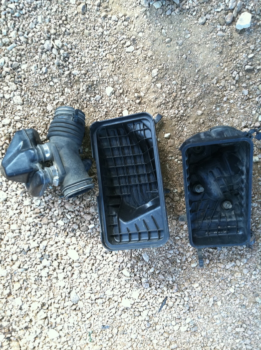

JASONZAIDA
I have taken the airbox and tube off and there is no air flow meter, is it between the box and the intake.
  • 75,988 POSTS
Its on the air intake
JASONZAIDA
This is the air intake, no meter.
MMPRINCE4000
  • 8,548 POSTS
It has a MAP sensor on rear of intake. Check the vacuum line to it, if leaking it will cause the problems you describe.

Sounds more like the ignitor in the distributor. When this happens again, spray some starting fluid in the intake, if it runs a few seconds, it is fuel related, if not it is ignitor, coil.
