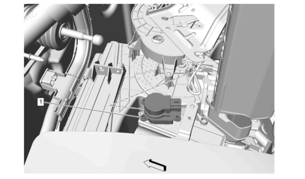

The air conditioning blows much warmer on the drivers side. I took it to the dealer and they stated it was blowing cold on both sides. The problem doesn’t occur all of the time and is less pronounced on cooler days. I am suspecting a blend door actuator issue. While there is plenty online regarding the older Acadia, there is nothing regarding the new model. Anyone have any ideas or know where the actuators are located?

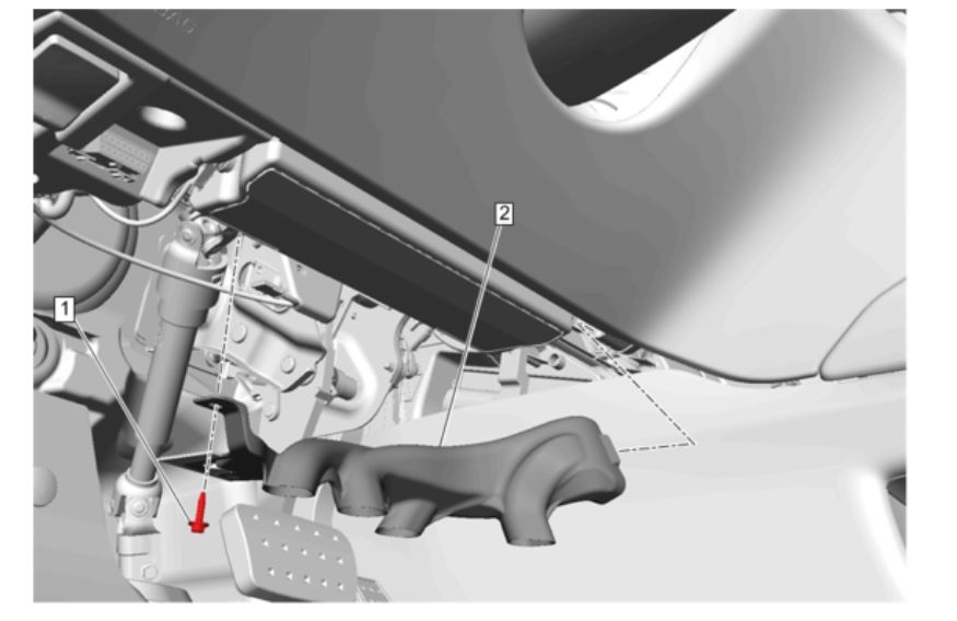

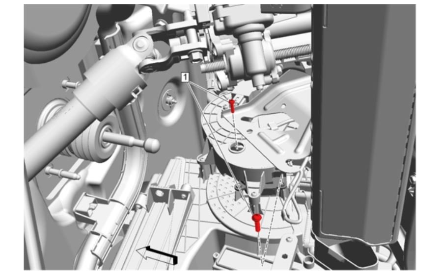

Good evening,
I received an email but there was no response. Obviously I can see your latest response with the pictures which is appreciated.
Jun 5, 2019 at 10:17 AM
Good. I wanted to be sure you got the information. It is under the left side of the dash.
Jun 5, 2019 at 10:25 AM
DANIEL SCHAFFENER
  • 7 POSTS
Thanks. I’ll see what I can figure out. I’m guessing what the issue is but it sounds like that’s the issue.
Jun 5, 2019 at 10:52 AM
I agree. Very common issue.
Jun 5, 2019 at 10:59 AM
DANIEL SCHAFFENER
  • 7 POSTS
I was able to find it. It’s not exactly in an easy to work area. I was able to watch it while I changed the temperature and I can see it operating. The door moves as I change the temperature and I can see the actuator move. The temperature on the drivers side is still significantly warmer than the passenger side. It’s cool but not cold like the other side. If it’s moving when I change the temperature I am thinking this may not be the issue. Even if it is I don’t think I can get my arms in there to remove the screws. There is literally no room. Any other ideas what might cause a temperature difference side to side?
