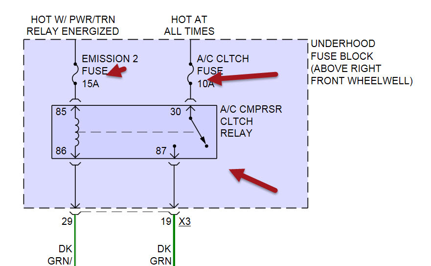

Does it have a fuse if so where is it located
Tuesday, June 2nd, 2015 AT 3:34 PM
HMAC300
MECHANIC
48,601 POSTS
Check hvac fuse inside car fuse box and blower fuse under hood as well as fuses and relay in pic under hood
