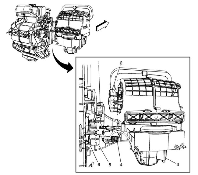

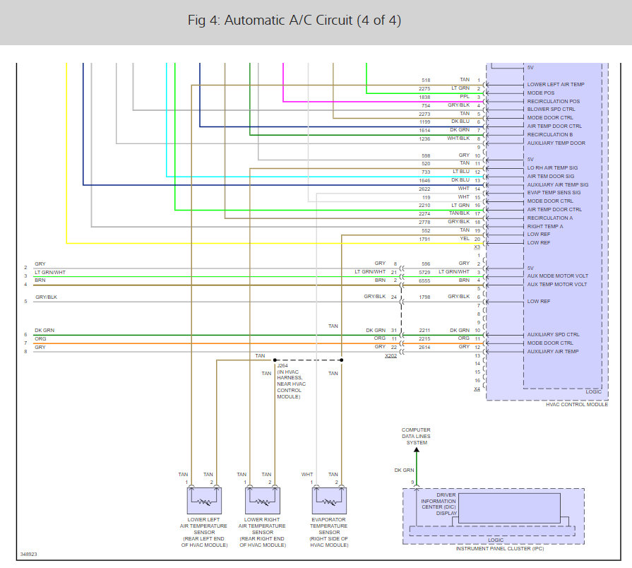

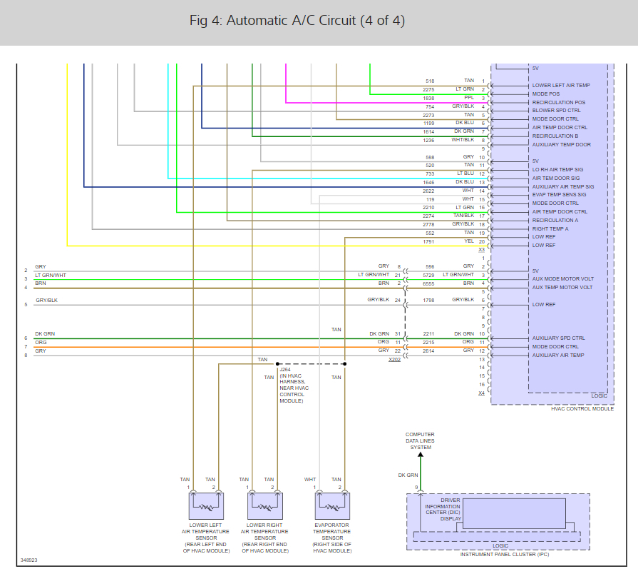

Air is blowing from all vents except the ones in the front. Nothing is coming from them at all.
May 30, 2017 at 12:04 AM
  • 55,447 POSTS

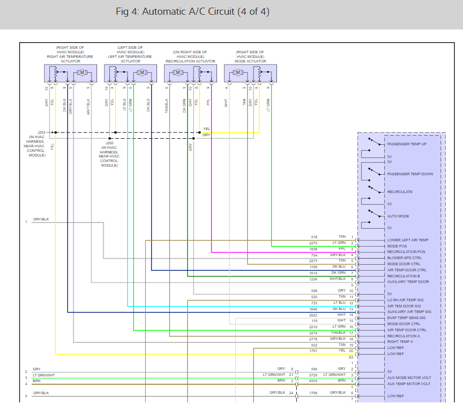

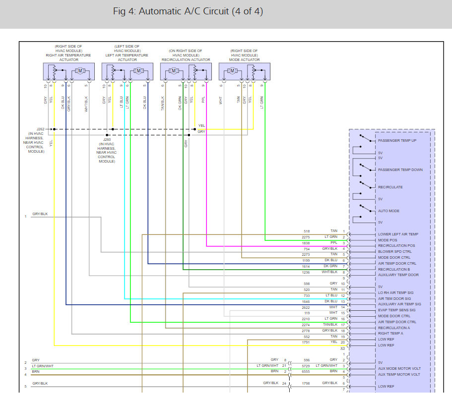

It sounds like you have a blend door actuator that has failed which is common on these cars. Here is a diagram (below) and a guide to help you get the problem fixed:
1 - Mode Actuator
2 - Recirculation Actuator
3 - Blower Motor
4 - Blower Motor Control Module
5 - Air Temperature Actuator
6 - Evaporator Temperature Sensor

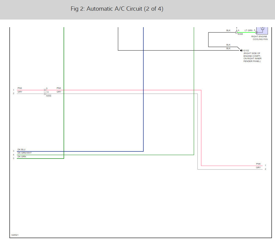

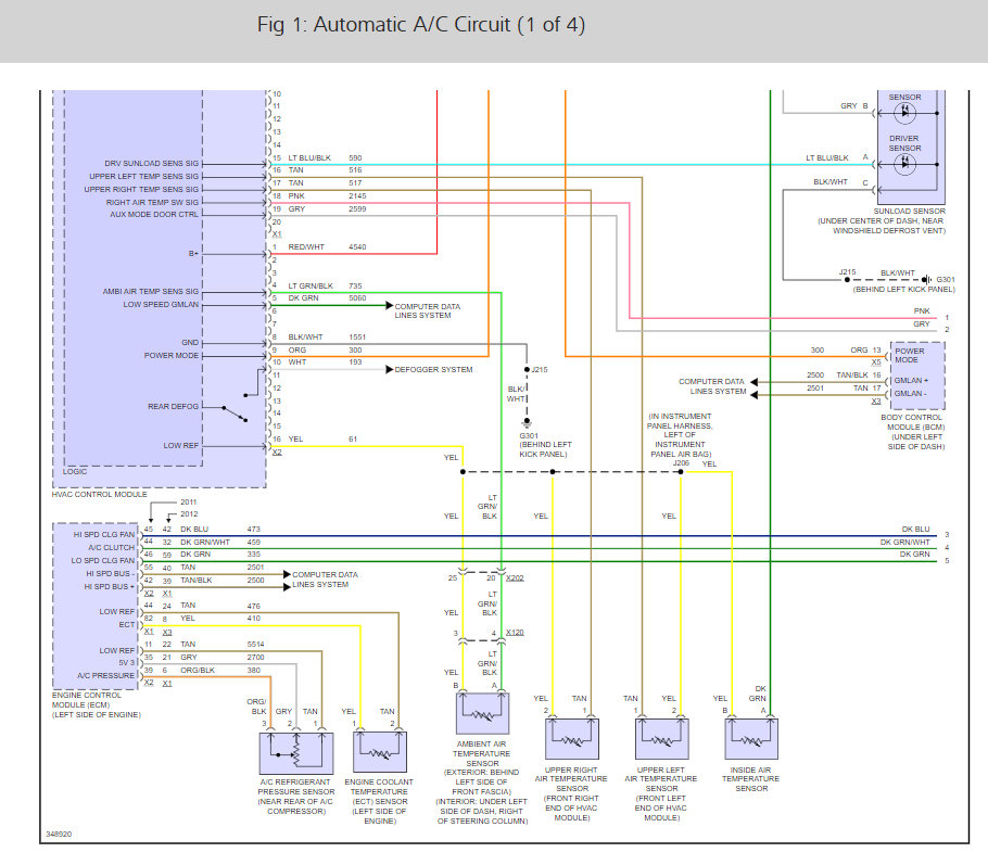

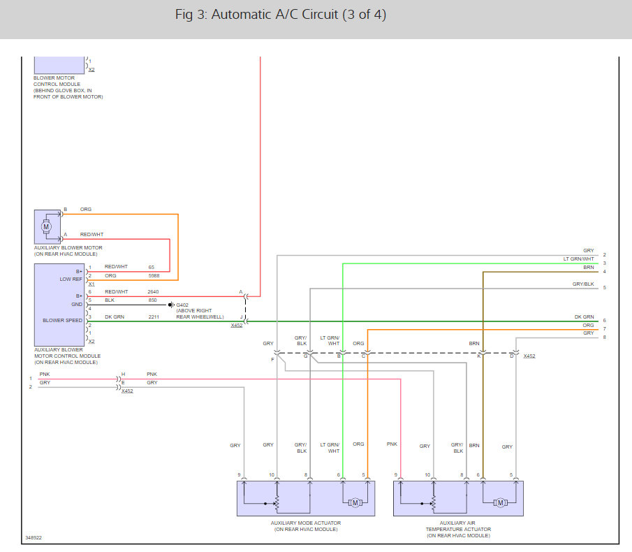

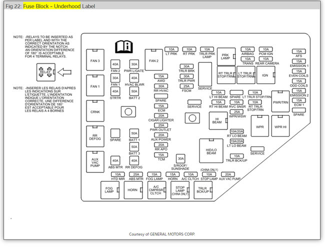

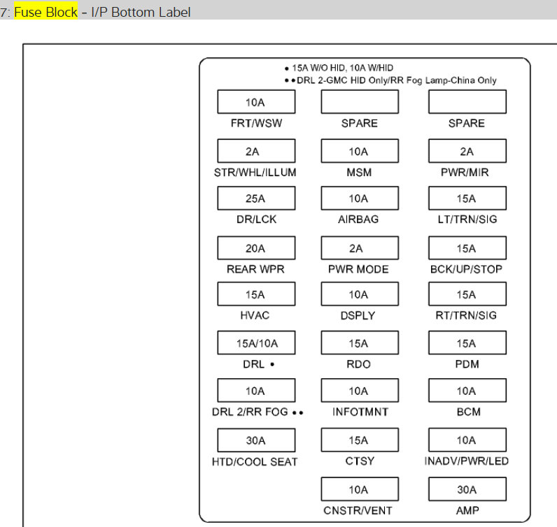

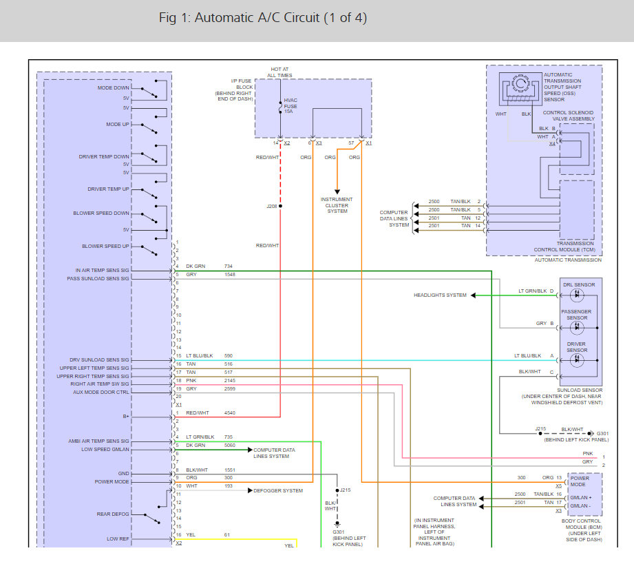

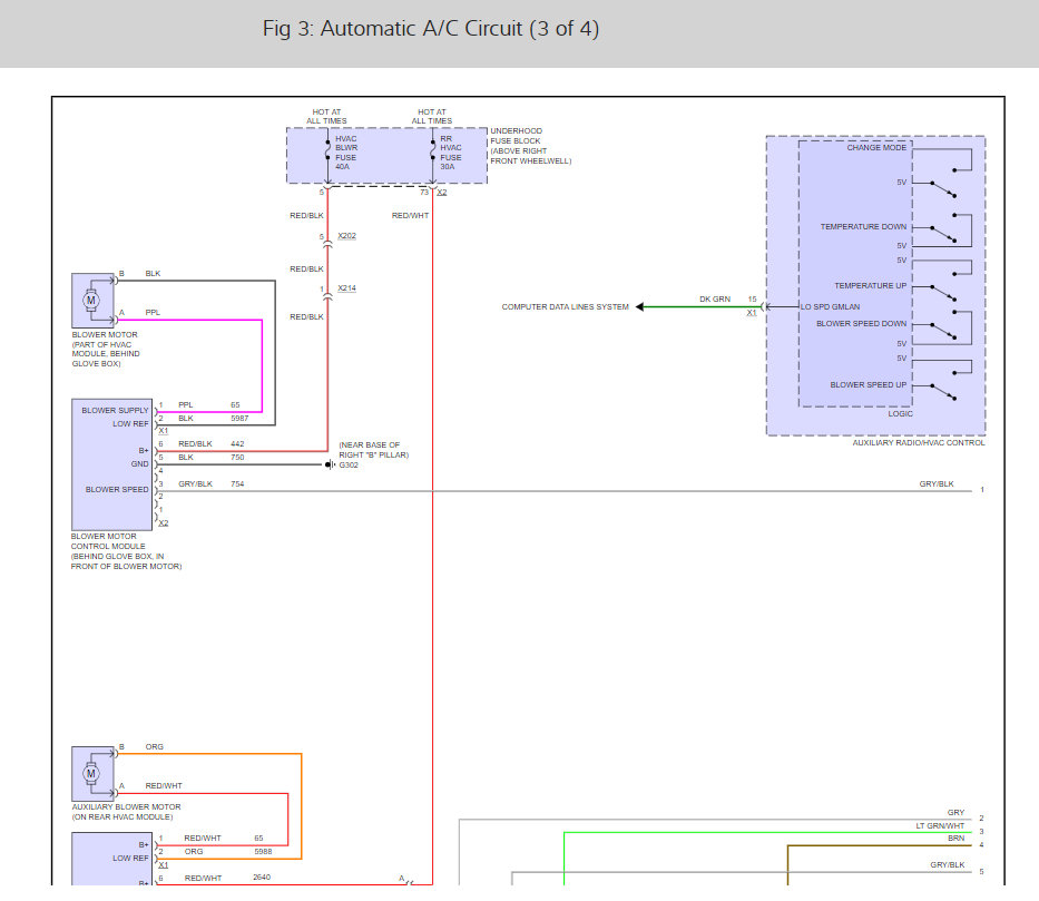

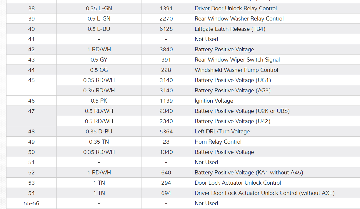

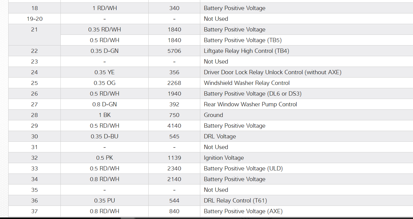

My rear blows fine but the front does nothing. I checked both actuators are working and the fuse is fine. I tried resetting the HVAC/ECAS by disconnected the battery but no change. Any other ideas would be very helpful. Thank you
Sep 9, 2018 at 5:55 AM
  • 55,447 POSTS

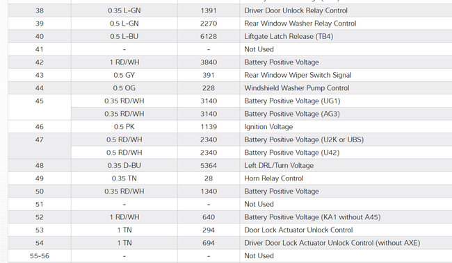

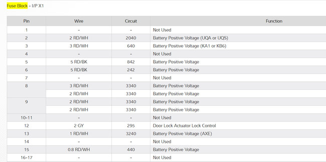

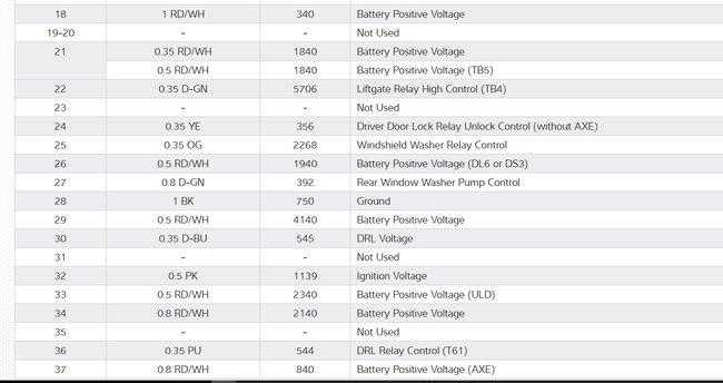

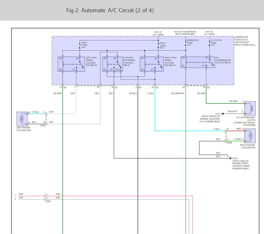

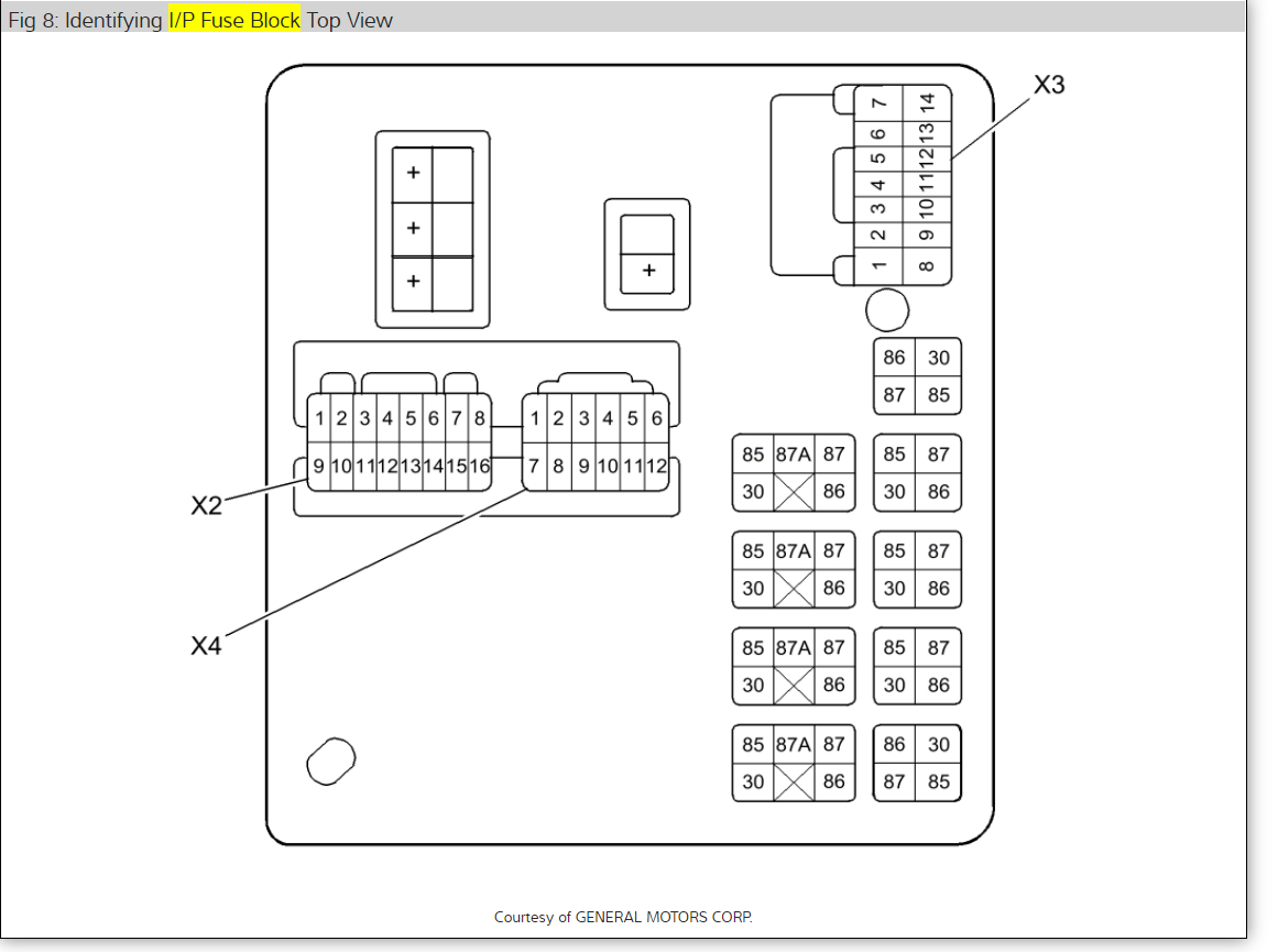

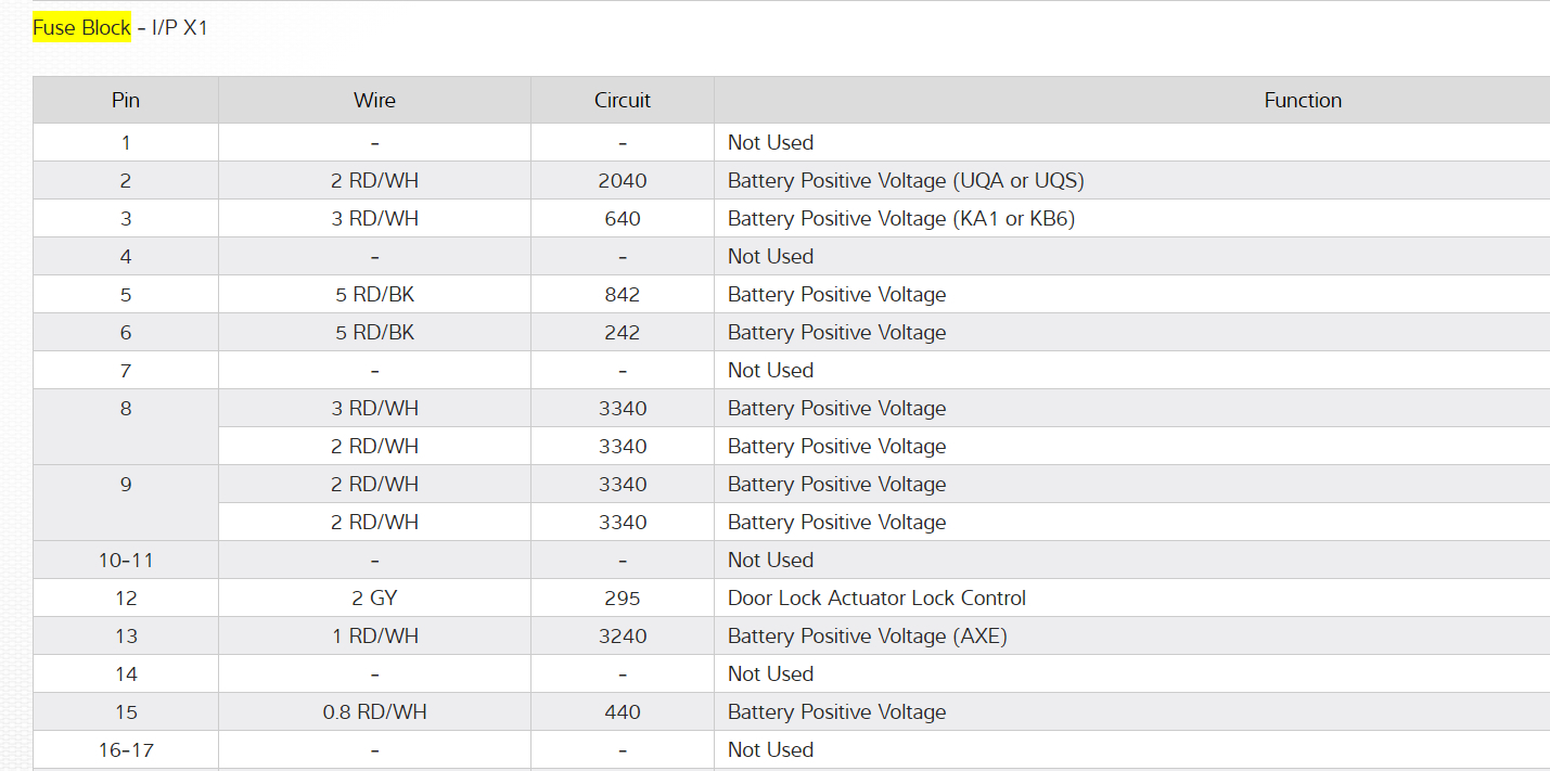

There is an HVAC blower fuse that need to be checked for power, if that is good lets check the blower motor for power and ground. Here is a guide that will help also here are the blower motor and AC wiring diagrams so you can see how the system works and the fuse locations below:
https://www.2carpros.com/articles/blower-fan-motor-works-on-high-speed-only
and
Check out the diagrams (below). Please run this test and get back to us.
