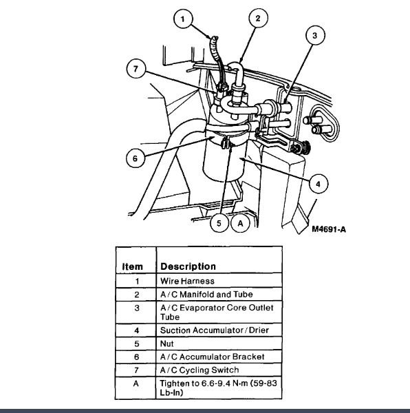

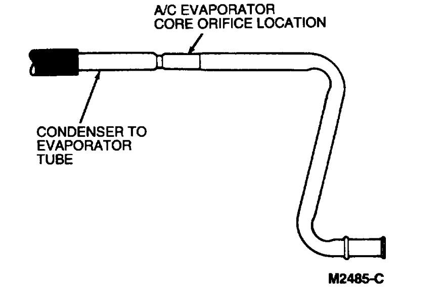

The low side is the issue. 22 is too low. It should be 25-30 rock solid.
I would replace the expansion valve and the dryer and then evacuate for 1 hour and charge the exact amount of Freon needed.
It takes 34 ounces.
Jun 22, 2020 at 2:10 AM
BANJOBOB1200
  • 23 POSTS
Okay. Why, when it stopped cycling did the low go up to 29 and the hi go to 325? Also, the expansion valve is the orifice tube isn't it?
Jun 22, 2020 at 2:46 AM
That is correct. It is part of that line. Any parts store should carry that line.

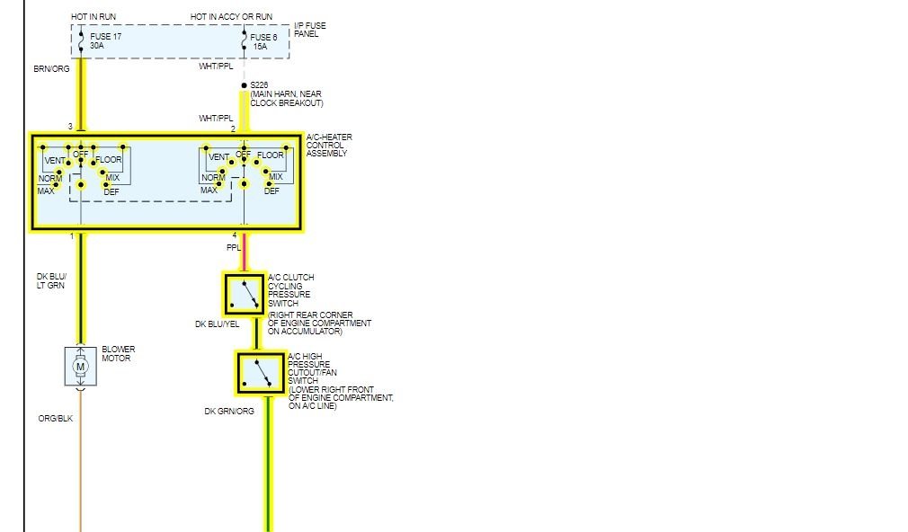

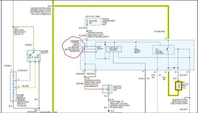

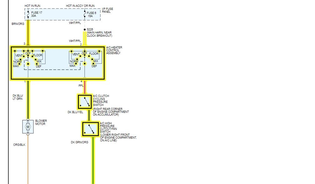

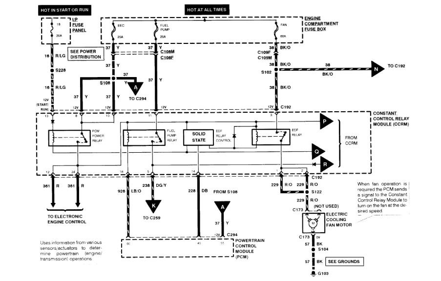

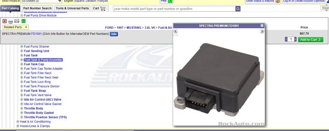

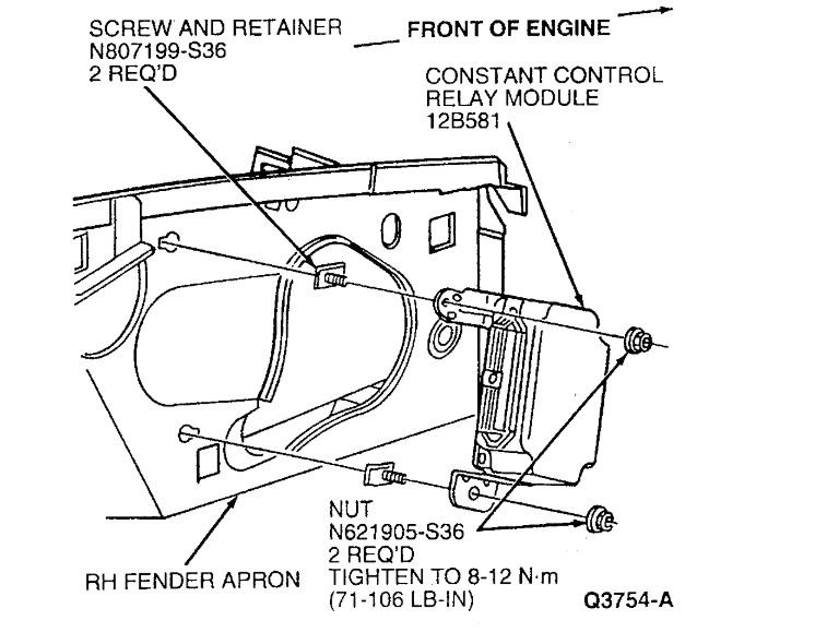

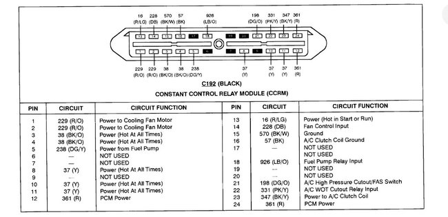

Replaced the suction line and dryer. Vacuum held over an hour, recharged with correct amount and now blows cold air and compressor cycles. However my fan (radiator fan) won't come on. Followed test procedure from my.streetonline and it points to CCRM. Ect working, fan works when jumped, voltage into CCRM, no voltage at fan and no voltage from CCRM. I appear to have a re-manufactured CCRM and the part number label is missing. Can I get a correct pn by using my vin? Thanks again for all your help.
Jul 28, 2020 at 1:14 AM
Okay, first, what is the high side pressure? The fan will not come on until there is at least 150-200 pounds.
Can I have the VIN number?
I attached the connector and the wiring diagram for you. Verify all powers to the unit before replacing.
Jul 28, 2020 at 5:52 AM
BANJOBOB1200
  • 23 POSTS
Hey Tom, the vin is: 1FALP4047VF109858.
I will get the high side pressure and check those powers to the unit tomorrow. I'm done for the day. Thanks.
Jul 28, 2020 at 8:20 AM
Okay, I attached the part. Rock auto has it in stock.
