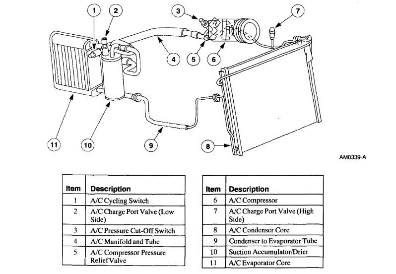

Okay, I got this truck two weeks ago. Truck has not been started or moved in ten years. I got the truck running and believe it or not everything is working except for the A/C. I put my gauge on the system and tried to pull a vacuum. It will pull down to -28 but can't hold it. So there is a leak. My question is, is the compressor most likely the cause of the leak or should I just get a kit to replace the compressor, filter dryer and o-rings? Any help would be appreciated.

You need to find the leak before throwing parts at it. I attached a diagram of the system and the leak could be anywhere in that system.

Good morning Roy, I added one can of 134a. Would only take half of a can with a vacuum pulled. Bypassed the compressor and ran it to pull the rest of the can. While the compressor was running with one can installed, the high side was running around 150psi and the low was at 0psi. The 134a can was completely frosted. Stopped the engine and began using my refrigerant sniffer. I noticed the compressor had a small leak at the middle were they are joined together and two other spots were there are o-rings. Will be ordering the compressor, filter dryer, o-ring set and new orifice . My questions are as follows. 1. Truck will be used on my RV park and won't be used on the public roads, which color orifice should I use? 2. Is there anything else I should order to replace? 3. Was the zero pressure normal for only one can into the system or what else beside change out the above do I need to due? Thanks in advance, Jeff

Okay, 1. I would replace it with what the factory called for. That is how the low side is controlled.
2. Make sure you get some Pag 90 oil. You will need to add 2 ounces into the dryer before installing.
3.No, That is a bad orifice tube.

Roy, just a update. Installed the compressor and filter dryer, replaced all o-rings, added the oil and pulled a vacuum, let it under a vacuum overnight with no loss of any vacuum and recharged with 30oz and A/C is working perfectly. Thanks for your advice.
