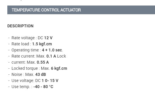

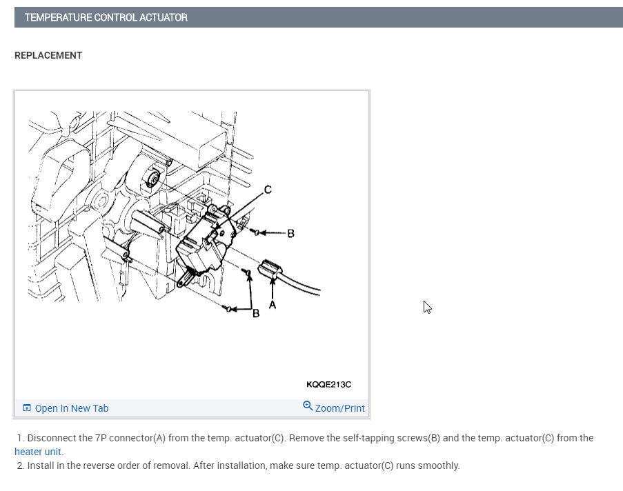

The truck blows air in all vents. But the heat is cold and the A/C blows hot. Both went out at the same time. Is it the blend door actuator that's causing this? Thanks
Friday, January 22nd, 2021 AT 12:47 PM (Merged)
More than likely that is the issue. I would suggest getting access to it and make sure it is turning the correct direction. A lot of times these gears strip out and they are moving but not to the correct location which doesn't give you the proper temperature.
Let me know if you have questions but I would replace this and then retest.
