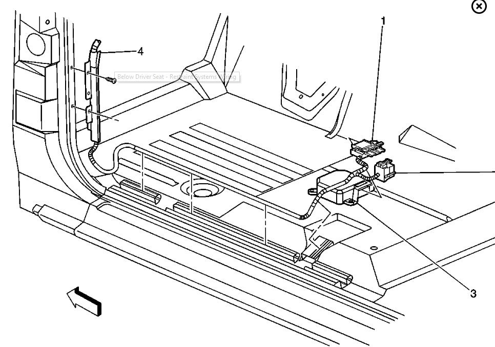

This problem has to do with the airbag module having a problem. Many of our members have replaced the sensor but it made no difference.
Here is a video to help
https://youtu.be/gnSGfEqrf_w
Here is its location (below).
PS. they get damaged when they get wet. :)
+2

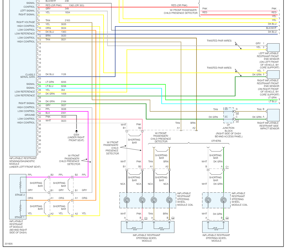

GBEACH804

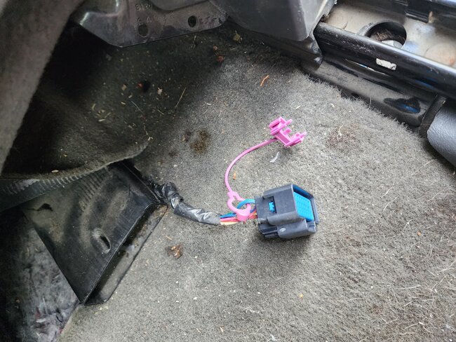

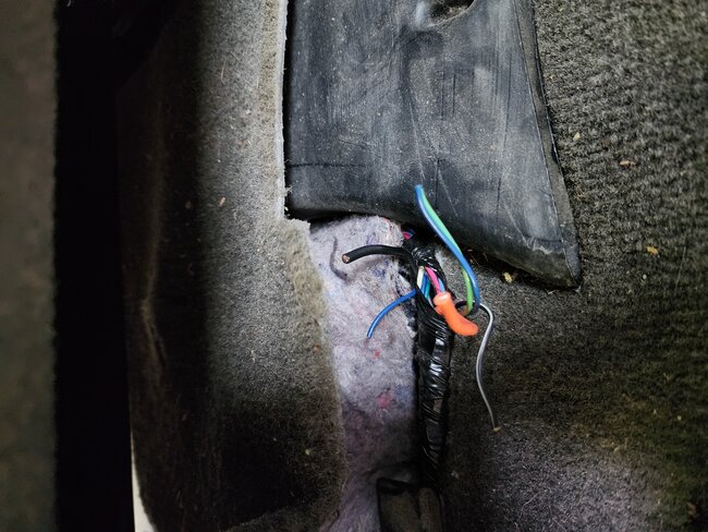

Bought a 2006 Silverado 1500 Z71, the previous owner swapped the front seats and apparently cut the wiring harness. Now I have an airbag light and multiple codes.
Tuesday, June 13th, 2023 AT 4:55 PM
KEN L
  • MASTER CERTIFIED MECHANIC
  • 48,363 POSTS

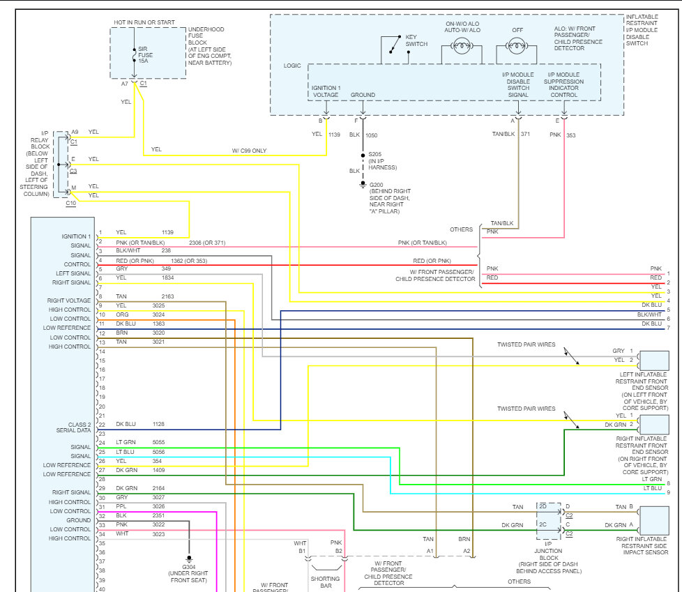

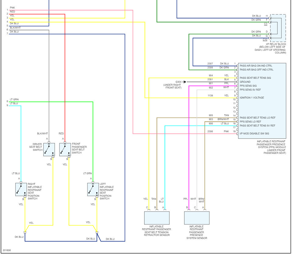

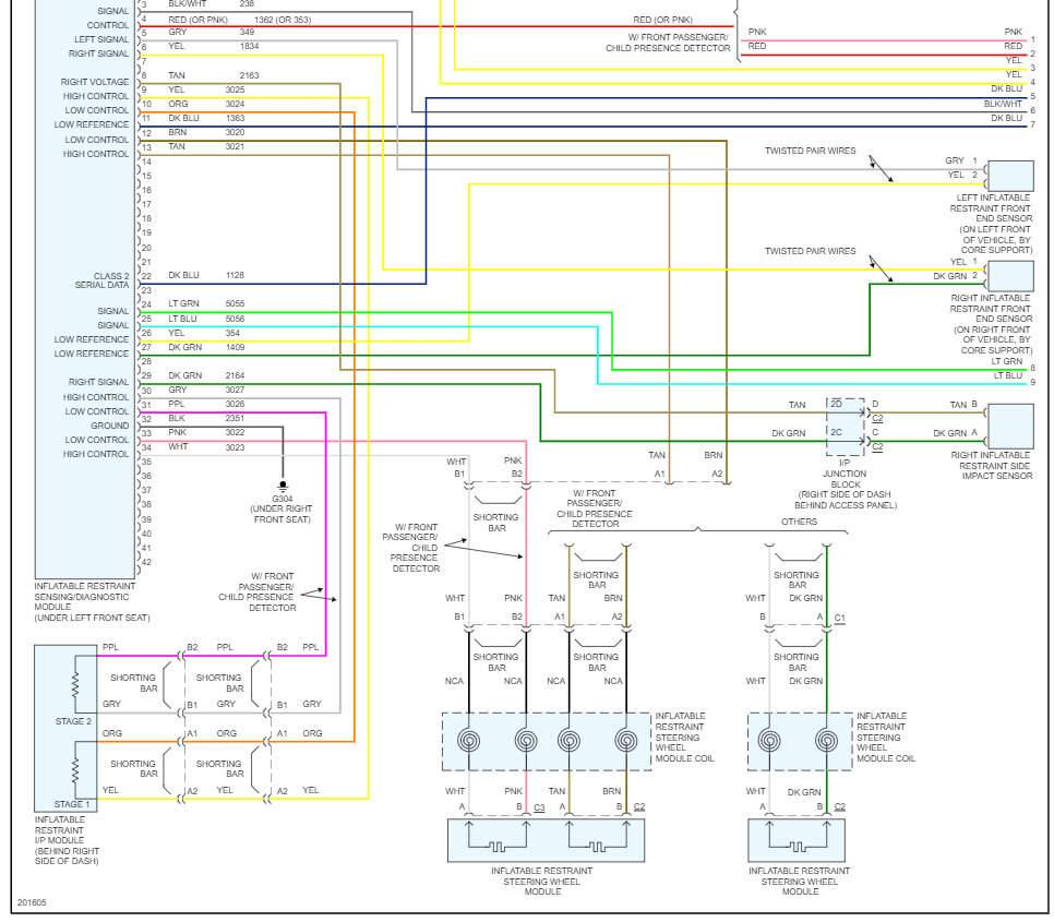

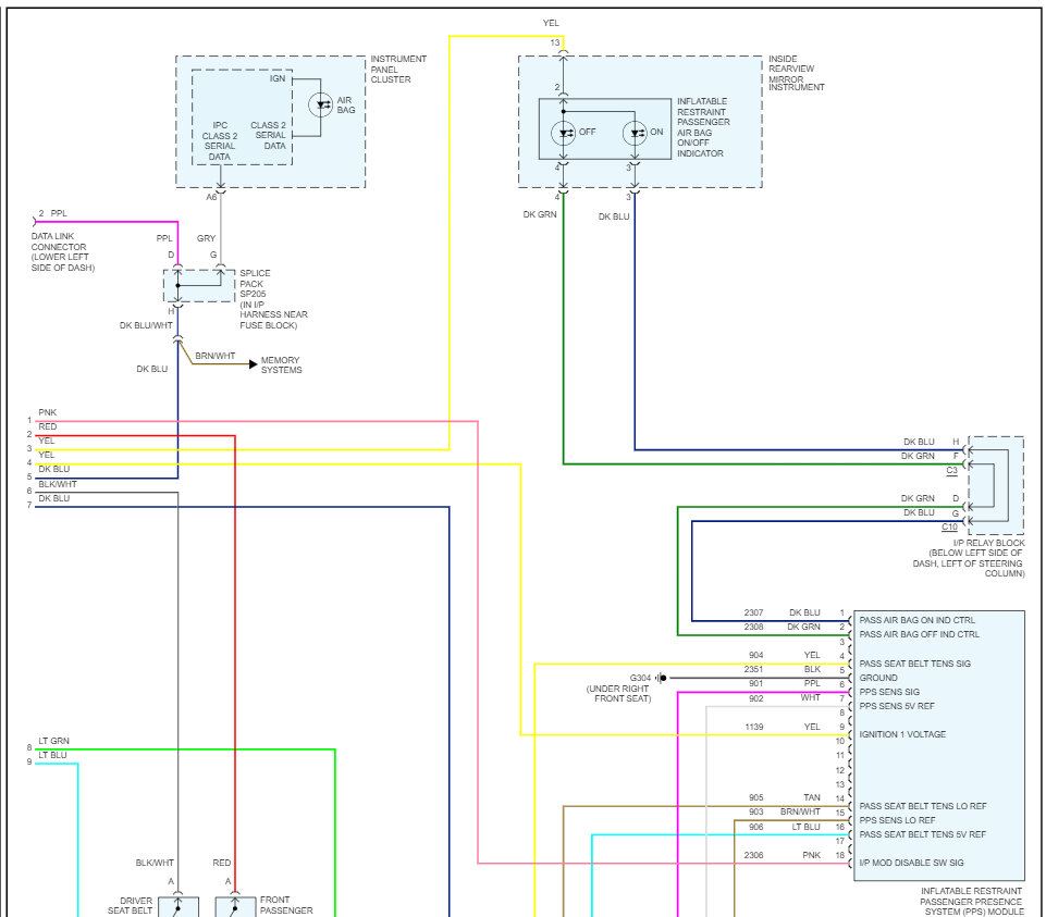

Yep, the wires will need to be repaired. Here are the wiring diagrams so you can see how the system works and which wires go where in case you need it. This guide may help as well
Once the wiring is fixed, please post the airbag system trouble codes. Check out the images (below). Please let us know if you need anything else to get the problem fixed.
