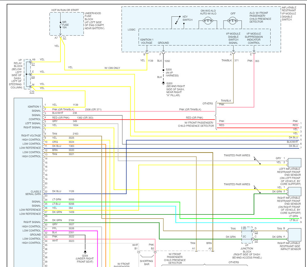

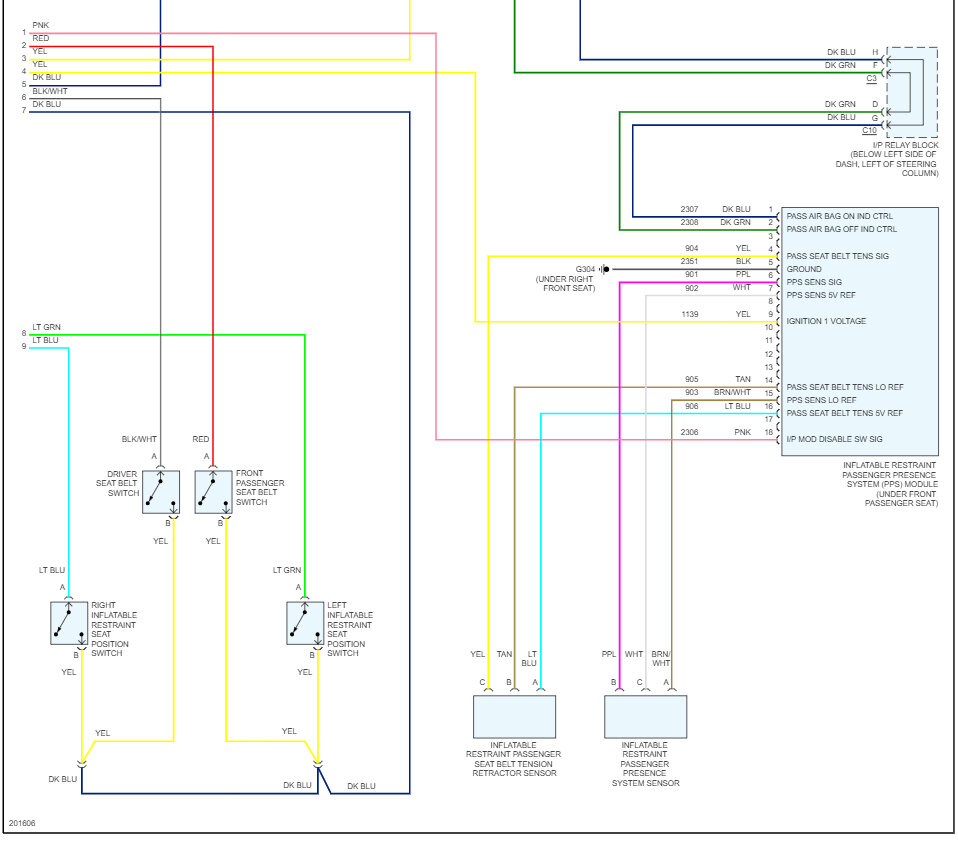

SIGNMAN1959

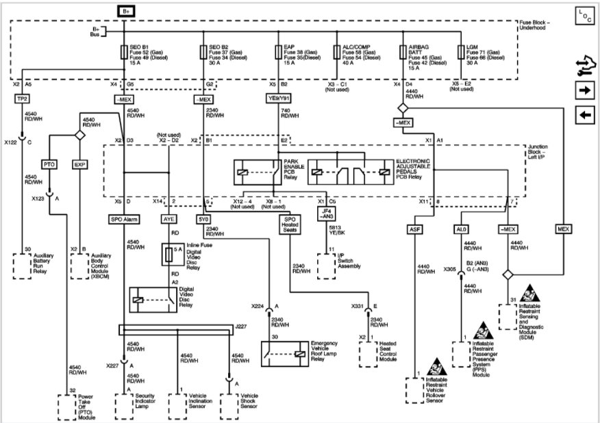

How many wires does the drivers seat airbag sensor have hooked to it? The plug has 2 wires on it but the wire coming out of the harness only has on that I can find.
Jan 26, 2021 at 10:34 AM (Merged)
I am attaching the wiring diagram of the system which should help. Can you get a picture of the connector that you are seeing that has two wires? The diagram shows there is one wire coming from the sensor so I am going to need to see the other to try an identify it. I suspect we have a different connector and think it is the inflation circuit.
Take a look at the diagram below and we can go from there. Thanks

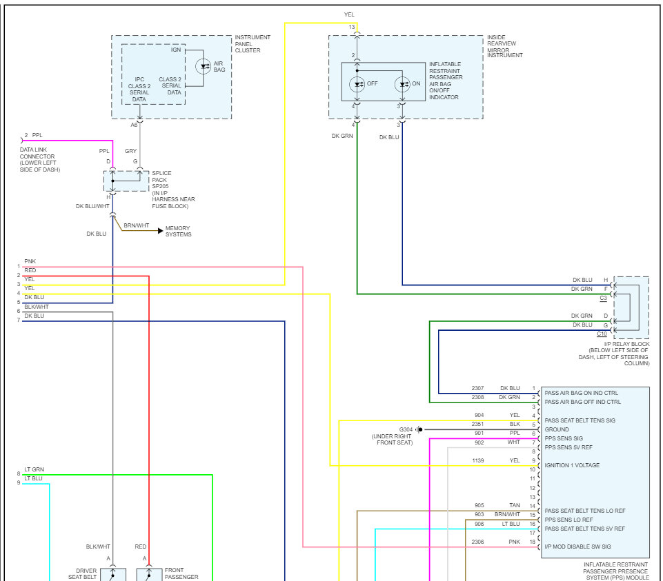

DODENDAWN
The passenger service air bag light came on in my truck about 8 months ago, is there a way to test and reset without going to a dealer or other shop to fix this.
Jan 26, 2021 at 10:36 AM (Merged)
no, this system is very complex and you looking at the components can set off an air bag.
you need to have the code pulled, repairs made and then the light will re set itself.

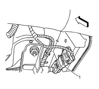

DENNYP
  • 1,824 POSTS
DTC B0092 Set (Repair Passenger Presence System (PPS) Sensor Harness) Subject: Air Bag Lamp On, Passenger Air Bag Indicator Always Reads OFF, DTC B0092 Set (Repair Passenger Presence System (PPS) Sensor Harness) Condition: Some customers may comment that the Air Bag Lamp is on and the Passenger Air Bag indicator always reads OFF. Upon investigation, the technician may find DTC B0092 set. Cause: The cause of this condition may be a shorted Passenger Presence System (PPS) sensor wire. The PPS sensor harness is located under the front passenger seat. This harness may be pinched between the seat frame and the track/riser. Correction: Locate the PPS sensor (1) and inspect the harness for proper routing. If the harness is pinched between the seat frame and the track/riser, use the procedure listed below to repair wire(s). Move the front passenger seat to the full rearward and full tilt up position. Loosen the seat frame to track/riser nut and remove the harness. Tighten the seat frame to track/riser nut.
https://images.2carpros.com/forum/automotive_pictures/102900_912514_1.jpg
Hope this helps.
Jan 26, 2021 at 10:37 AM (Merged)

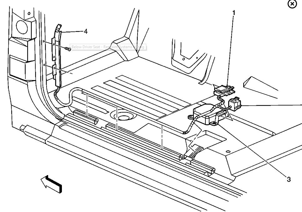

  • 55,224 POSTS
This problem has to do with the airbag module having a problem. Many of our members have replaced the sensor but it made no difference.
Here is a video to help
https://youtu.be/gnSGfEqrf_w
Here is its location (below).
PS. they get damaged when they get wet. :)

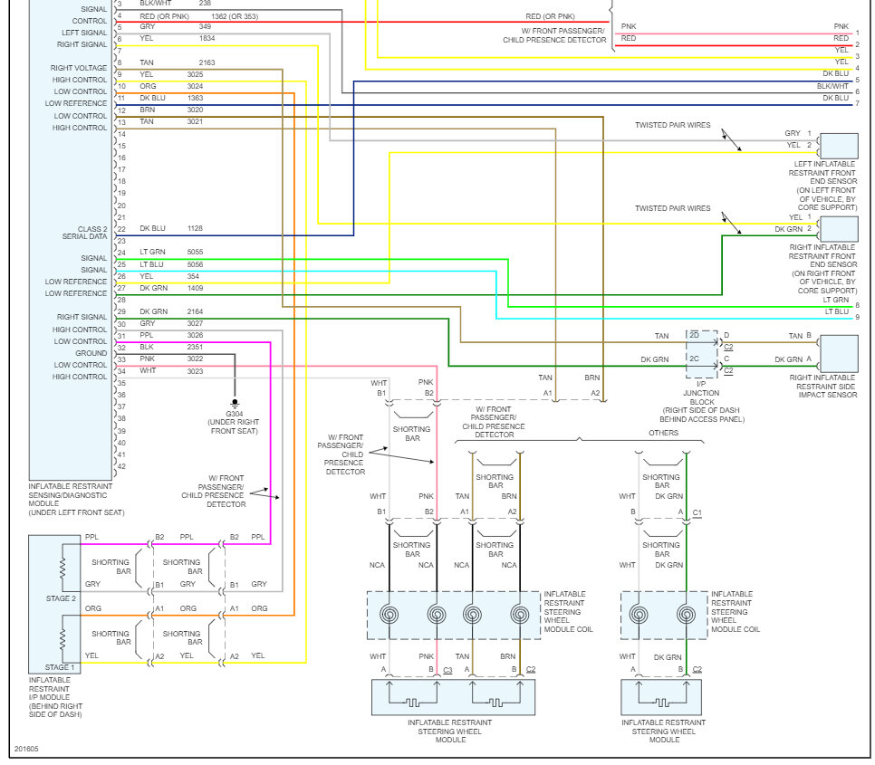

CHRISH94
I have the truck listed above that has an airbag light that has stayed on. The code is B0084 and I have changed the front impact sensor. The old one did not seem to have any damage. Changing the sensor did not fix the issue.
I then detached the passenger seat to inspect the cables underneath. Every cable was connected and the cables were not broken, but encased in a black tube wrapped in electrical tape.
Does any one have any suggestions to address this? Truck w ill not pass smog test with air bag light on.
Thanks in advance.
Jan 26, 2021 at 10:39 AM (Merged)
MHPAUTOS
  • 31,937 POSTS
do a continuity test down the yellow wire, have it unplugged and battery disconnected, let the car sit for a few min so the capacitor can discharge. do not apply any voltage, just do a continuity test to look for a broken wire or faulty soldered joint at a socket pin.

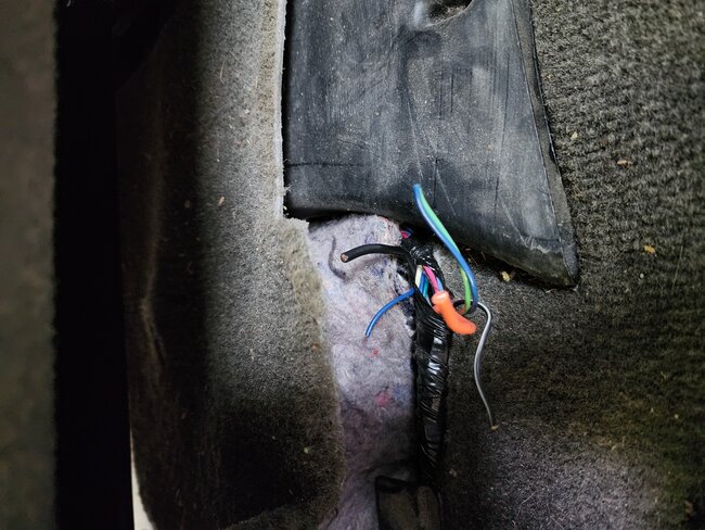

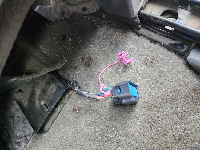

Bought a 2006 Silverado 1500 Z71, the previous owner swapped the front seats and apparently cut the wiring harness. Now I have an airbag light and multiple codes.
Jun 13, 2023 at 9:55 AM
  • 55,224 POSTS
Yep, the wires will need to be repaired. Here are the wiring diagrams so you can see how the system works and which wires go where in case you need it. This guide may help as well
Once the wiring is fixed, please post the airbag system trouble codes. Check out the images (below). Please let us know if you need anything else to get the problem fixed.
