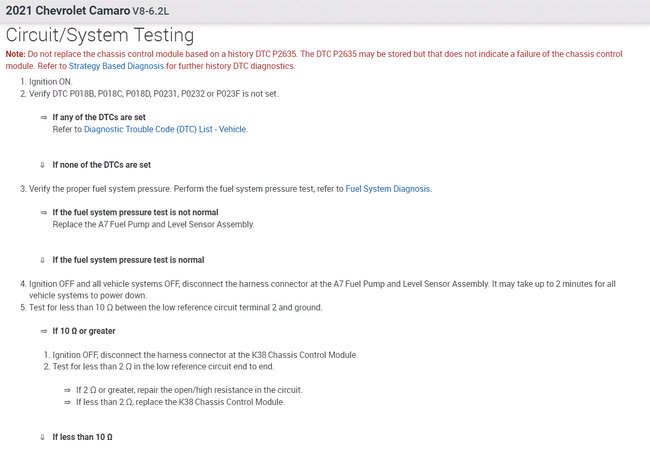

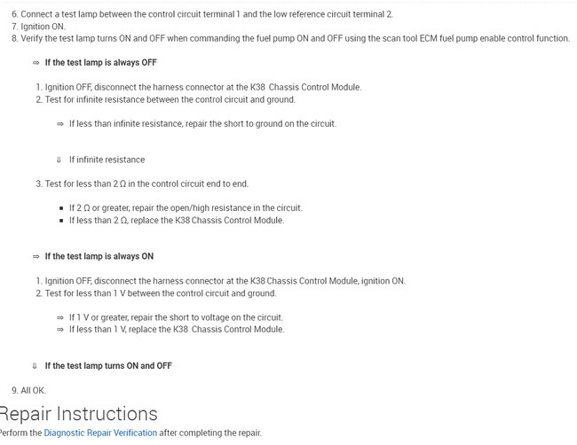

original code was p2635 Chevrolet diagnostic was a short in fuel pressure sensor, they replaced fuel line and sensor. i used my neighbors obd2 showing same code p2635.
Jun 17, 2022 at 3:07 PM
  • 110,248 POSTS
With your neighbor's scanner, clear the code and see if it returns. If it does, then the manufacturer is responsible for repairing it. If you want, I attached the diagnostics below for this vehicle. Take a look through them and let me know if you are comfortable performing them. Also, be careful because a dealership may give you a hard time if something fails. If they know you worked on it, they could decline a repair.

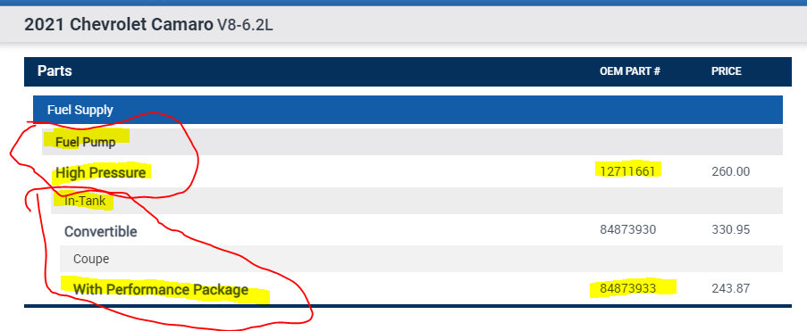

it is going on 3 weeks now still waiting at the dealer for a fuel pump for the car called GM/Chevrolet directly. They can't tell me why this is taking so long. Do you possibly know where i can find fuel pump part number? because on gm parts page they have like 2 of them both can be delivered by 17th July just don't know which one i would order and bring to auto shop I'm out of patience just don't know part number. thanks, any input that would be helpful.
Jul 14, 2022 at 8:21 PM
  • 110,248 POSTS
When you spoke with customer relations, did they offer any help? If not, be firm and say you need help because the dealership isn't getting it for you.
As far as the part number, there is a high-pressure pump and a lift pump in the tank. I attached the part numbers below. One is for a convertible, so unless that is what you have, you can eliminate that one.
Let me know if that helps.

I was on phone with GM for an hour, that just kept telling me that there is a part shortage and cannot give me a time frame they can't do anything more at the moment. really frustrating, i have been calling local repair shops up on the matter as well. i have a ss convertible. question, can either one be used because the non-convertible part seems to be available to be sent to dealer? There's a dealer by me that can get this part the 1271161.
Jul 15, 2022 at 4:26 PM
  • 110,248 POSTS

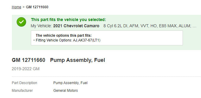

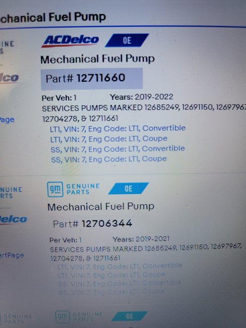

The idea that the part number is different for the convertible, I suspect the fuel tank is set up differently because it's a convertible. So, I have to say no.
As far as the part number you attached, it is for a convertible SS with the LT1 engine. Is that what you have? According to GM parts giant, it will. See pic below and confirm I put in all the correct information.
Jul 16, 2022 at 9:55 AM
ANTHONY ARENA
  • 59 POSTS
Yes, that seems correct. i called several auto places and they all will get back to me, they wanted my VIN so they can do a search. Thanks
