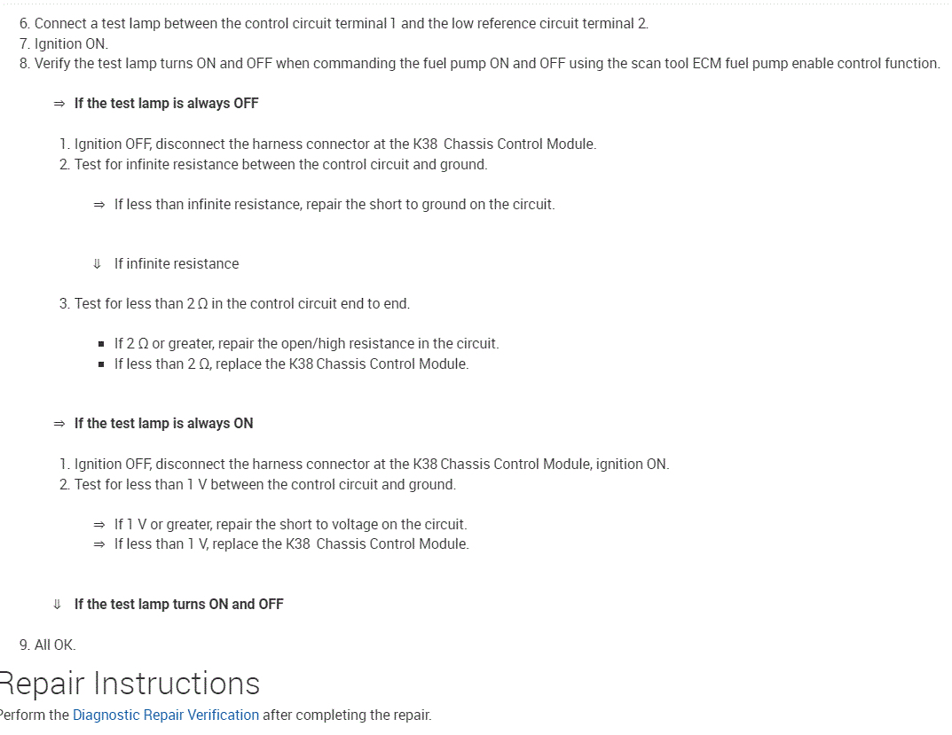

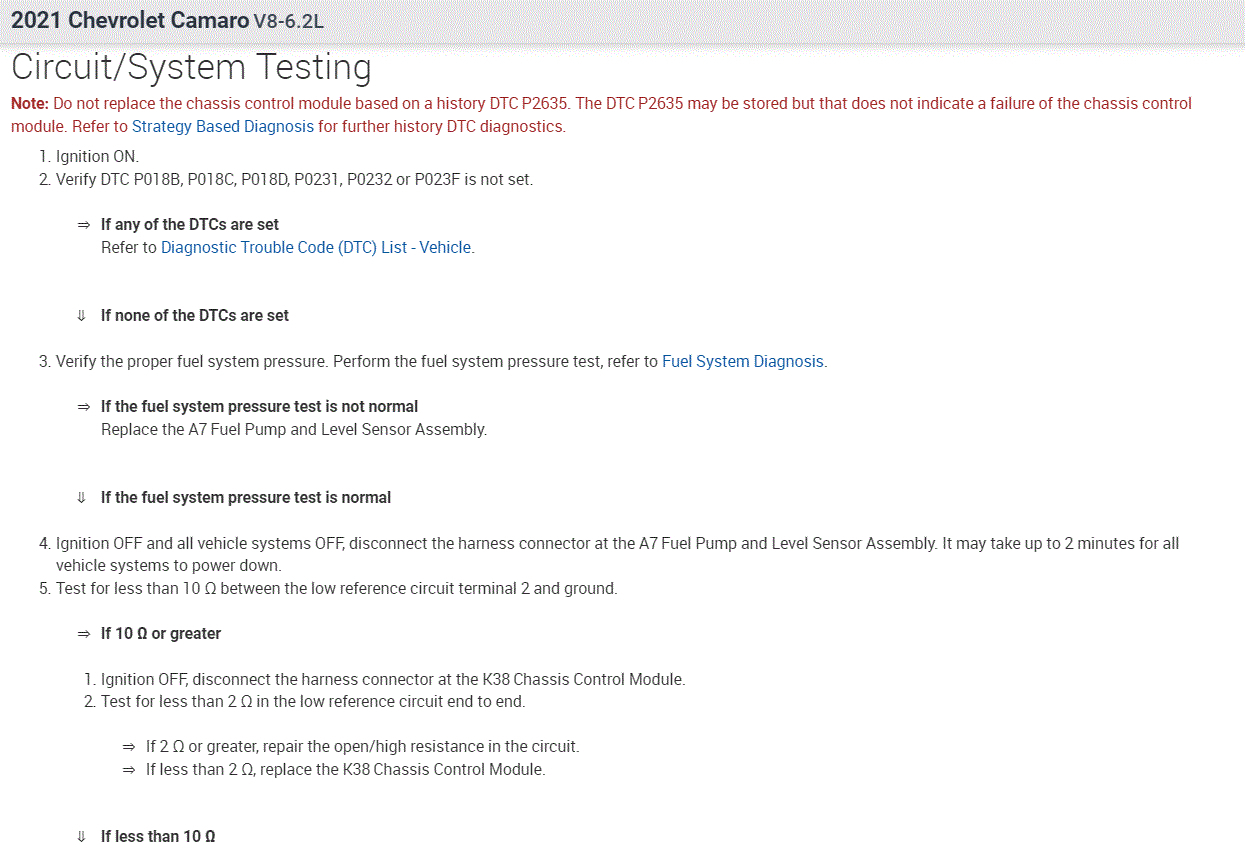

Here is what I need you to do. We need to determine if the same code has returned or if there is a new one. Here is a link that explains how it's done. However, if you take it to a parts store, most will do it free of charge.
Here is the link:
Let me know what code has set the light to turn on. Also, if you look at your receipt, it should have the original code or codes found. It should start with the letter P followed by 4 numbers.
Take care and I'll watch for your reply.

With your neighbor's scanner, clear the code and see if it returns. If it does, then the manufacturer is responsible for repairing it. If you want, I attached the diagnostics below for this vehicle. Take a look through them and let me know if you are comfortable performing them. Also, be careful because a dealership may give you a hard time if something fails. If they know you worked on it, they could decline a repair.
Let me know what you find or if you have questions.

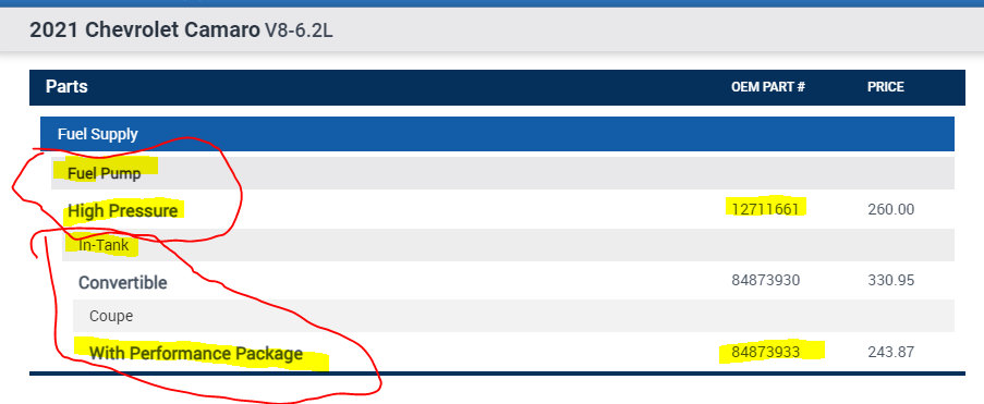

When you spoke with customer relations, did they offer any help? If not, be firm and say you need help because the dealership isn't getting it for you.
As far as the part number, there is a high-pressure pump and a lift pump in the tank. I attached the part numbers below. One is for a convertible, so unless that is what you have, you can eliminate that one.
Let me know if that helps.
joe
See pic below.

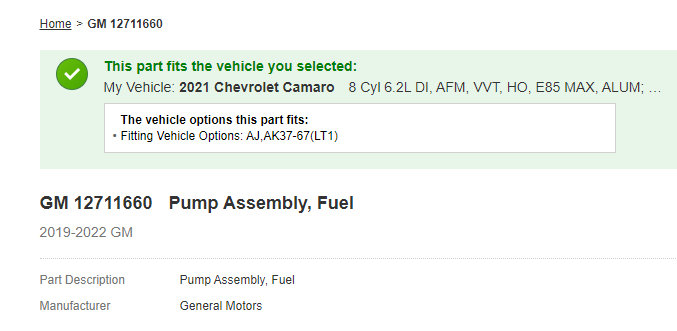

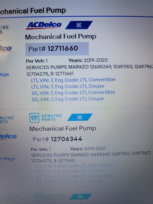

The idea that the part number is different for the convertible, I suspect the fuel tank is set up differently because it's a convertible. So, I have to say no.
As far as the part number you attached, it is for a convertible SS with the LT1 engine. Is that what you have? According to GM parts giant, it will. See pic below and confirm I put in all the correct information.

Yes, that seems correct. i called several auto places and they all will get back to me, they wanted my VIN so they can do a search. Thanks
