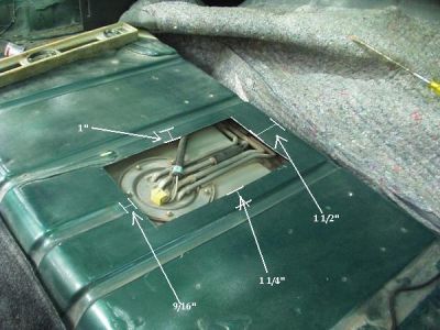

hi ive got a gas leak back buy my gas tank when the car starts it flows what should i look for

Its sounds like a hose leading off the fuel pump may have a leak in it. You should drop the gas tank or cut an access hole to the pump. If you cut the access hole, be careful not to cut into the tank or cut any lines. Heres a pic with dimensions on cutting the hole. You should be able to find the leak easily. Good luck!
