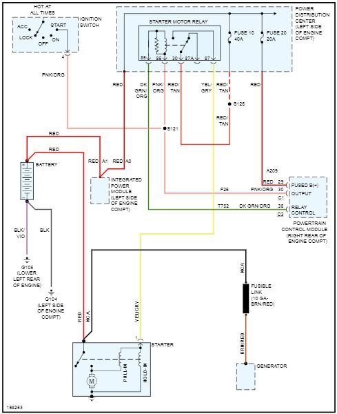

There is a fuse link in the circuit which may be the issue. Here is a diagram of the starting system. We should be able to track down the problem with it. Do you have a test light by chance?

Okay, great you have a test light. First we want to see if there is any draw at all from the starter or its relay. Put the test light across the battery terminals so its lit have two people or set it up so you can walk from it. Then go to the crank position of the key and watch to see if the light does nothing and stays lit, or if it goes out or give a slight blink. If it goes out we are going to be looking for a loose or bad connection. if it dims for a second or does nothing but stay lit then we need to test, with the light, the relay signal in and out.
Use the schematic above and the terminals we are concerned with are #86 pink and orange wire which should get hot in the crank position. If it does the ignition switch at the key is working, and if terminal #87 a yellow/grey wire gets hot then the relay is working and its sending signal to the starter. Notice the two fuses, they are the next test spot. if all these things check out its looking like a failure in the starter.

The light stays on and does nothing.
Jul 16, 2020 at 10:43 AM
CARGIRL36
  • 6 POSTS
And so far everything else is checking out too.
Jul 16, 2020 at 10:48 AM
CARGIRL36
  • 6 POSTS
also i can hear the click of the solenoid engaging when i turn the key over.
Jul 16, 2020 at 11:15 AM
4DRTOM
  • 467 POSTS
If your hearing the starter click, it's low voltage or the starter is bad. The relay is working. So try to jump the car it might be enough to fire it and go get a starter.
