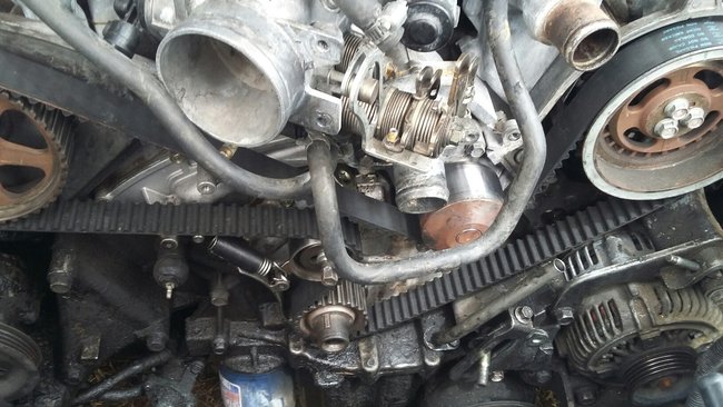

Before all the adjustments car was running fine except for occasional overheating. Adjustments weren't made until after timing belt was replaced and car would not start. Can anyone sent me a pic of timing belt setting.

Take some pictures of the belt in time and post them for me to look at.

Here is a pic
Wednesday, January 27th, 2021 AT 2:32 PM
SATURNTECH9
  • 30,869 POSTS
I see the belt but can't see the timing marks on the cams or the crank?
