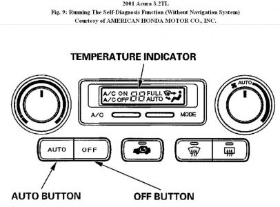

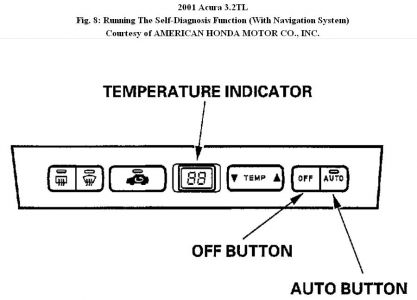

Hi Bob Kearns, System is equipped with self diagnostics. Perform the following to see if you can come up with anything. HOW TO RETRIEVE A DTC The climate control unit has a self-diagnosis function. Running the Self-diagnosis Function With Navigation System
https://images.2carpros.com/forum/automotive_pictures/192750_HVACSelfDiagnostic01TLFig08_1.jpg
Without Navigation System
https://images.2carpros.com/forum/automotive_pictures/192750_HVACSelfDiagnostic01TLFig09_1.jpg

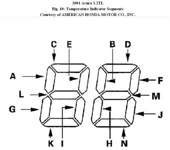

1. Turn the ignition switch ON (II). 2. Press the AUTO button and then the OFF button. Continue to hold both buttons down for 1 minute. If there is any abnormality in the system, the temperature indicator will light up the segment (A through N) corresponding to the error. The temperature indicator will then alternate every second between displaying "88" (all segments lit) and the error code segment (A through N). NOTE: The system will only display the DTC when the AUTO and OFF buttons are pressed. If you release the buttons, the display will go blank. To return the display, simply press the AUTO then the OFF buttons again. To determine the meaning of the DTC, refer to DTC TROUBLESHOOTING INDEX. If there is no abnormality, the segments will not light up.
https://images.2carpros.com/forum/automotive_pictures/192750_HVACSelfDiagnostic01TLFig10_1.jpg
