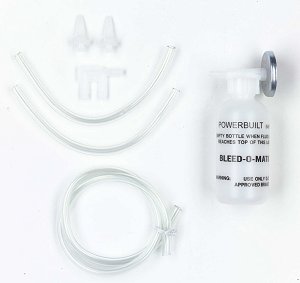

You can siphon the master cylinder, and you will end up with new fluid up there and but still the old and gunky fluid in the line all the way to the calipers. Brake bleeding is not hard at all. Just follow this simple instruction. BLEEDING BRAKE SYSTEM: HYDRAULIC SYSTEM BLEEDING CAUTION: DO NOT spill brake fluid on painted surfaces. To avoid paint damage, immediately clean any spilled brake fluid with a clean cloth and clear water. 1. Purchase a brake bleeder kit such as this one
https://images.2carpros.com/forum/automotive_pictures/55316_648591_1.jpg

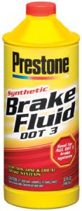

and follow the assembly instruction 2. Raise entire vehicle and remove all wheels. 3. Fill master cylinder with clean brake fluid. Fluid should meet DOT 3 or DOT 4 specifications, such as

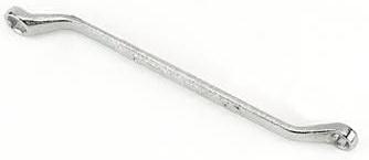

5. Attach the bleeder hose from the bleeding kit onto the bleeder valve. Loosen the valve. Make sure you use brake bleeder wrench, not regular wrench. Regular wrench may round off the bleeder valve. Such as this one
