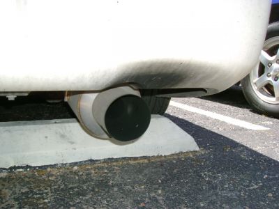

and i havent noticed black smoke coming out the back but the back of my car has a black trail coming up it from the exhaust side

A bad cat might not throw any codes and if fuel is being dumped through the cat, it would run red hot.
Was the ignition timing checked ?
The black trail indicates the cat is not working correctly.

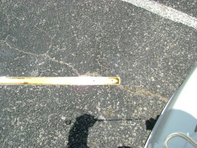

what about when i go to check my oil the dipstip comes out dry?
May 1, 2010 at 4:42 AM
KHLOW2008
  • 41,814 POSTS
Does the exhaust emit grey smoke at initial start up, maybe a few nimutes after starting up?
Is the leak very bad?
How many miles have you driven the vehicle after oil replacement?

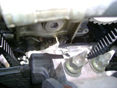

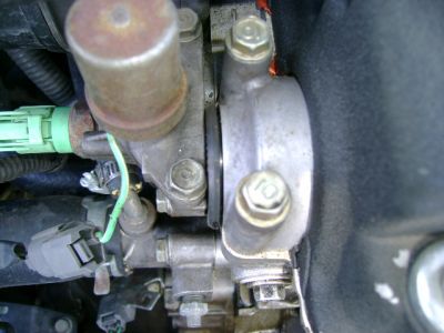

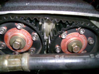

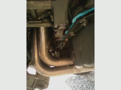

i havent really looked to see if the exhaust was emitting smoke and idk if the leak is bad but the oil slowly disappears i dont know what to do ive changed valve seals the pan gasket head gasket i dont even drive the car 3000 miles before oil replacement and it seems the oil is gone after a month and i dont race the car i try to take it slow cause i know the engine`s old and i dont need anymore problems i probably did oil change early last month and thats whats left and some sort of liquid is comin from the passenger side of the engine whats ignition timing? i have after market cam gears that i cannot get the specs on and could all the oil loss be from cam seals?

Adjustable cam sprockets means the valve timing might not be accurate and that can cause the timing to be off and that can result in the incomplete combustion.
The liquid leaking from between the tran and engine area could be from the distributor or its O ring.
You might need a thicker grade oil if the one that you are using is being depleted too fast.
Ignition timing is the time the spark fires and is affected by the distributor position.
If the cam seals are not properly installed, it can leak quite badly. You would need to remove the valve and timing cover to have a visual inspection.

You are right about the cam seals not leaking judging by the picture.

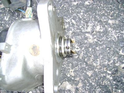

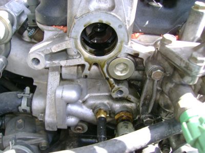

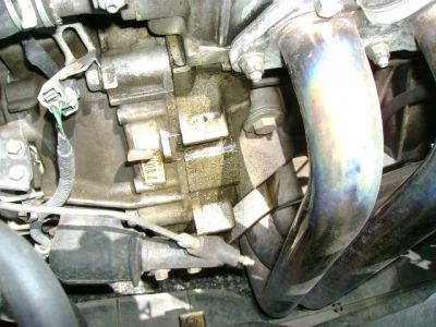

i removed the distributor the o ring looks fine and it doesnt seem to be leaking any oil from that side
https://images.2carpros.com/forum/automotive_pictures/522752_DSC01192_1.jpg
https://images.2carpros.com/forum/automotive_pictures/522752_DSC01193_1.jpg
i was lookin at the seal behind the vtec and it doesnt look to be seated all the way but would this cause all the oil to disappear
https://images.2carpros.com/forum/automotive_pictures/522752_DSC01194_1.jpg
and doesnt 20w50 seem a little drastic? and i figured you didnt have the specs its just my luck but how would i correct it without buying new wheels i thought that the rotor on the distributor is supposed to be at the #1 plug while the gears should point straight up along with the crankshaft? the aftermarket gears are not adjusted and are still pointed at 0

Is there any oil stains below the VTEC valve? The cam end cover would tend to leak as well. Unless leaking is noticed, if not it is not going to cause the oil to disappear.
No, 20/W50 is not really drastic. In fact for slightly temperate regions that is the recommended grade.
The distributor is only installed in one position but the tightening points are slotted so the distributor can be turned clockwise or anticlockwise to a certain degrees. A timing light is required to check the correct position.

The VTEC valve tends to leak when the gasket hardensover time.

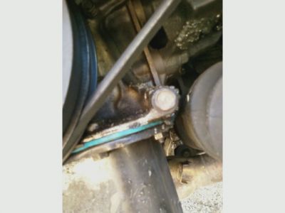

alright i just got done retiming my car earlier today and while i was marking the pulley with the chalk and noticed that the splash guard had oil residue on it and it looks like the oil pan gasket is messed up again and i already replaced it not even six months ago and im thinkin possibly the gasket behind the pulley might be bad or something cause there seems to be grease clumped up on everything around the pulley whats your idea(s) on this cause im upset that i seem to fix one thing and another thing goes out

and now that ive retimed my car the sputtering and misfiring has died down i had to adjust the timing closer to tdc because its was already perfectly timed on the red timing mark

The grease seems to be from the inner CV joint. Check the boot for tears and the clips to ensure they are secure.
As to oil on the splash shield, the only way to find out is to clean the area and run the engine then check for the source of the leak.

The rear cam might be out of time.
May 22, 2010 at 6:38 PM
CBORDEN
  • 29 POSTS
i just replaced that axle though why would it already be messed up?
and yea im about to change the oil so before i do that ill check were its coming form because i do not like changing that pan gasket its not hard its just messy
and i got the car as best timed as it can be because i have after market cam gears and i dont have the spec cards because they came on the car and the wheels are now discontinued so i cant locate them should i buy another set
and i replaced the vtec gasket and im glad i did because the old one was quite hard and broke apart while i was taking it off
and i fixed the cam seal also
May 23, 2010 at 8:46 AM

I do not have the specs for the valve timing so would not be able to help you on the timing.
If the axle is new, the grease could be there before the so clean them up and retest.
Axles sometimes do have the boot bands slightly out of specs so it they ae loose, grease would be silled out while running.
May 23, 2010 at 11:21 AM
CBORDEN
  • 29 POSTS
so should i buy new cam wheels or no?
and can i tighten up the clamps
or do i need to replace something?
May 24, 2010 at 2:10 AM
KHLOW2008
  • 41,814 POSTS
If the clamps are not sufficiently tight, retightening them would do.
As to the camsprockets, unless it is oem where it would be standard. Otherwise you would need the valve lift specs to adjust them. If not you would have to go by a trial and error whereby you mark the initial point and then you can try moving the cam position slightly forward or backwards.
Usually when adjustable cam sprockets are installed, they would tend to increasr the timing of the valve lift so you can try retarding the cam slightly. Remember to mark the initial piont correctly and to retard the valve lift, the cam sprocket must move forward slightly so that the camshaft would be slower than initial.
May 24, 2010 at 3:37 AM

alright i dont understand why i changed the oil pan gasket for the third time and its sealed and everything and theres no visible signs of leaking ( no puddles under the vehicle or drip spots or anything) but i had it full yesterday and now its to half full,and i made sure i didnt over torque it,i just dont understand why and how the oil is dissappearing
its really frustrating me!
May 28, 2010 at 7:07 AM
KHLOW2008
  • 41,814 POSTS
When no oil leaks are present, the only way oil could be disappearing would be via :
1. Valve seals.
2. Piston oil rings.
3. Intake manifold via the PCV.
For any of the above conditions to occur, it would not use up half the oil on the dipstic mark, it should be almost 1 quart for that amount, unless the engine is smoking badly from the exhaust.
Top up the oil and check the oil under the same conditions, ie before start up every morning. After starting the oil level might be different as some oil could be trapped somewhere and not getting down to the sump fast enough.
May 29, 2010 at 1:54 AM
