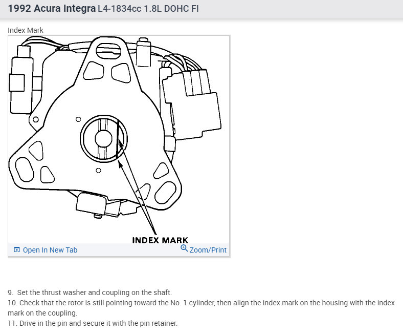

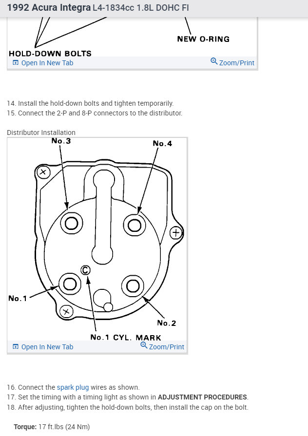

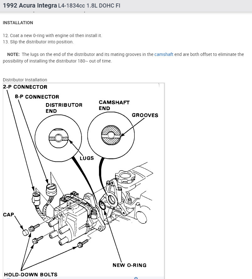

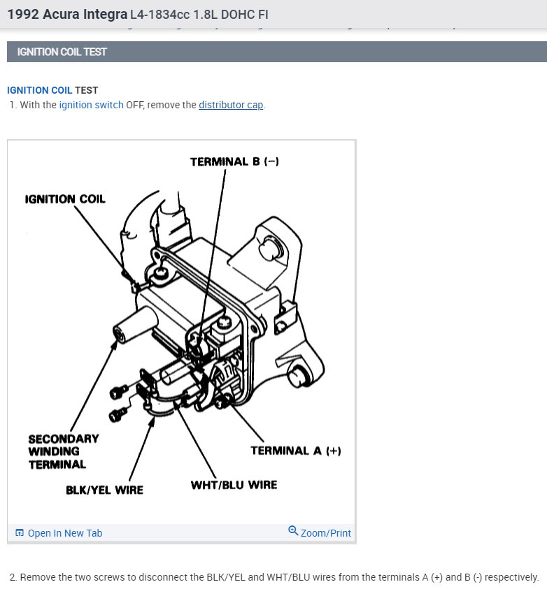

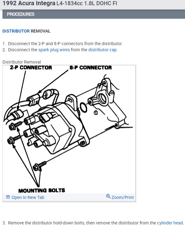

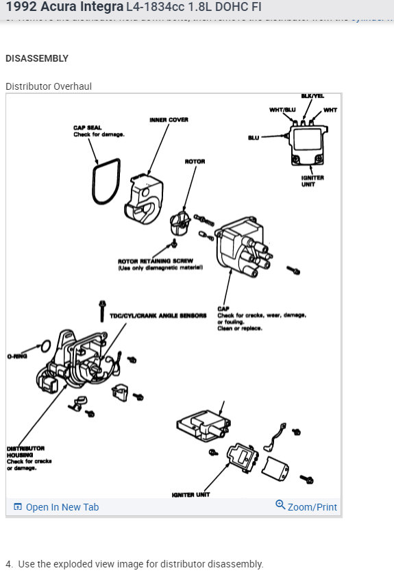

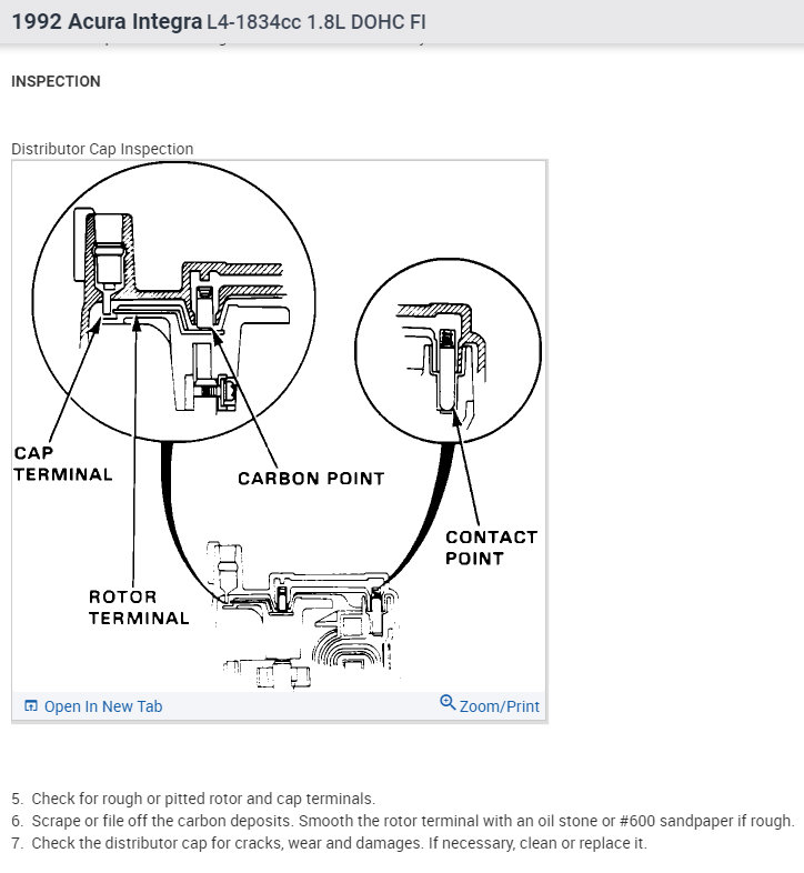

If there is no spark, it could be due to bad distributor cap or rotor, faulty distributor. It can also be due to a bad ignition coil.

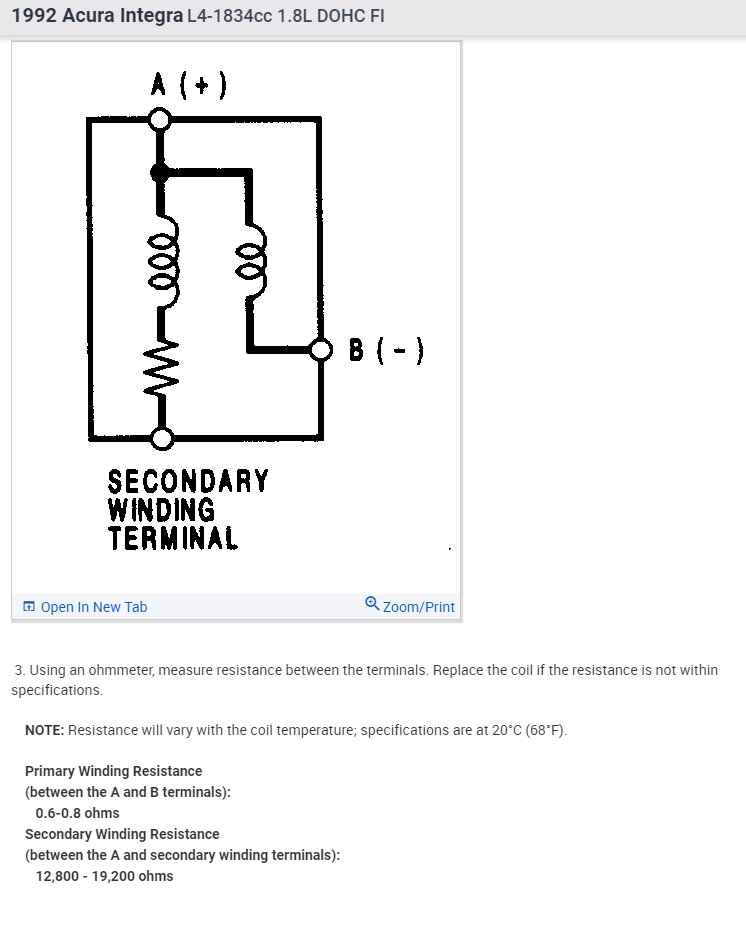

It can also be due to the coil not getting any power.

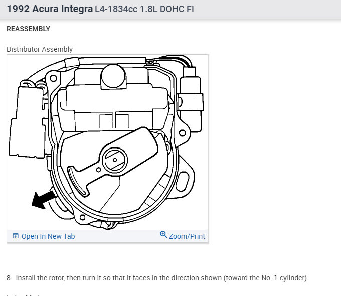

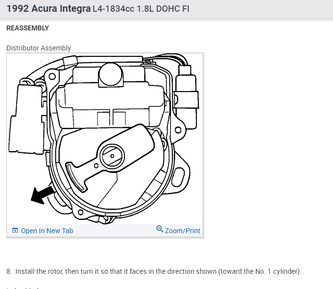

I have attached the coil testing procedure below. Also included the diagrams for your reference.
Images (Click to make bigger)
