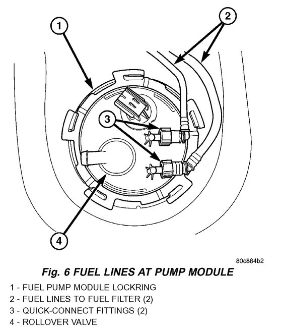

Here are the directions specific to testing fuel pressure on this vehicle. Picture 1 correlates with the directions. The manufacturer's specs are also included in the directions.

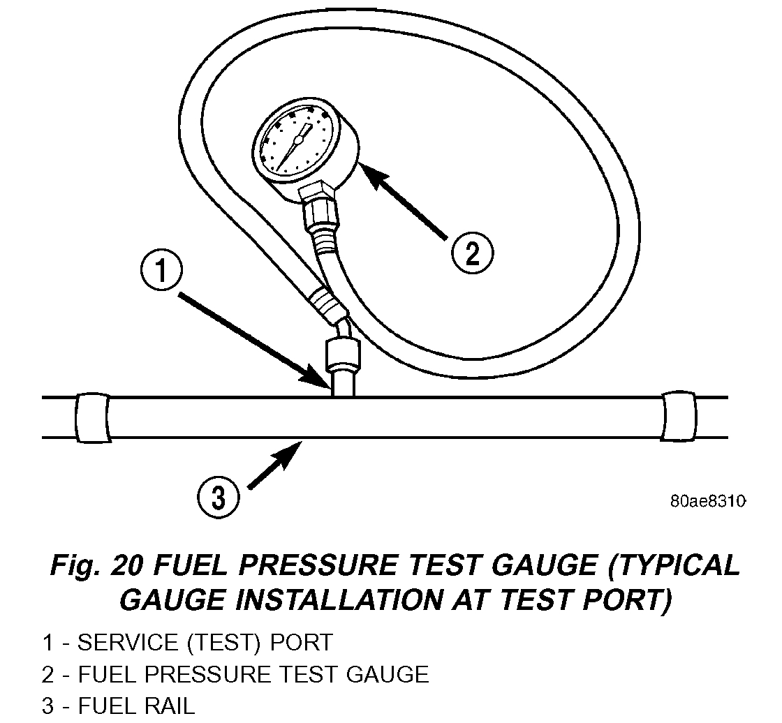

Fig.20 Fuel Pressure Test Gauge (Typical Gauge Installation At Test Port)
See pic 1
1. Remove protective cap at fuel rail test port. Connect the 0 - 414 kPa (0 - 60 psi) fuel pressure gauge (from gauge set 5069) to test port pressure fitting on fuel rail. The DRB III Scan Tool along with the PEP module, the 500 psi pressure transducer, and the transducer-to-test port adapter may also be used in place of the fuel pressure gauge.
2. Start and warm engine and note pressure gauge reading. Fuel pressure should be 339 + 34 kPa (49.2 + 5 psi) at idle.
3. If engine runs, but pressure is below 44.2 psi, check for a kinked fuel supply line somewhere between fuel rail and fuel pump module. If line is not kinked, but specifications for either the Fuel Pump Capacity, Fuel Pump Amperage or Fuel Pressure Leak Down Tests were not met, replace lower section of fuel pump module. Refer to Fuel Pump Module Removal/Installation.
4. If operating pressure is above 54.2 psi, electric fuel pump is OK, but fuel pressure regulator is defective. Replace lower section of fuel pump module. Refer to Fuel Pump Module Removal/Installation.
5. Install protective cap to fuel rail test port.

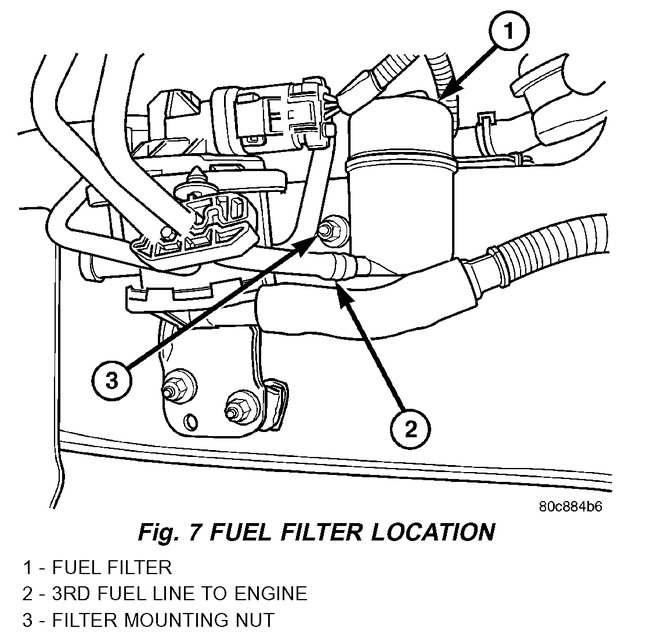

Here are the directions specific to your vehicle for replacement of the fuel filter. The remaining pics correlate with these directions.

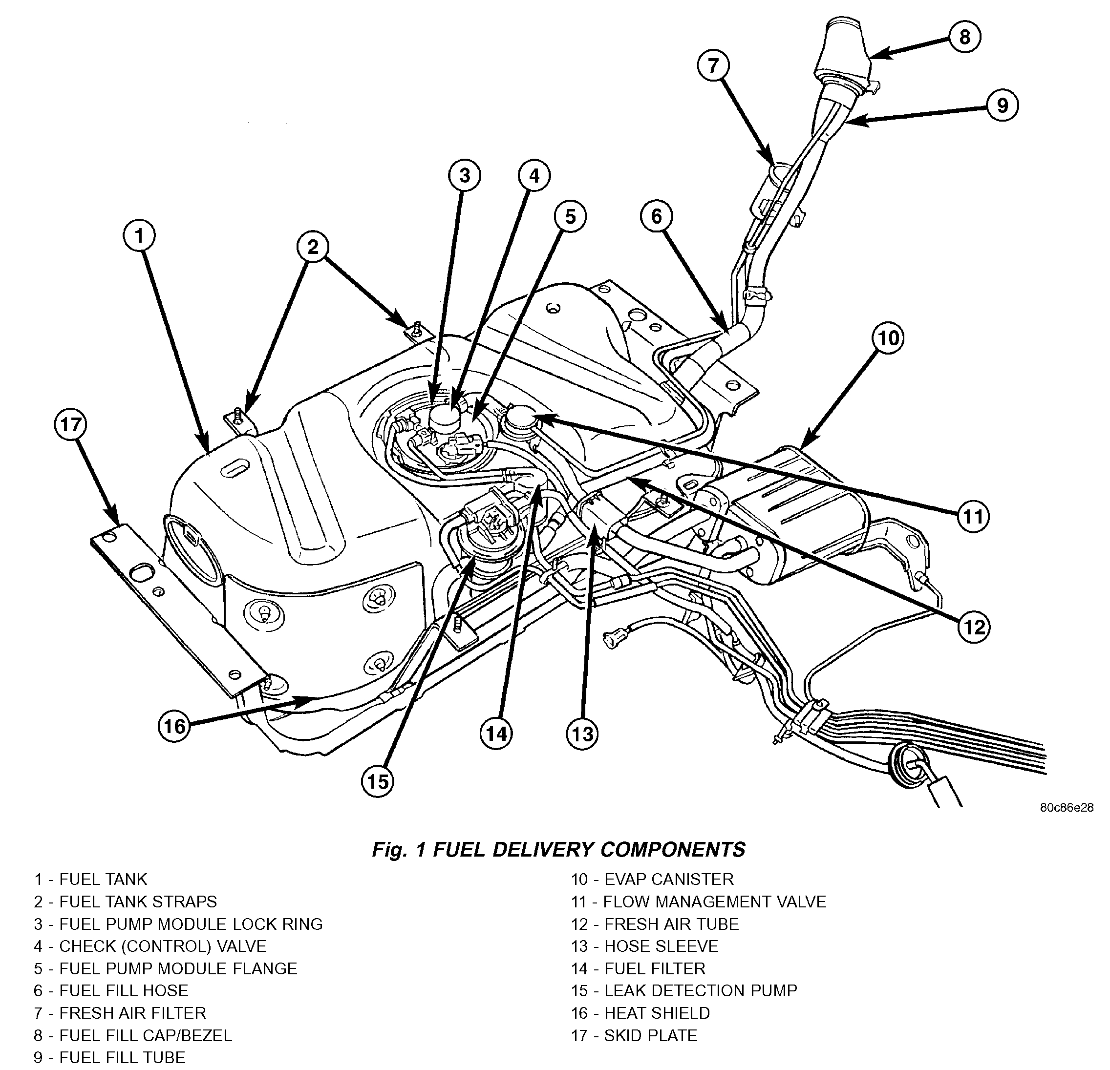

Fig.1 Fuel Delivery Components
pic 2
The main fuel filter is attached to the front of fuel tank. Three fuel lines are used at filter.

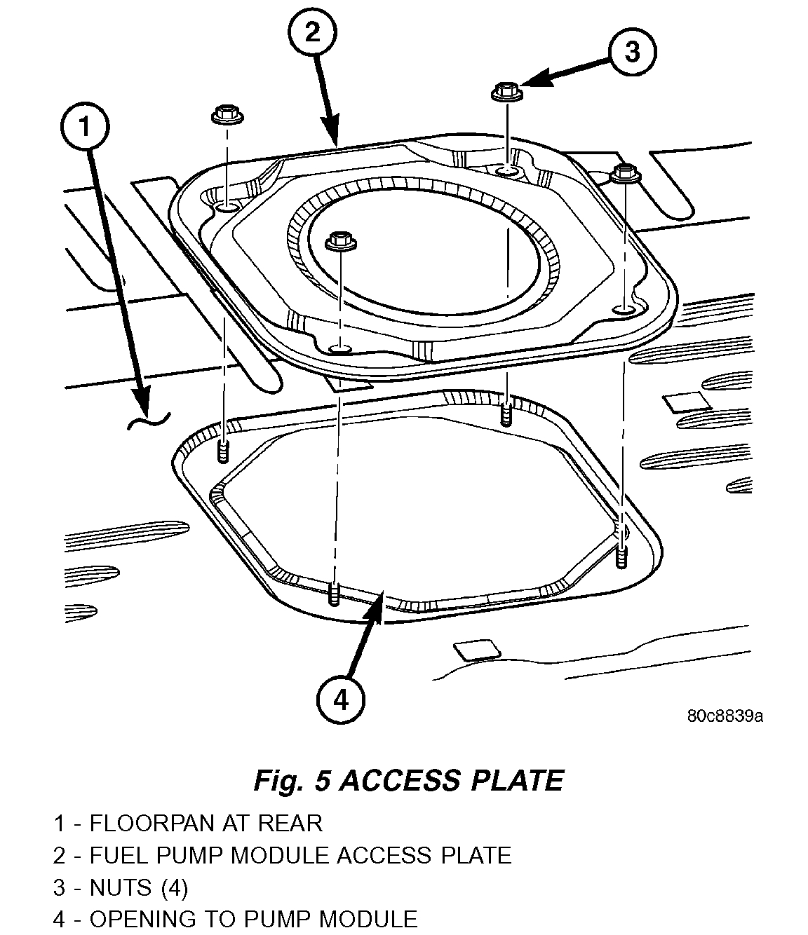

Fig.5 Access Plate
pic 3
3. Fold carpeting forward to gain access to fuel pump module access plate.
4. Remove 4 fuel pump module access plate nuts.
5. While applying heat from a heat gun, carefully pry up metal fuel pump module access plate. Take care not to bend plate.

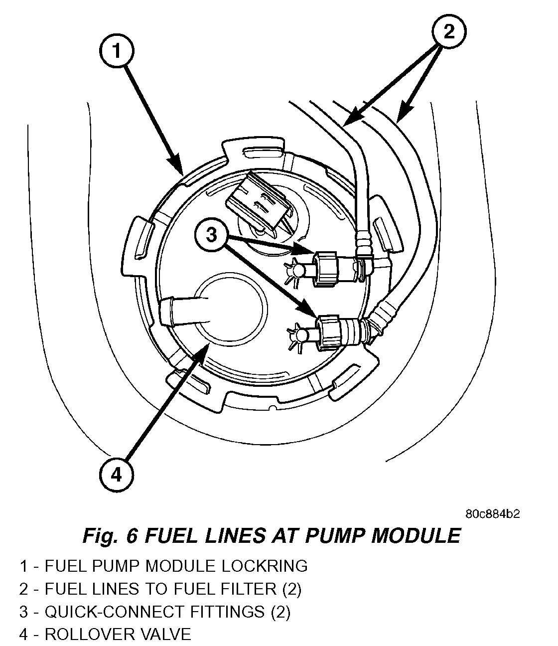

Fig.6 Fuel Lines At Pump Module
pic 4
7. Disconnect 2 fuel lines at fuel pump module by pressing on tabs at side of fitting.

Fig.7 Fuel Filter Location
pic 5
10. A third fuel line is attached to bottom of filter. The disconnection point for this 3rd line is approximately 1 foot towards front of vehicle. Clean fuel line connection point before disconnection. Disconnect by pressing on tabs at side of fitting.
11. Disconnect 3rd fuel line from body retention clip. Place a small screwdriver into side of clip and twist for removal.
12. Remove filter ground strap at fuel tank mounting strap.
13. Remove 1 filter mounting nut and remove filter.
