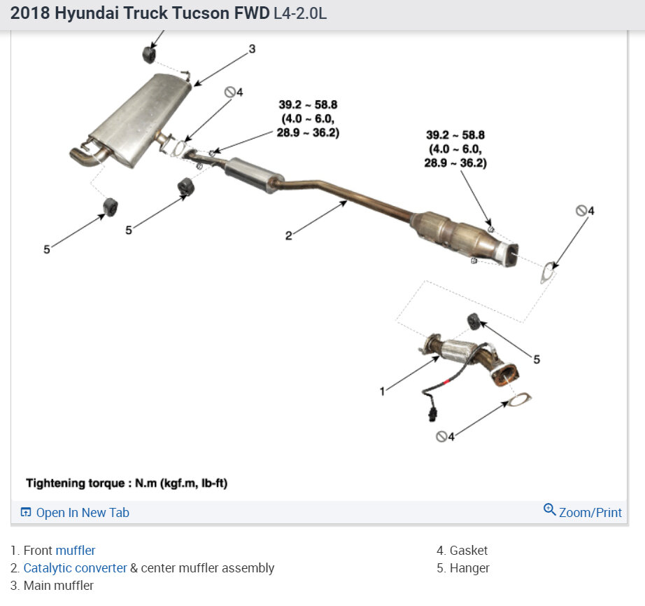

We have had the car at the dealership and no codes came up. Dealer said to replace catalytic converter as a temporary fix. However, this car has 2 catalytic converters, which one do we replace? They say it’s getting clogged and that is part of the issue with acceleration problems.
Nov 6, 2023 at 1:12 PM
  • 55,402 POSTS

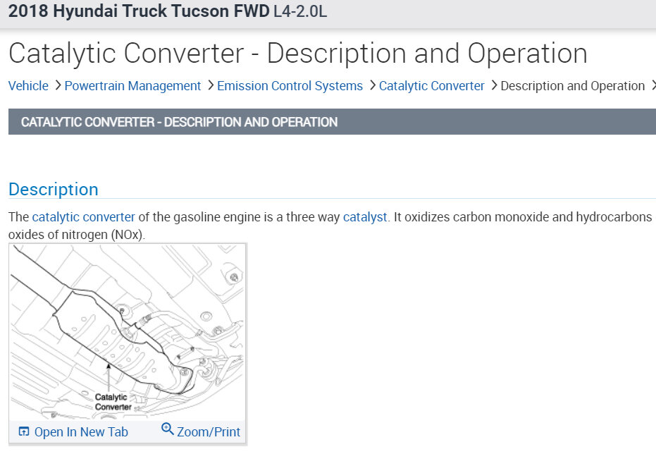

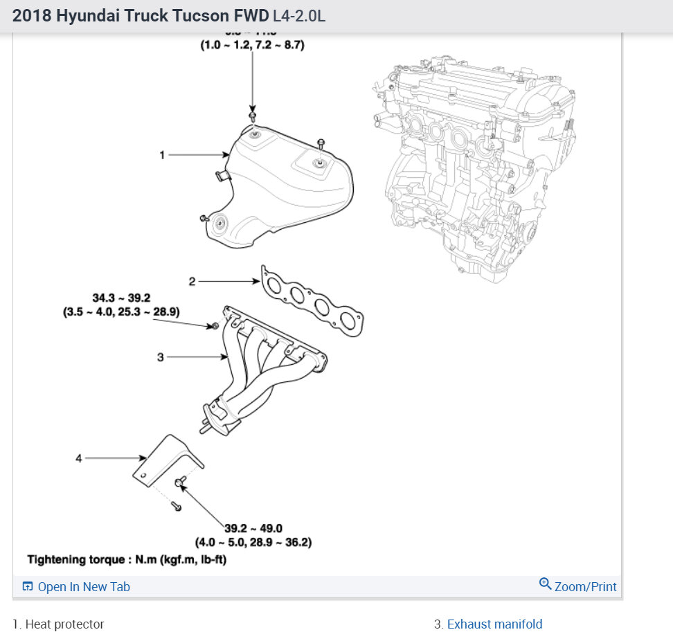

I only see one catalytic converter on this car, here is the system so you can see for yourself. I can't see how replacing catalytic converter is a "temporary" fix? Does the car have any codes? Here is how you can test the cat by using this guide. Do you live in California, if so, you may have a catalytic converter where the exhaust manifold is in which case this would be the one I would change?
Here is a guide as well:
https://www.2carpros.com/articles/engine-has-low-power-output
I would run the codes as well.
This should help us confirm the problem as well. Check out the images (below). Please let us know what happens.
