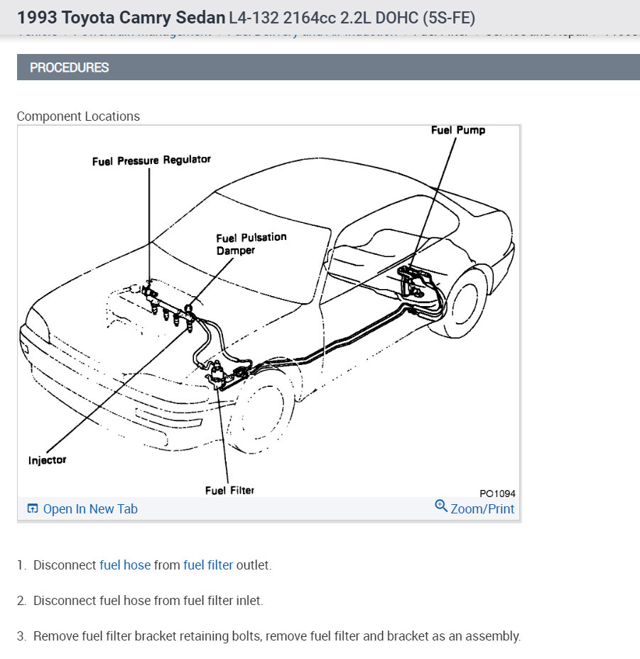

When I first start it is and the motor is cold it starts of fine. Withing 2 or 3 minutes if I slow down or stop it will shut off as soon as I give it gas. If I ease it into high idle, pumping gas pedal, then let off of clutch, I can start off. On the freeway I have to keep it high RPMs.
Would O2 sensor cause that?

I don't think the oxygen sensor can cause that, but we should run the codes to see what comes up.
here is a guide to help:
https://www.2carpros.com/articles/toyota-trouble-code-definitions-and-code-gathering-method-1990-1995
It sounds like you have a vacuum leak, or the fuel filter is clogged. Please follow this guide when the engine is cold only:
Here is the location of the fuel filter so you can change it out in the images below. Please let me know what you find.
