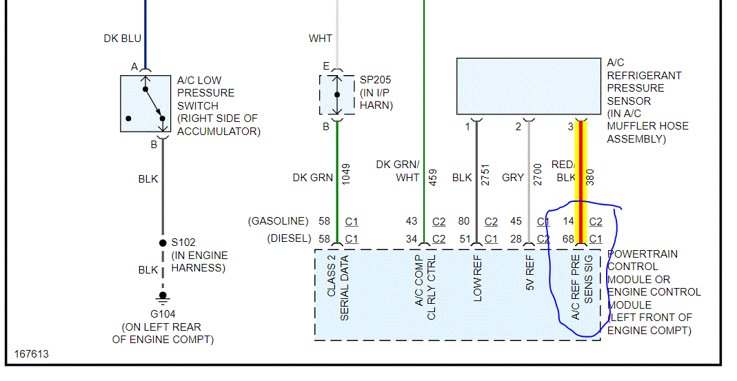

Roy,

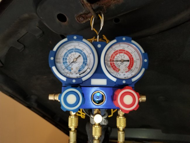

Tonight I tested the following after letting truck run for a few minutes to allow A/C pressure to stabilize (see attached picture), Freon seems a little low:
Low Side:
0v and 5v
jumped the low side connector, the compressor did not come on.
High side connector:
red = 0v
white=5v
black =0v
I also re-read the air conditioning not working article and am wondering if I have enough power at the low side sensor, the article indicates I need for 12v.
Where should I test next?
Should I add Freon to confirm the low side jump, I read the system needs to be at 25 psi for the test to work properly.
Thank you,
Bret

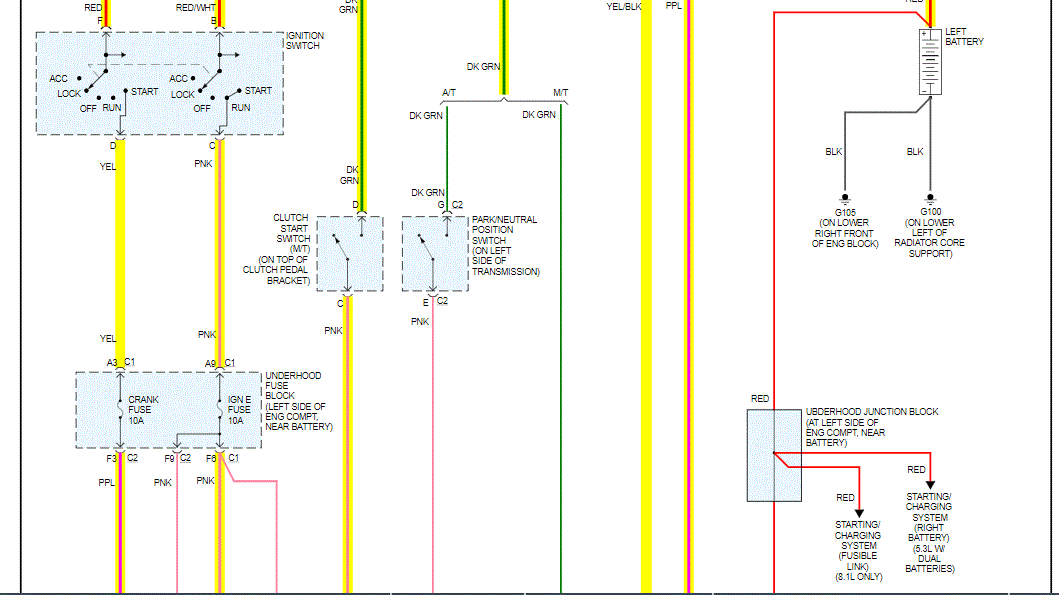

Roy,

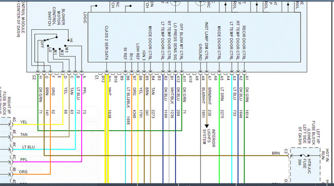

I studied the schematic's further. How likely is it the climate control module is not sending the proper signals to the low side sensor and ECM? Should this be our next test?
Bret
Aug 10, 2020 at 9:15 PM
No, the fact the system is working eliminates the sensors and the wiring.
I cannot read the pressure you posted. The picture is too small and cannot make out the readings. Can you either take a picture I can read or just tell me the high and low side pressures?
Aug 10, 2020 at 9:21 PM
BWILKINSON05
  • 68 POSTS
Roy,
10-4. Blue gauge = 25 psi, red gauge = 110 psi.
Thanks,
Bret
Aug 10, 2020 at 11:02 PM
Okay, how much Freon did you add?
What is the outside temperature?
The low side is perfect.
The high side is low. It should be 2 times ambient plus 15%.
Aug 10, 2020 at 11:04 PM

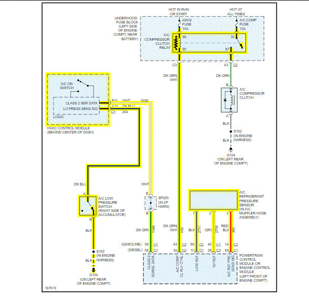

Bret
Aug 11, 2020 at 12:57 AM

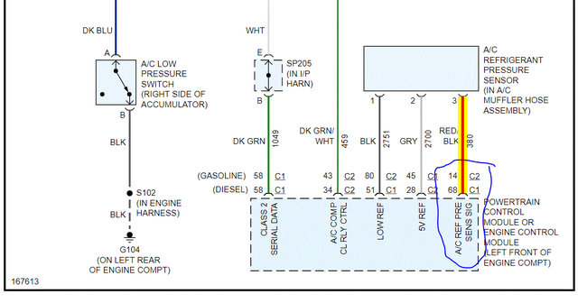

Okay, we will go over this again.
30 and 87 are good for the relay as the compressor comes on when you jump it.
86 has to have power as well.
85 is grounded by the ECM once it sees the correct signal from the low pressure switch and the pressure sensor.
Do you have power at the low pressure switch?
Do you have 2 5 volt powers at the pressure sensor?
Aug 11, 2020 at 1:03 AM
BWILKINSON05
  • 68 POSTS
Roy,
I have 5v at the pressure switch and 1-5v line (white line) at the high pressure switch. I believe I need 12v at the low pressure switch and believe that may be the issue.
Bret
Aug 11, 2020 at 1:06 AM
At the pressure switch, you need 2 5 volt pins. Do you have that?

I know I also stated the wiring to the ECM could be the issue. Did you verify the wire was good to the ECM on the wire that did not have voltage?
Aug 11, 2020 at 1:41 AM
BWILKINSON05
  • 68 POSTS
Roy,

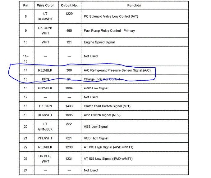

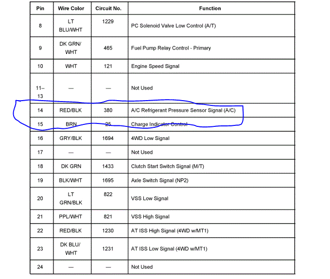

Do you want me to test the new ECM at pin #14 (ECM to battery ground) and from the high side red line to the ECM (pin to pin)?
Bret
Aug 11, 2020 at 1:44 AM

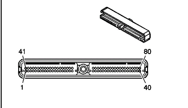

At pin 14 on the new ECM, back probe it and test for voltage.
Aug 11, 2020 at 1:47 AM
BWILKINSON05
  • 68 POSTS
Roy,
I tested the following with key in the on position:
1. Back probe with paper clip at pin 14 with harness plugged in 0v.
2. Removed harness, paper clip front of harness, 0v.
3. Pin to Pin - pin 14 to high side sensor red pin - 0 ohms, continuity should be good.
What do you recommend I test next?
Thank you,
Bret
Aug 11, 2020 at 8:40 AM
That was a red/black wire correct?
Aug 11, 2020 at 8:52 AM
BWILKINSON05
  • 68 POSTS
Roy,
Correct, pin 14 which has a red wire with black line.
Bret
Aug 11, 2020 at 9:00 AM
Does not make sense. You have replaced the ECM and it still has no power to that pin. Without that power the control side of the relay will not work.

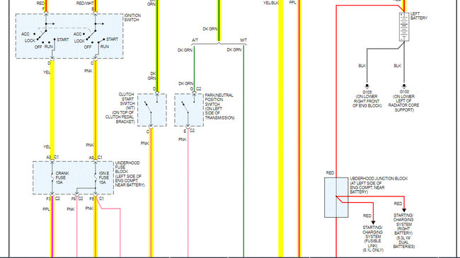

Aug 12, 2020 at 1:06 AM
Yes, but the issue is nothing at pin 14.
This leads me back to the ECM again. Let me look for any other information.
Aug 12, 2020 at 1:11 AM
BWILKINSON05
  • 68 POSTS
Roy,
How do I test the power going into the ECM? See July 11th email with schematic. I believe that's the issue. Pin 14 is line from the ECM to the high side sensor. If you look at the schematic, I would like to test the line from the CCM to the ECM, it's the grey line. I believe I need to remove CCM and back probe the grey line.
Bret
Aug 12, 2020 at 1:22 AM
If there was no power to the ECM, you would have many other issues and a ton of codes.
The gray wire you told me had 5 volts as it should. Why do you want to check it again? That along with the red/black need 5 volts.

You are off track here. The issue is the red/black wire. Neither of those wires have any effect on power to that wire.
Aug 12, 2020 at 4:06 AM
BWILKINSON05
  • 68 POSTS
Roy,
10-4. What is the power source to the red/black wire?
Bret
Aug 12, 2020 at 4:46 AM
Again, the ECM.

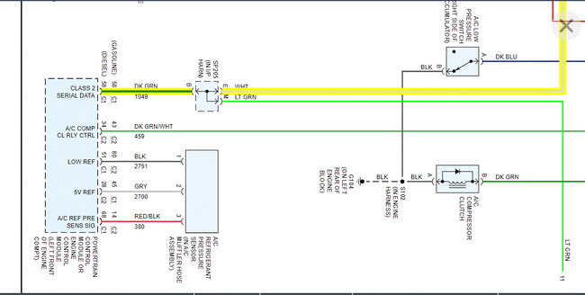

Roy,
For testing purposes only, what should the voltage be at the white wire exiting the climate control module connecting to SP205 then to the ECM? What is the SP205? Also, do you have a schematic of the climate control module you can send?
Thank you,
Bret
Aug 13, 2020 at 8:09 AM
I attached the diagram with the white wire. It is serial data. There is no voltage. It is a multiplexing signal.
Aug 13, 2020 at 8:23 AM
BWILKINSON05
  • 68 POSTS
Roy,
What should the readings be at pin #'s: 58 and 43?
Bret
Aug 13, 2020 at 1:17 PM
58 is the serial data line I told you about.
43 is the wire from the control side of the relay. It will have 12 volts there unless the ECM grounds that wire. Then it will be 0.
