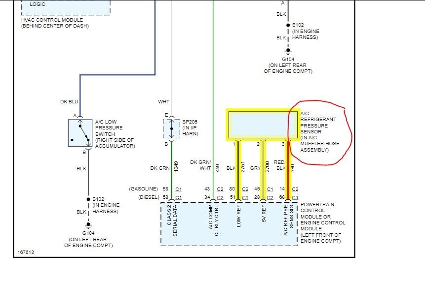

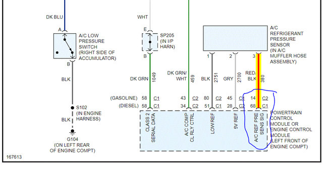

Okay, I sent another diagram for you. The 2 wires I circled need 5 volts. Tell me which one does not have power. That power comes from the ECM. You may have a bad ECM or the wiring to it.

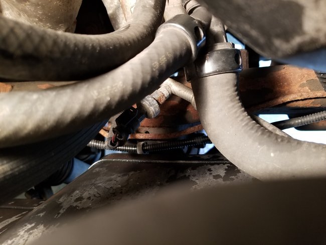

I measured the three pins at the high side connector:
middle/top pin = 0V
left pin = 0V
right pin = 0-5V (this one wasn't consistent and would hold at 0V and then drift up to 5V)
I will measure again tomorrow.

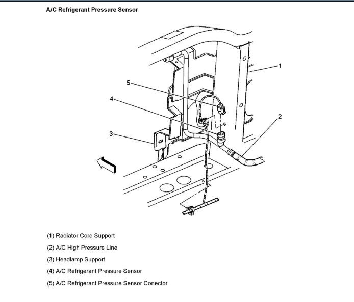

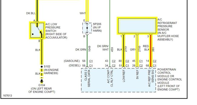

Roy,
I remeasured the readings at the high pressure switch and show the following:
w/paperclip:
Top = Red = 0V
Left = Black = 0V
Right = Grey = 5V after it set
w/o paperclip with relay installed:
Top = Red = 0V
Left = Black = 0V
Right = Grey = 0V
I reviewed the schematic drawing you sent last Saturday at 11:29 AM, I believe the pressure sensor is the bottom right above the ECM. The grey shows 5V, the other two do not indicate a voltage. Does the red also need 5V? Where do you suggest I start with my testing?
Bret
Jul 19, 2020 at 5:02 AM
Yes, the red wire is missing the signal.

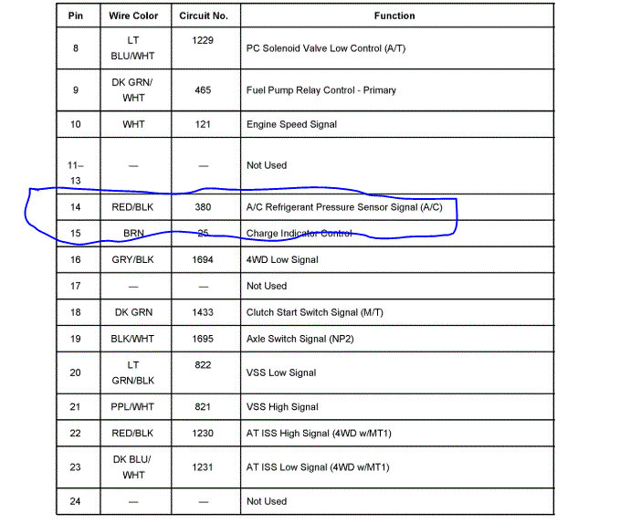

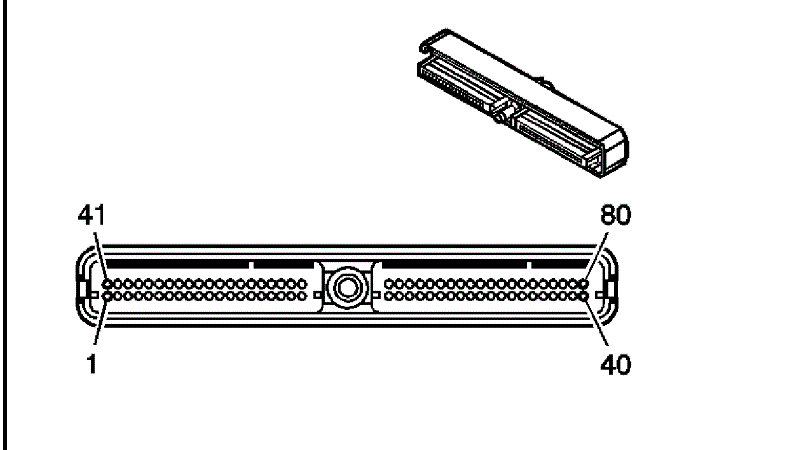

I attached the pin you need to test at the ECM for power to help determine whether it is a wring issue or the ECM.
I attached the connector as well. Check pin 14. Back probe it for 5 volts.
Jul 19, 2020 at 5:15 AM
BWILKINSON05
  • 68 POSTS
Roy,
I have removed the ECM rows/strips. Is mine on the green or blue strip? I found red wires with black stripes on both.
Bret
Jul 19, 2020 at 7:59 AM
At pin 14. there should only be one red wire. the other connector does not have a red wire at pin 14.

With everything hooked up with the key on, put the paperclip at the back of pin number 14 with the red wire and test for 5 volts. Red lead on the paper clip and black lead to a good ground.
Jul 19, 2020 at 8:31 PM
BWILKINSON05
  • 68 POSTS
Roy,
I tested the #14 pin on the green strip top and bottom from each end - 0V for each test, total of 4 tests. This was the only strip with a red line near the 14 pin.
Bret
Jul 20, 2020 at 11:05 AM
Okay, without that output, the A/C will not work.
Looks like you need an ECM.

It is because the ECM is bad.
Replace it and let us see if it fixes the issue.

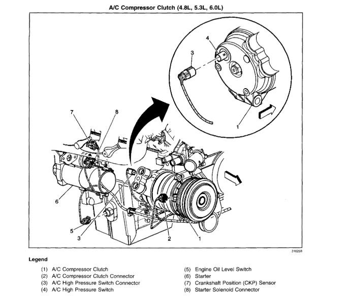

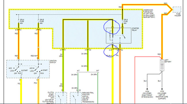

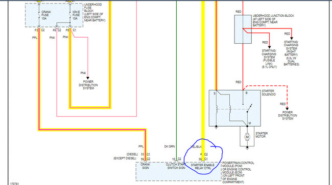

I attached a diagram for you of the starting system. You need to see if the ECM is grounding the control side of the relay at the pin I circled.
Aug 8, 2020 at 6:04 AM
BWILKINSON05
  • 68 POSTS
Roy,
We tested the starter relay in the fuse box with key on and off:
1. Bottom left pin (front of vehicle) with the back top right pin ranged = 9-11.5V
2. Top left pin (front of vehicle) with the back bottom right pin = 0v
3. Left top and bottom pin = 0v
4. Right top and bottom pin - range from 7-11.7v
Bret
Aug 8, 2020 at 6:33 AM
You should have one pin with battery voltage all the time. It should be 12.4 to 12.6. Looks like your battery is very low.
You have a terminal that has battery voltage with key in the start position only as well.
Check and confirm.

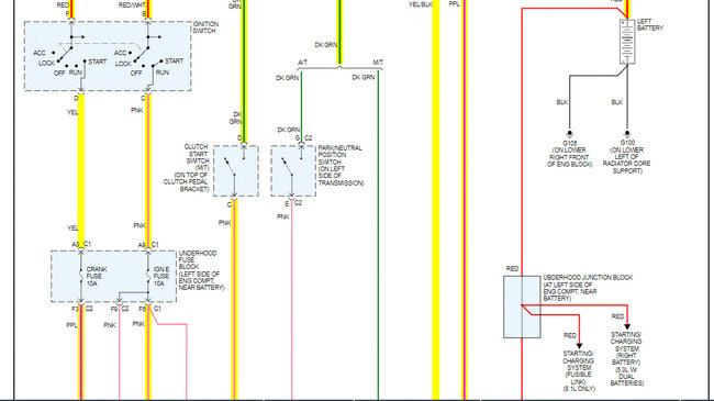

You are missing the constant battery voltage reading as well. Check the ignition A 40 amp fuse for power. That is what supplies power. I attached the diagram of the fuse block back a few posts.

You need to go to the relay for the clutch, which I posted way back, and let us start with powers.
Did you check Freon pressures both high and low side?

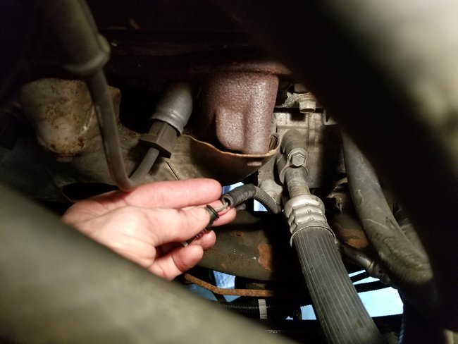

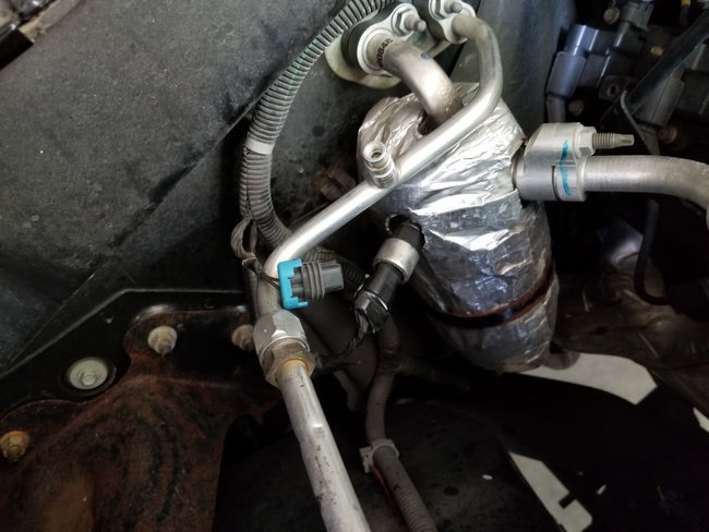

We tested the following:
low side sensor - 5v and 0V
high side sensor - first test we had 5v at one pin, 0v at two pins.
Jumped low side sensor - compressor clutch turned on.
plugged low side sensor back in then removed.
with low side sensor jumped, tested high side sensor - 0v at all three pins.
jumped A/C relay, ran A/C system confirmed Freon at a good level.
jumped low side sensor, A/C clutch would not come back on and was surprised this was the case. I believe the test result initially indicated the low side sensor is bad but can't explain why we don't have 5v at two pins at the high side sensor and why the low side sensor jump won't turn the clutch back on.

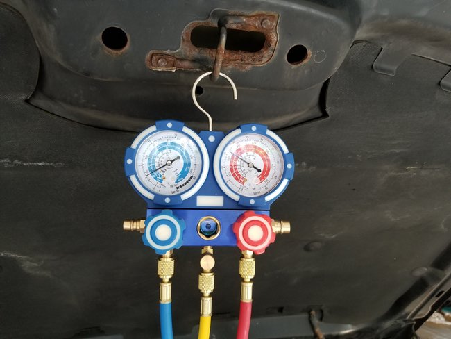

Aug 9, 2020 at 6:04 AM
What is the high and low side pressure when you jumped the low pressure sensor?
Aug 9, 2020 at 6:14 AM
BWILKINSON05
  • 68 POSTS
Roy,
We were surprised the clutch kicked on and then could not get it to repeat which is why I jumped the relay to check the Freon level, blue and red are both at 110 psi.
Bret
Aug 9, 2020 at 6:23 AM

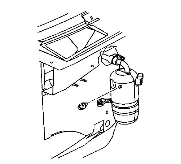

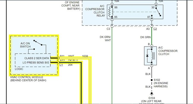

Okay, the low pressure switch voltage comes from the HVAC module as in the diagram.
The pressure transducer comes from the ECM. That should have 2 5 volt signals and 1 return.
Aug 9, 2020 at 6:29 AM
Was that the pressure while the compressor was running?
Aug 9, 2020 at 6:41 AM
BWILKINSON05
  • 68 POSTS
Roy,
Sorry for the delay getting back to you, we had to step out for a family event.
I ran the truck and re-read the gauges, blue = 30 psi and red = 150 psi.
I will remeasure the low side and high side pins tomorrow evening, I tested them multiple times and was surprised by the readings.
Bret
