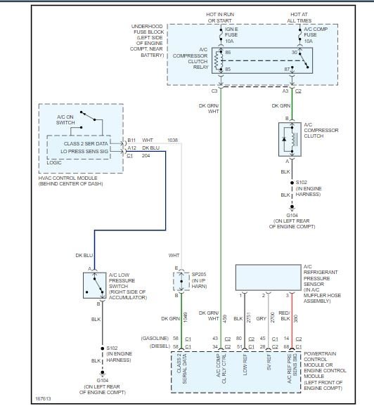

I attached a wiring diagram in case the compressor is not working.

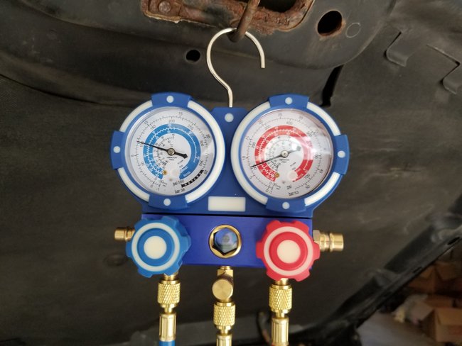

Jul 16, 2020 at 12:43 PM
Okay, the compressor did not kick in because the pressure is too low. 20 pounds on the low side and the low pressure switch will not close and turn on the compressor.
You need more Freon for the compressor to come on line.
I am concerned you had 0 pressure when you started. Did you check for a leak?
https://www.2carpros.com/articles/air-conditioner-leak-detection
Jul 16, 2020 at 12:51 PM
BWILKINSON05
  • 68 POSTS
Roy,

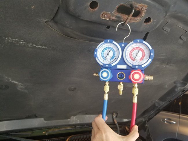

That's what I thought regarding the compressor but the low side gauge read 60 psi after filling from the can which was more than the acceptable range provided. I was concerned about overcharging even though I have only used 11 oz from the can. Should I add the remaining 9 ounces and see if the compressor kicks on?
I read the check for leaks after vacuuming is confirming the gauge holds at -30 which the system did. How do I check for leaks?
This morning we tested the system again and attached a picture for your reference.
Best regards,
Bret
Jul 17, 2020 at 12:59 AM
The gauges are showing 0. The compressor will not come on until there is pressure.
The system holds 1.6 pounds.

Okay, first, no to the reset. There is no reset.
Go to the diagram I posted in the beginning. See the ac clutch relay. Check for 2 power with the key on. There should be 2 terminals with power.
If there is, then you need to test for power to the pressure switches as well.
Check those and let me know.

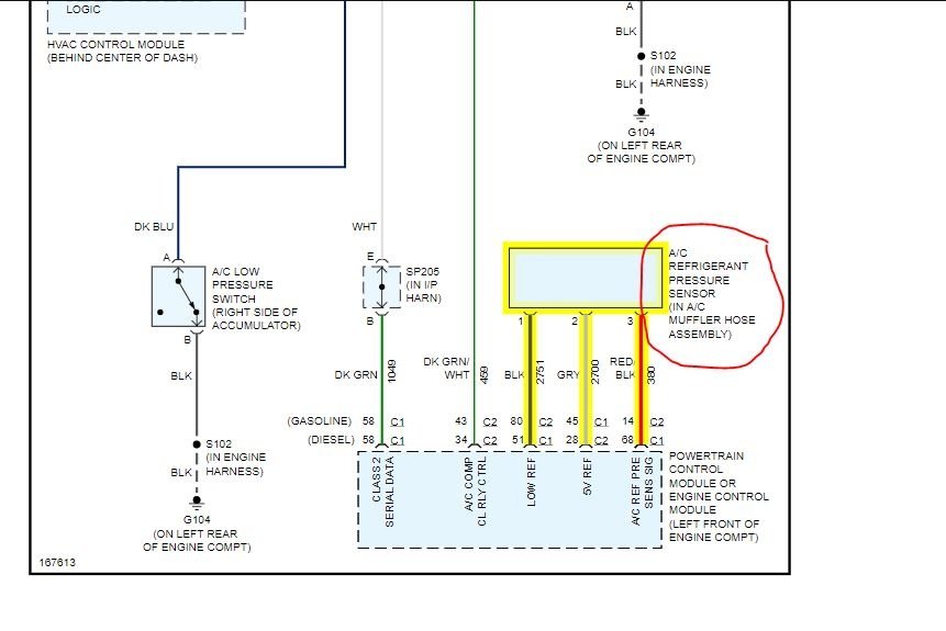

Jul 18, 2020 at 12:49 AM
Okay, did you test the 2 wire sensor or 2 wire? The 2 wire is a low pressure switch. It should have 12 volts with the key on.
the 3 wire sensor run on 5 volts. The reference and signal wires should both have 5 volts. The remaining wire is the return wire to the module.
Please tell me how you determined the module was the failure?
Jul 18, 2020 at 12:56 AM
BWILKINSON05
  • 68 POSTS
Roy,
We tested the pressure sensor near the fire wall which I believe is the low side pressure sensor. It has two ports and read 4.8V with the key on. Where is the 3 wire sensor?
Bret
Jul 18, 2020 at 1:04 AM
Okay, I stand corrected. The 2 wire you checked should be 5 volts. Jump the terminals together and see if the compressor runs.
The 3 wire is at the compressor. It should be on the high side line. It could also be at the front as well. I attached pictures for you.That will have 2 5 volt feeds.

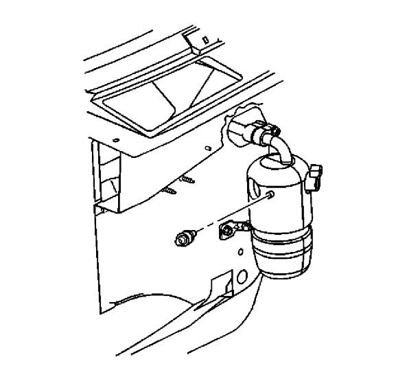

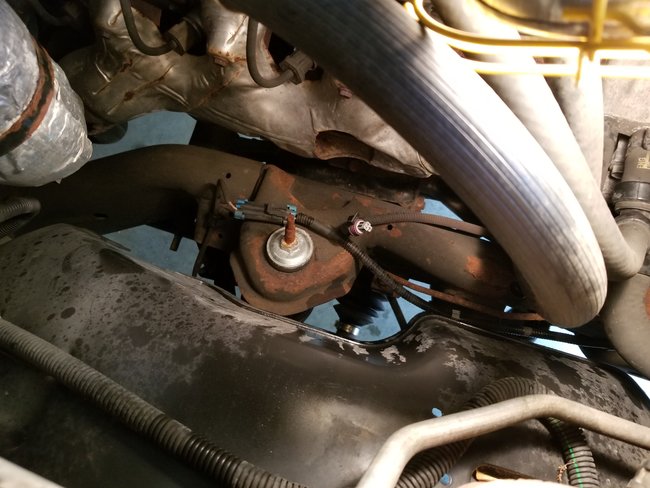

Jul 18, 2020 at 1:22 AM
BWILKINSON05
  • 68 POSTS
Roy,

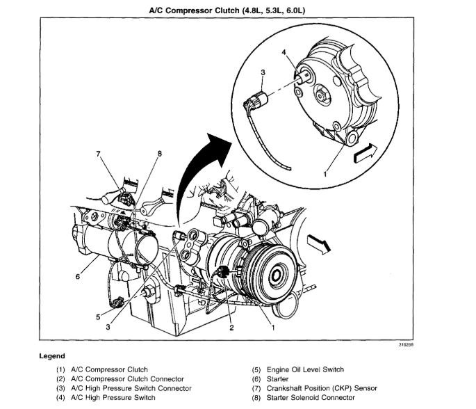

We double checked and confirmed the high side connector was two pins. When we jumped I notice a slight draw on the motor but the clutch did not turn on.
I test the three pin connector near the compressor, see attached picture and it read 5V. i also noticed but did not test a connector on the compressor.
Bret
Jul 18, 2020 at 1:28 AM
Okay, did you jump the 2 wire on the low side? It should be by the dryer assembly.

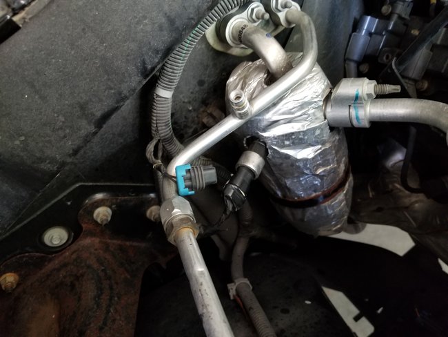

Jul 18, 2020 at 1:38 AM
BWILKINSON05
  • 68 POSTS
Roy,

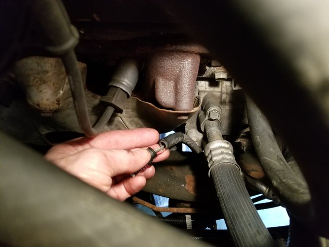

We jumped the low side pressure sensor connector in the attached picture, I noticed a slight draw on the motor but the clutch did not kick-on. There is a second connector near the low side sensor, see blue connector in picture but I do not see a place to plug in.
Bret
Jul 18, 2020 at 1:45 AM
Okay, that connector is for another option.
Did you verify both powers to the other sensor?
Jul 18, 2020 at 1:49 AM

Jul 18, 2020 at 2:05 AM
LIke I said, forget about that connector.

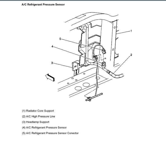

The 3 wire sensor on the high side line by the condenser in the picture I posted.
Jul 18, 2020 at 2:16 AM
BWILKINSON05
  • 68 POSTS
Roy,
We tested the high side pressure connector which read 5V, see picture which I believe matches the location #4 and #5 in the #3 diagram you sent at 8:22 this morning.

Jul 18, 2020 at 3:04 AM
The picture is dark.
How many wires in the connector?
Jul 18, 2020 at 3:06 AM
BWILKINSON05
  • 68 POSTS
Roy,

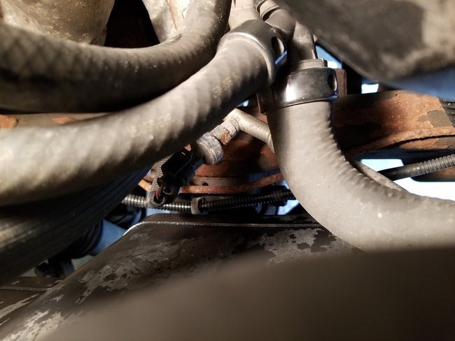

I have attached a close up of the wires on the high side connector. I see red, grey and white.
Bret
Jul 18, 2020 at 3:15 AM
Okay, that matches the diagram.
Do you have 2 wires that show 5 volts with the key on?

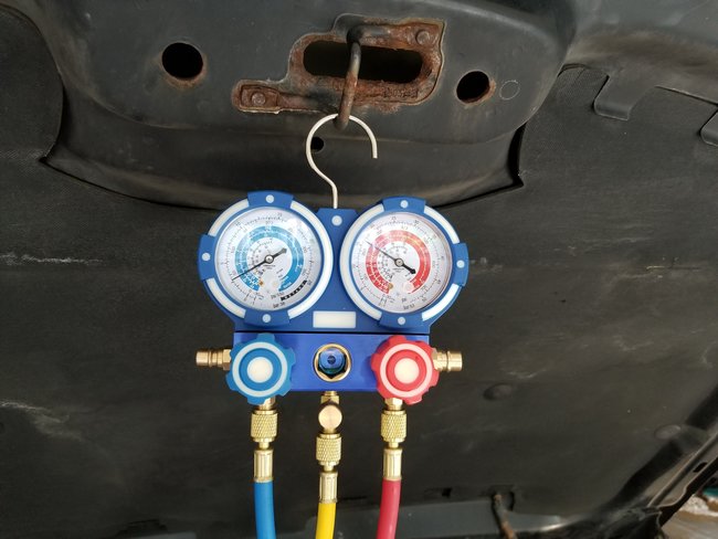

BWILKINSON05
  • 68 POSTS
Roy,
Here is the latest update:
1. I jumped the compressor relay with the paperclip
2. The Freon had run low so I added a new can 12 oz and the remainder of the A/C Pro can, approx 6-8 oz.
3. Allowed the system to run for awhile, please see charge levels which I believe are spot on per the gauge manual.
4. As a test, I removed the paperclip and the compressor clutch stopped, kept jumper clip installed.
