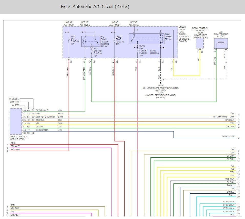

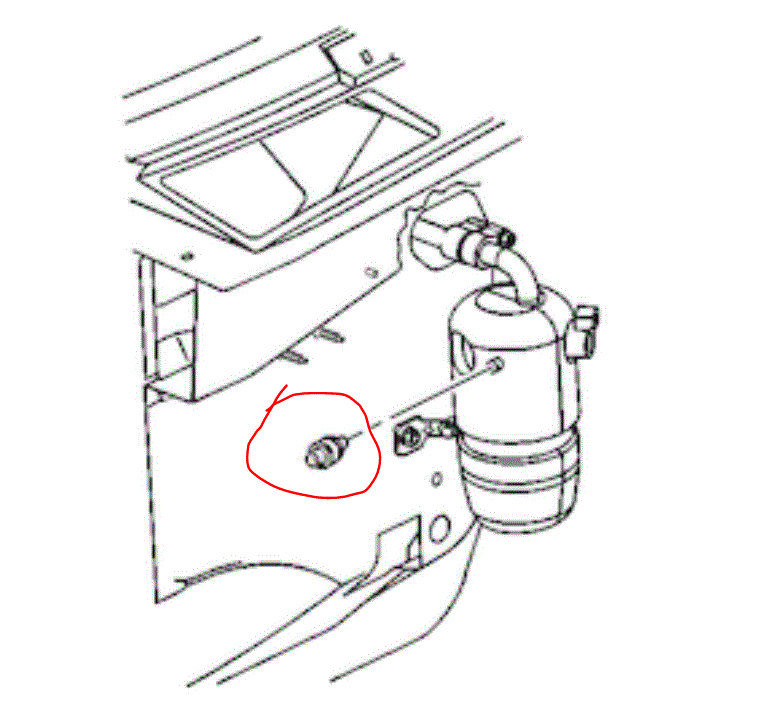

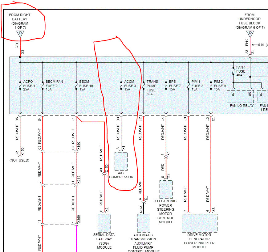

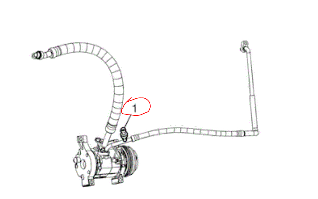

When A/C was working it would run about and hour then freeze up then all of a sudden A/C clutch wont engage. check fuses and relay; they are good but no power to fuse. I was going to test low pressure switch but cant find it to jump it out.
Jul 11, 2020 at 1:57 PM
  • 110,244 POSTS

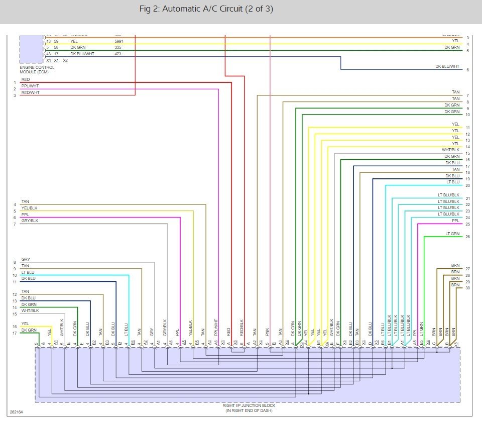

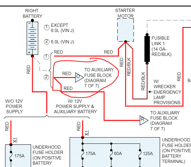

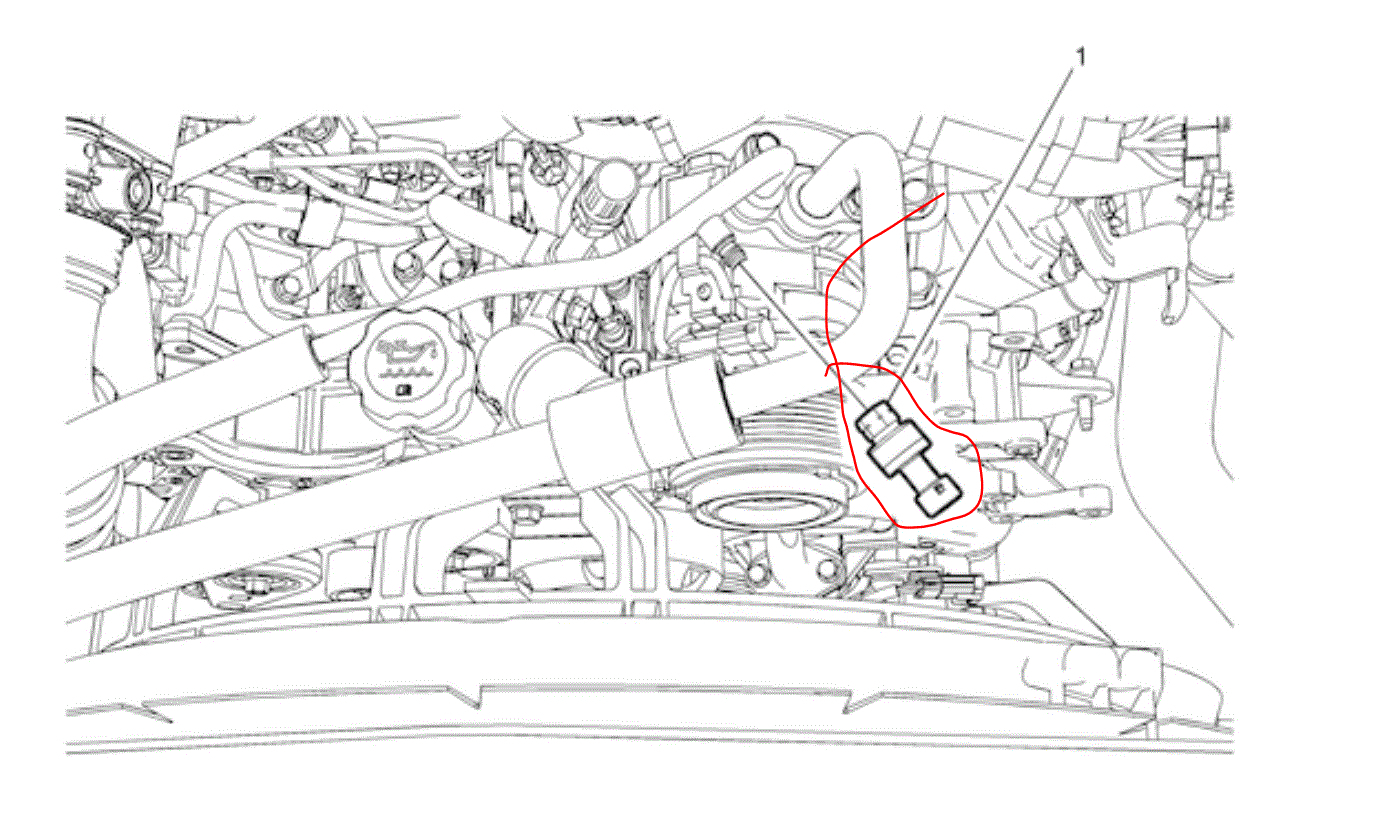

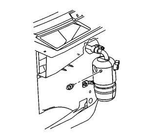

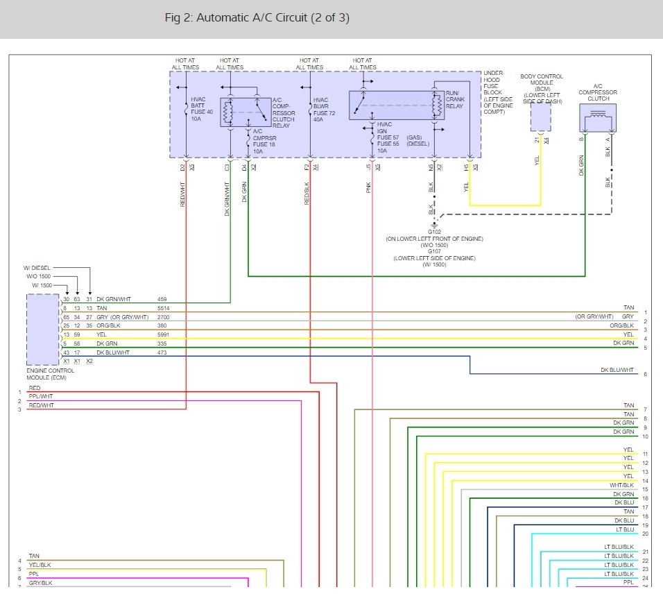

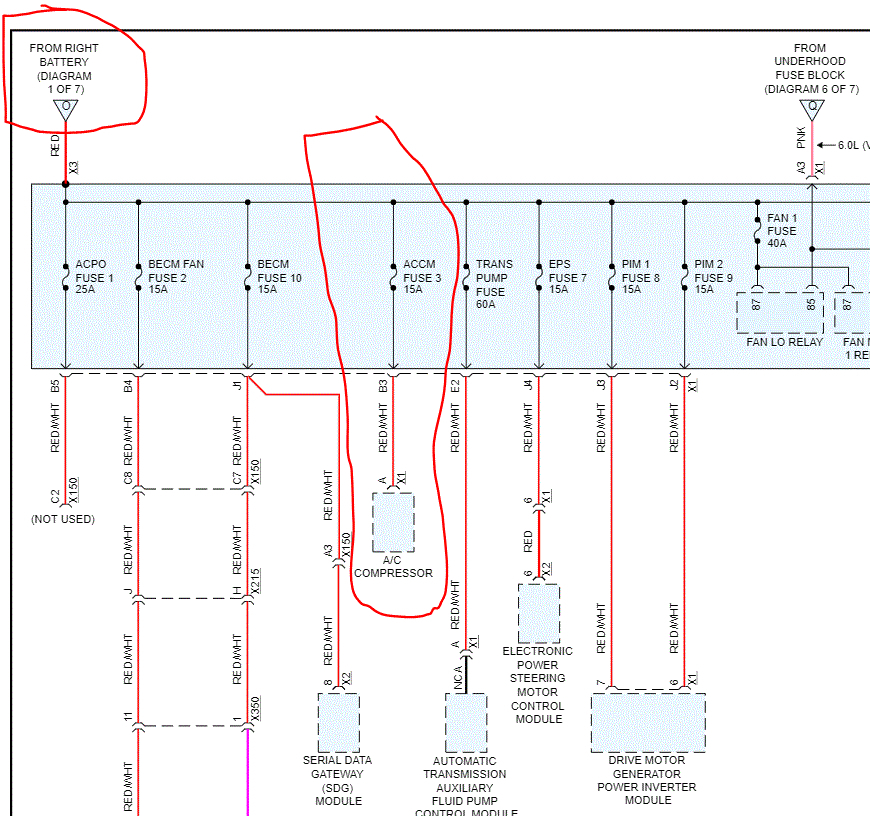

The low pressure switch is on the accumulator. See pic 1. If you look at pic 2, it shows the fuse for the AC compressor. Is there power to any of the fuses near it? I ask because power to that circuit is right from the battery. See pic 3.

Check out the diagrams (Below). Let us know what happens and please upload pictures or videos of the problem.

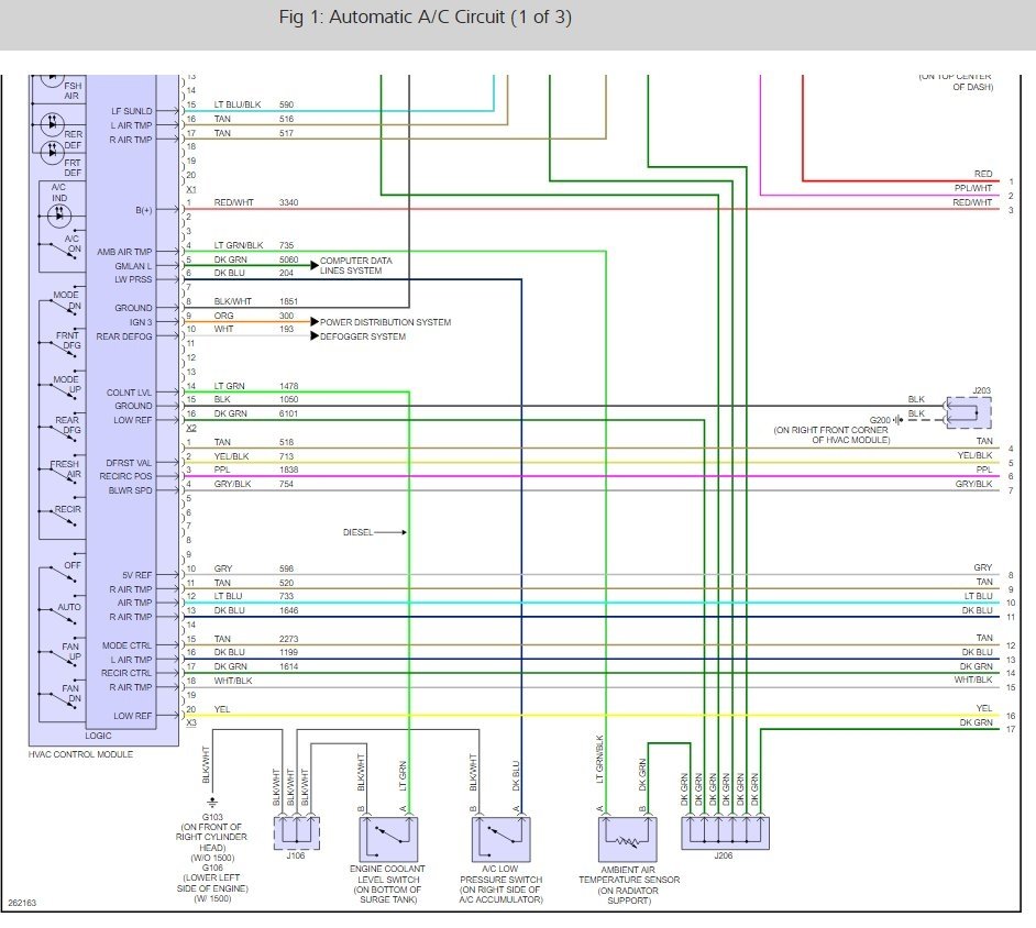

Hi Joe. yes, there is power all around the fuse and on my 2013 the low pressure switch is not on the accumulator. any other ideas where it might be? it's a GMC Sierra 4x4 LST.
Jul 14, 2020 at 11:44 PM
  • 110,244 POSTS

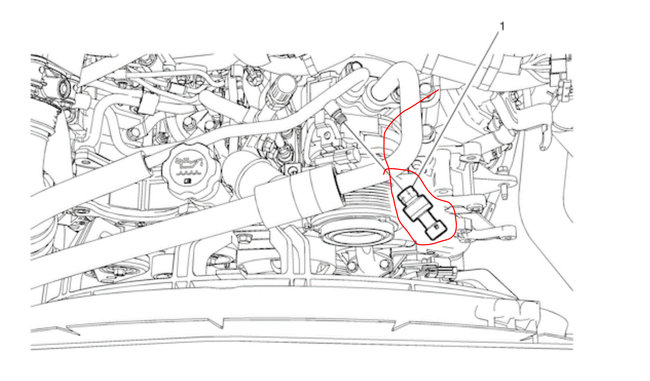

I attached three pics below. This is all there is for this vehicle. If the pressure switch isn't on one of the locations, let me know.

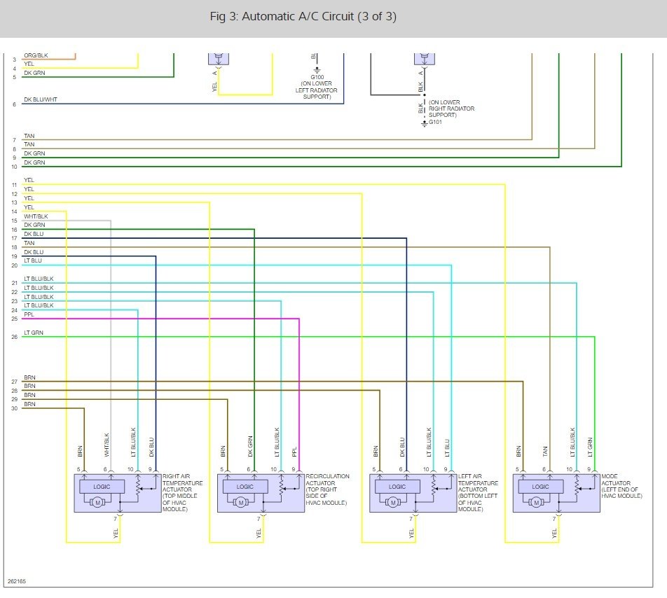

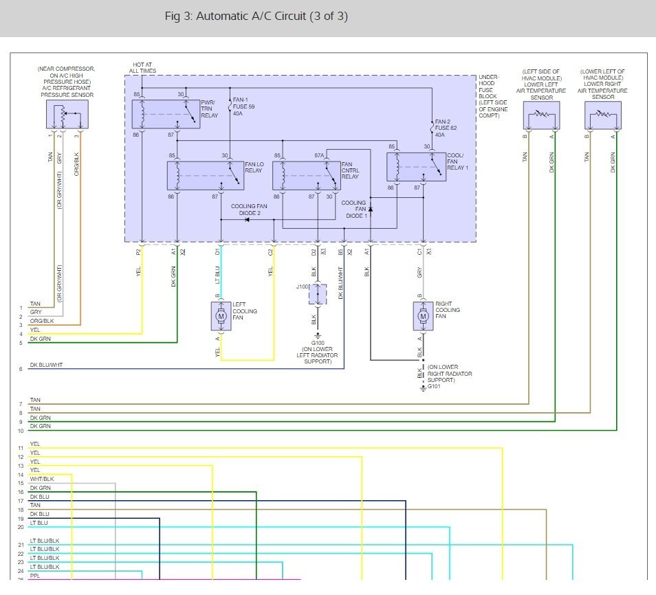

i changed the left blend door (bottom center actuator) now the compressor will not run. I can trip the clutch relay and it runs and gets cold.the refrigerant press s/w shows 1.3 volts the accumulator press s/w is made .there is no ground signal to clutch relay.
the vents have warm air once the engine warms up. A/C is charged. it use to blow cold until the left blend door would act up , then turning the ignition off and on would reset it. I have done the fuse remove reset. no change.

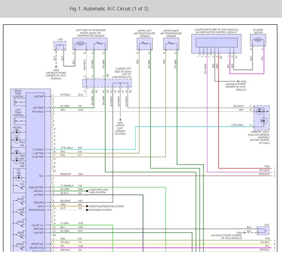

Something must have happened to the controller or compressor relay. Here is a wiring diagrams (below) and a guide to help you do some testing.
and
See if the unit is getting power and that the relay is working and check the fuses
Please run some tests and get back to us so we can continue helping you.

the clutch relay works, it dosent get a grnd. sig from the computer. what should the return voltage be at the refrigerant
press. switch . it gets the 5v looks like it returns 1.3v and the ground is good.

Try to use a jumper on the pressure switch connector to see if the compressor turns on.
