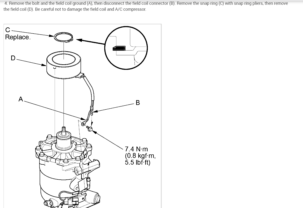

Hello! My AC seems to be going in and out. The blower keeps going but the air will be cold here and there, and then the same temp as the outside air for a while. It has been going in and out like that for a few days.

It sounds like you are low on a refrigerant charge.

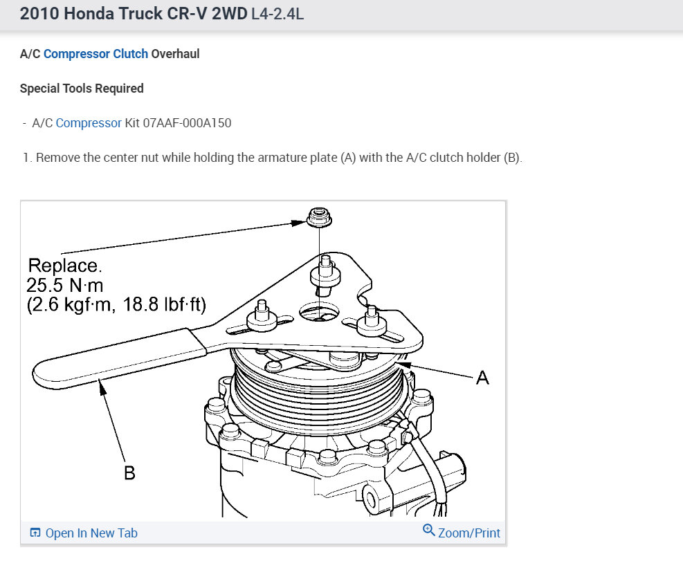

Thanks! My pressures are reading about where they should (50, 140). The A/C seems to not be coming on at all anymore. The clutch fuse is good and the clutch relay seems okay (I swapped it another and didn't notice a change.) The A/C fan is spinning it doesn't sound like the clutch is engaging, at least I don't hear the click I used to when it kicked on. Any ideas of what may be happening?
May 12, 2023 at 6:22 AM
  • 55,721 POSTS

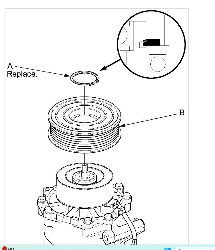

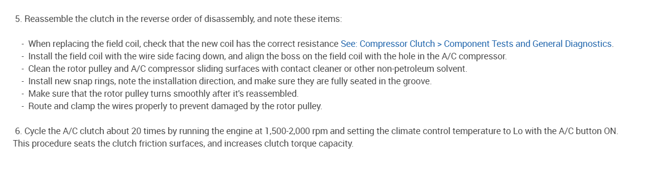

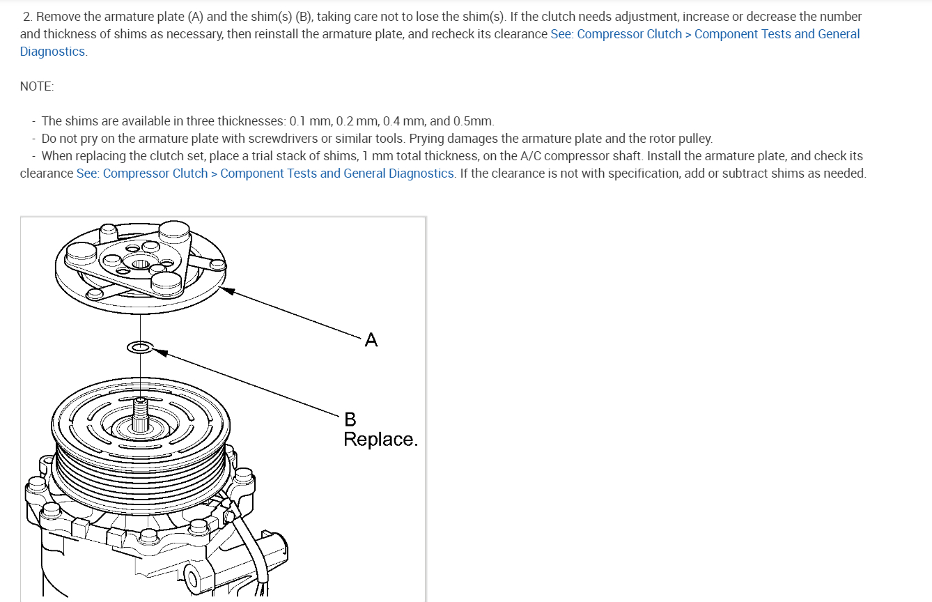

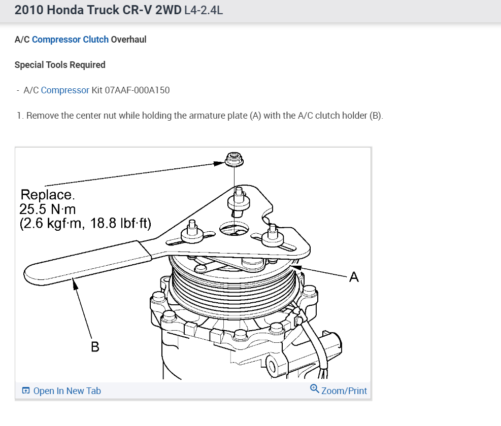

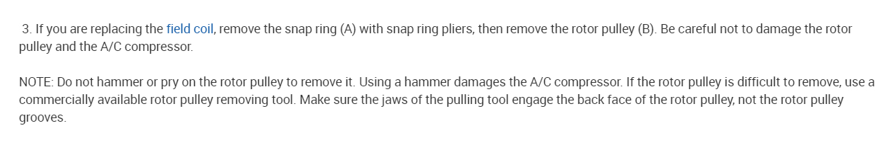

Yes, it sounds like the clutch coil went bad but to confirm it lets use a test light at the power wire to the compressor clutch. Here is a guide to help and I have included how to change the clutch coil out in case you need it. You will need to discharge and recharge the system.
and
https://youtu.be/4EqdrBVb0sY
May 13, 2023 at 3:13 AM

Thanks Ken! I’ll check that power connection. The A/C was in and out a couple of days ago and worked all day yesterday. Would a bad coil work intermittently like that?
