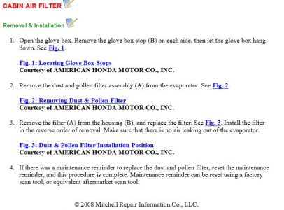

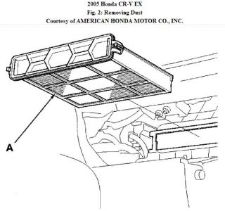

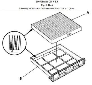

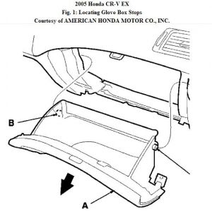

How do you replace the air conditioning filter?
Monday, April 6th, 2009 AT 4:59 PM
KHLOW2008
MECHANIC
41,814 POSTS
Hi genegomez,
Here are the procedures.
