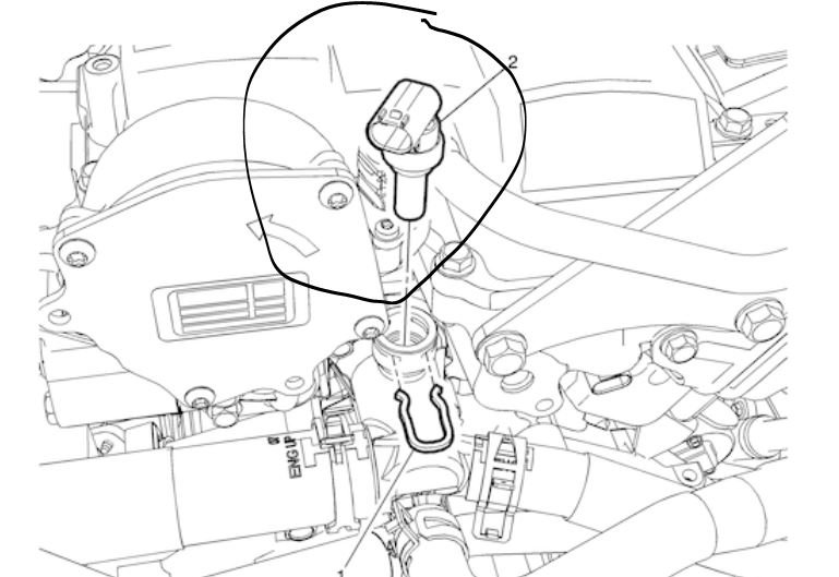

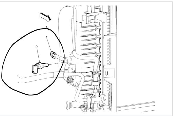

I changed the sensor on the radiator, i put a new thermostat unit on it which had new sensor in it, that seemed to be where every thing pointed me. but it still wont work, and same message. My d=fan starts running the moment i turn car on, and it stays running even if i drive for 2 minutes, after i turn car off. what other sensors could it be? i got a readout and it states that engine coolant temperature circuit intermittent/erratic. what needs to be replaced to fix that issue? i believe that is what is stopping air from working.

There are two different temperature sensors on this vehicle. Picture 2 below shows the one on the radiator, which I believe is the one you replaced. Picture 1 shows the one on the thermostat housing. That is why I need to know the code you got.

yes i will i also changed the thermostat housing unti too, so both those sensors are new but my fan still runs right away when i start it and it stays running after i turn it off even if i drive for 2 minutes i got a bunch of them but any to do with coolant were

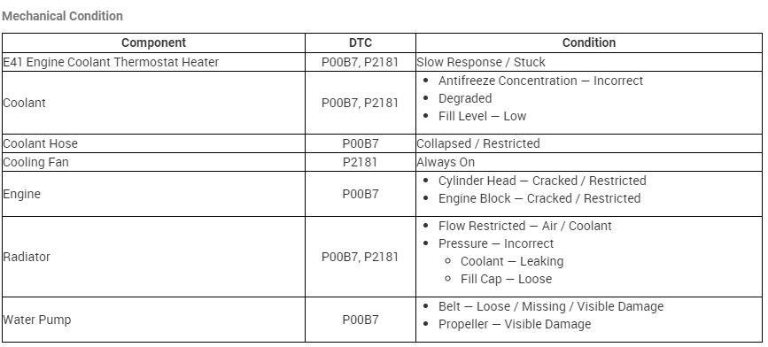

P00B7 engine coolant flow low/performance
i had 3 that said that all p00b7
then there was a P0119 engine coolant temp curcuit intermittent/erratic
all other things were to do with 02 sensor i figured it was the one that was erratic

That code (P00B7) is related to the thermostat itself. The thermostat has a build-in heating resistor. When the resistor heats up, the thermostat opens more, resulting in a lower engine operating temperature. That could be causing the fan to run all the time. However, there are mechanical things to check also.
Take a look at the picture I attached. It lists what to check with this code.
Let me know if this helps.
