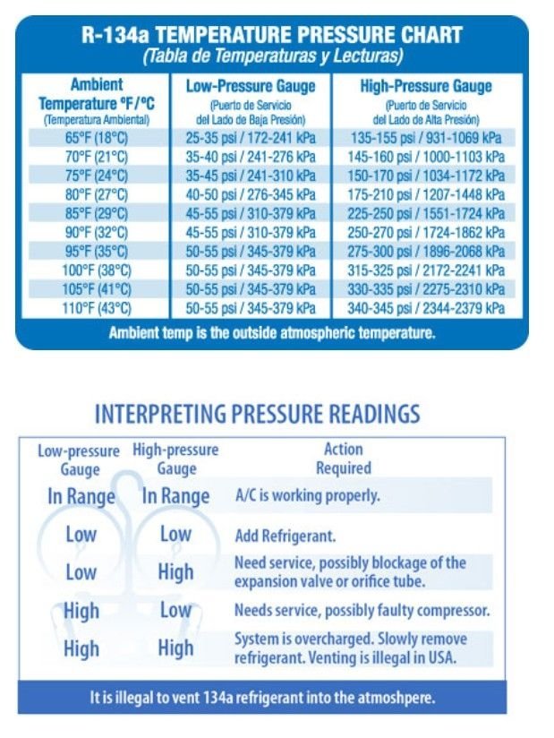

Okay, you have a very low charge. You should see a pressure like those in the chart with the compressor working. Static pressures should be slightly higher than the temperature when you are testing, So if it's say 75 degrees you should see a static pressure around 78 PSI. That would be with the compressor off. If it's 90 degrees it would be about 95 PSI.
Jan 2, 2021 at 11:28 AM

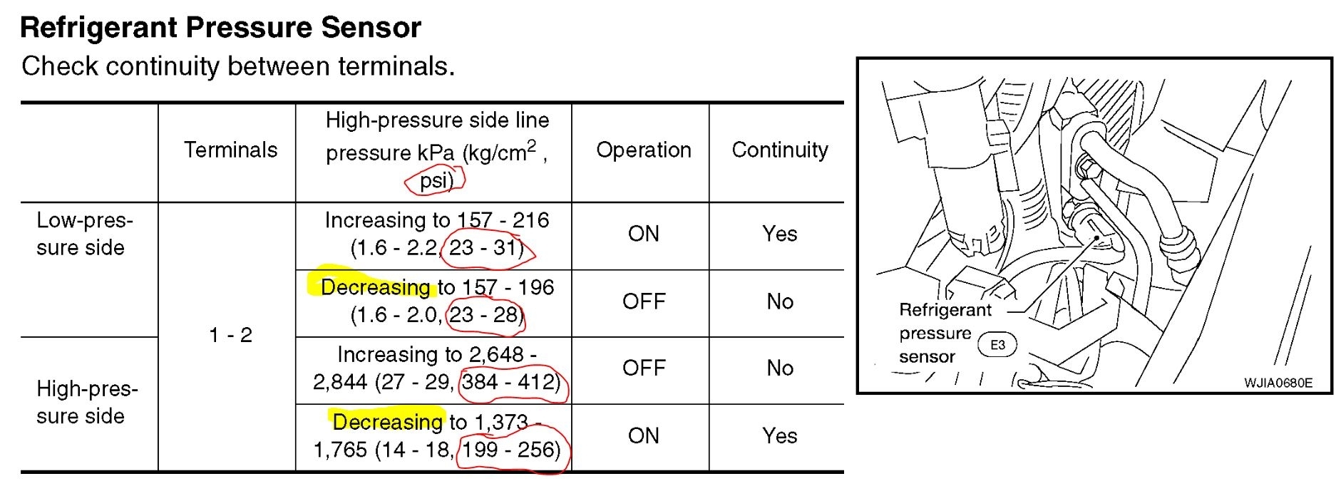

For 80 that's about 15 PSI high and could be the issue if the high pressure cut out is a bit aged. The only way to know for sure would be to run it until it shuts off and then see what the pressures are when it shuts down. Attached are the numbers the switch should operate at. The increasing numbers are where the switch cycles So on the low side the switch turns on at a pressure higher than about 25 PSI and off at about the same The high side will shut off the A/C at a pressure above about 400 PSI and as the pressure drops it turns back on between 200-250. So a weak switch could easily be turning the system off at 350 or so, and it comes back when it drops back below that. But I would check the pressures simply because running them high can easily damage the system.

Okay, thanks! I will get the guages again because it will be good to know. Are you thinking maybe the electrical component of the switch, or likely a sensor replacement that will require another vacuum of the system?

I would check the pressures first, it may be that they just need to be lowered a bit to make it work properly. There is also the possibility that it was working too well and iced up the evaporator core, that would trigger the temperature sensor on the core to shut it off until it thawed out. I'm leaning more toward the pressure switch but want you to know the other items that could act that way.

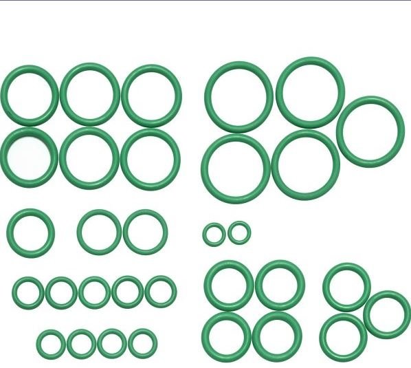

That makes a lot of sense. Wish me luck in finding the leak! I am assuming that there are special o-rings for resistance to the chemicals in refrigerant.
Jan 9, 2021 at 12:38 PM
STEVE W.
  • 15,295 POSTS
Yes, but you can usually get kits that include all of the needed ones for a particular vehicle. This is a picture of the kit they sell for your Nissan, lot's of places that can leak. Plus the compressor and other hard parts. It's why I would start with the dye first and then go hunting. Another trick to finding the leak, use compressed air or similar to pressurize the system, then mix up some dish soap and water and spray it all over the parts and look for the bubbles.
