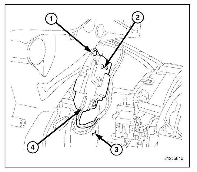

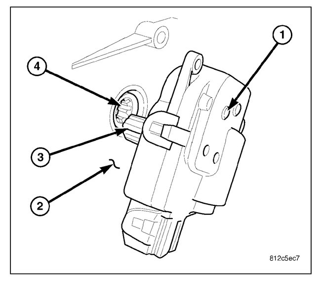

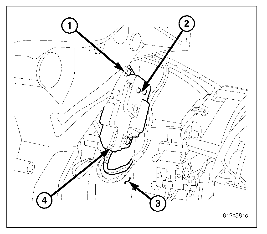

As far as the interior, it sounds like the blend air door actuator for the passenger side isn't working. Here is a link that shows how one is replaced:
Here are the directions specific to your vehicle for replacing the actuator for the right side. The attached pics correlate with the directions.
DUAL ZONE PASSENGER SIDE
REMOVAL
Warning: on vehicles equipped with airbags, disable the airbag system before attempting any steering wheel, steering column, or instrument panel component diagnosis or service. Disconnect and isolate the negative battery (ground) cable, then wait two minutes for the airbag system capacitor to discharge before performing further diagnosis or service. This is the only sure way to disable the airbag system. Failure to take the proper precautions could result in accidental airbag deployment and possible personal injury or death.. See: Air Bag(s) Arming and Disarming > Service and Repair
NOTE: The single zone heater-A/C system is equipped with a single blend door actuator. The dual zone system has two blend door actuators, one for the driver side blend-air door and one for the passenger side blend-air door.
pic 1
1. Disconnect and isolate the negative battery cable. See: Battery Cable > Service and Repair
2. Remove the glove box from the instrument panel. See: Glove Compartment > Service and Repair
3. Remove the three screws (1) that secure the blend door actuator (2) to the passenger side of the HVAC air distribution housing (3).
4. Remove the blend door actuator from the air distribution housing and disconnect the HVAC wire harness connector (4) from the actuator.
5. Remove the blend door actuator from the vehicle.
INSTALLATION
pic 2
1. Position the blend door actuator (1) into the vehicle.
2. Install the blend door actuator onto the passenger side of the HVAC air distribution housing (2). If necessary, rotate the actuator slightly to align the splines on the actuator output shaft (3) with those on the blend door cam (4).
pic 3
3. Install the screws (1) that secure the blend door actuator (2) to the passenger side of the air distribution housing (3). Tighten the screws to 2 N.m (17 in.lbs.).
4. Connect the HVAC wire harness connector (4) to the blend door actuator.
5. Install the glove box into the instrument panel
6. Reconnect the negative battery cable.
Jul 12, 2019 at 9:35 PM
MELVIN KINCHEON

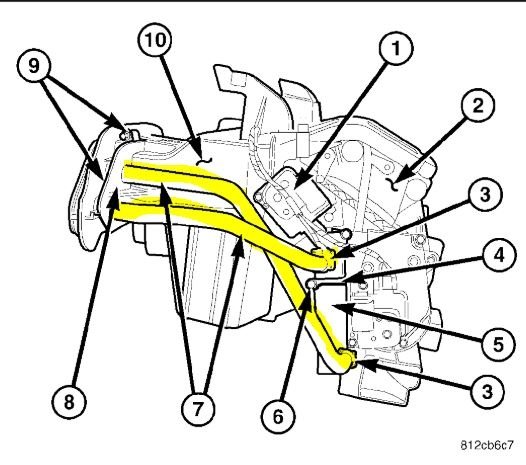

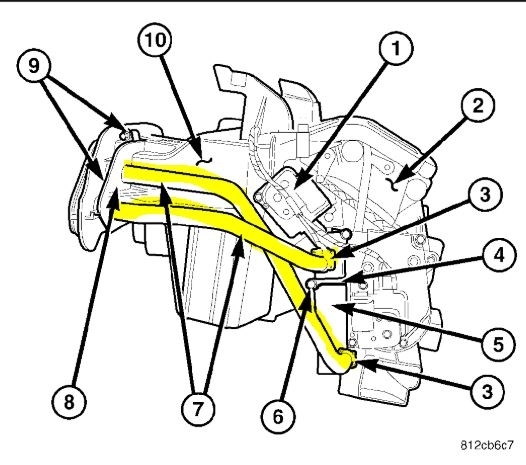

Very very good information but it didn't fi4my problem. Actuators are working good opening and closing the doors but the two silver pipes under the steering wheel driver side are very very hot not for sure why. They are coming from under the hood going into the system. I am trying to get some upgraded gauges to check the high and low pressure.
Jul 16, 2019 at 1:37 PM
  • 110,194 POSTS
Welcome back:
Honestly, the best way to know what is happening with the AC is by knowing both high and low pressures. So, I think you have a good idea.
As far as the pipes you referred to, I believe they are the heater core tubes. I attached a pic of what I believe to be what you are referring to. I highlighted the tubes. Are those the tubes you are referring to? If so, it's normal for them to be hot because engine coolant is running through them.
Let me know. Also, let me know if you have other questions.
