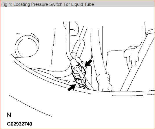

Dose my truck have a low press sensor? I do not see one anywhere.

Are you asking if there is a system cut-off switch? There is a compressor cut-off switch that will shut the A/C system off when it is detected the system is low on refrigerant. It does this to keep the A/C compressor from cycling to keep from causing damage. After the system is recharged to proper specifications the system will work again. Hope this helps and feel free to ask any further questions. Danny-

Advice was helpful. Can you tell me where the cut off switch is located?

Here is a picture attached (underhood passenger side). Hope this helps! Thanks again for using 2CarPros and let me know if you have any other questions!
