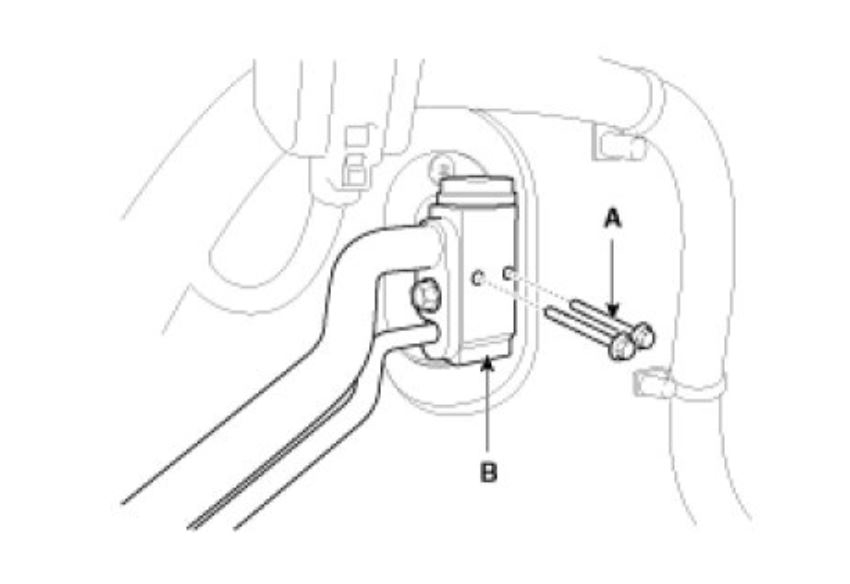

Oh, thanks. Can I just discharge it a little bit? The low side?
Btw the car was idle and A/C was on.
Wednesday, August 14th, 2019 AT 9:29 AM
  • 52,797 POSTS
No, the valve is stuck open too far. It will not lower the pressure by bleeding it out.
You need to replace it.
Wednesday, August 14th, 2019 AT 9:32 AM
BAKHTIAR DUSKY
  • 96 POSTS
Oh I see, but replace what?
Wednesday, August 14th, 2019 AT 9:38 AM
  • 52,797 POSTS
Expansion valve.
Wednesday, August 14th, 2019 AT 9:41 AM
BAKHTIAR DUSKY
  • 96 POSTS
So from what I understand the problem is not because the low side has high pressure but the expansion valve is not working probably right?
Wednesday, August 14th, 2019 AT 9:48 AM
  • 52,797 POSTS
The high side pressure is too high and the reason is that the expansion valve is bad. After you replace the expansion valve and dryer, evacuate the system and charge it, the pressure should be 25-30 lbs.
Wednesday, August 14th, 2019 AT 12:18 PM

Oh okay, and is that expansion valve picture? That is under dashboard right?
Friday, October 11th, 2019 AT 11:33 AM
  • 52,797 POSTS
No, under the hood by the firewall.
Friday, October 11th, 2019 AT 11:55 AM
