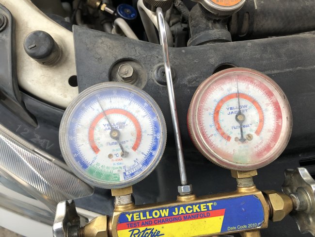

Oh, thanks. can i just discharge it a little bit? The low side?
Btw the car was idle and A/C was on.
Aug 14, 2019 at 2:29 AM
No, the valve is stuck open too far. It will not lower the pressure by bleeding it out.
You need to replace it.

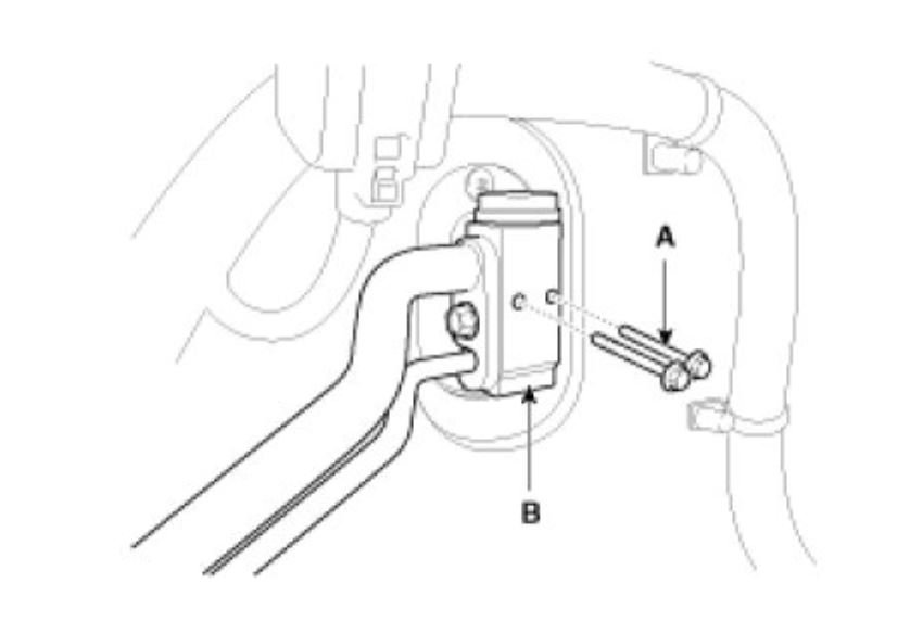

Oh i see, but replace what?
Aug 14, 2019 at 2:38 AM
Expansion valve.

So from what I understand the problem is not because the low side has high pressure but the expansion valve is not working probably right?
Aug 14, 2019 at 2:48 AM
The high side pressure is too high and the reason is that the expansion valve is bad. After you replace the expansion valve and dryer, evacuate the system and charge it, the pressure should be 25-30 lbs.

Oh okay, and is that expansion valve picture? That is under dashboard right?
Oct 11, 2019 at 4:33 AM
No, under the hood by the firewall.

Tested again. the Low and high Pressure at 2,000 rpm's after the leak the Low was 20 psi and the high was 125 psi.
Oct 13, 2019 at 4:52 PM
Again, it does not matter. You have a bad expansion valve. It should never change pressure reading whether at idle, 2.000 RPM's or any other time.
