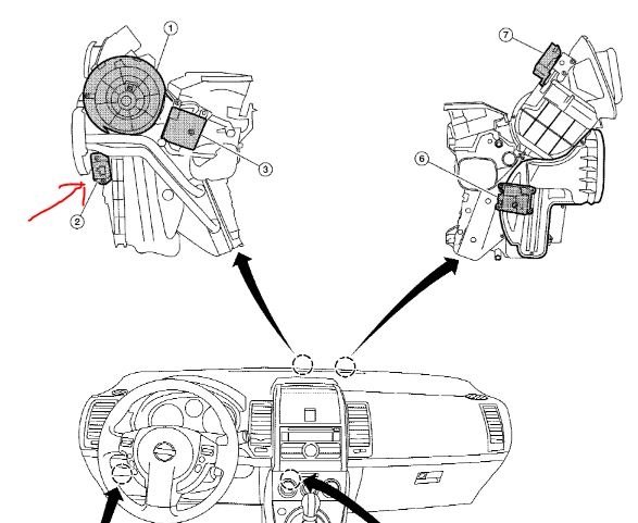

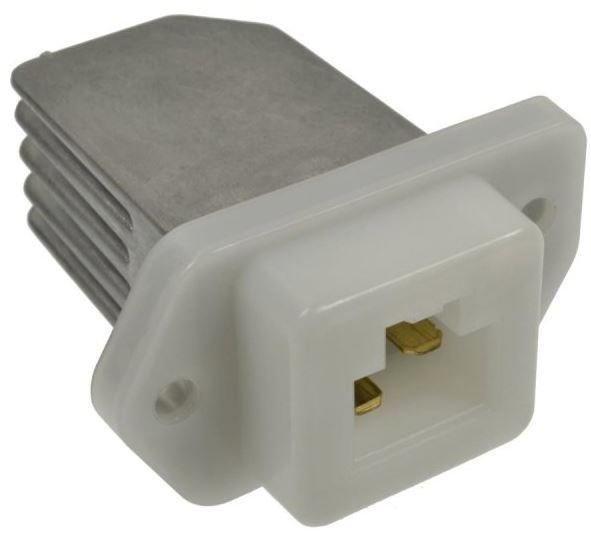

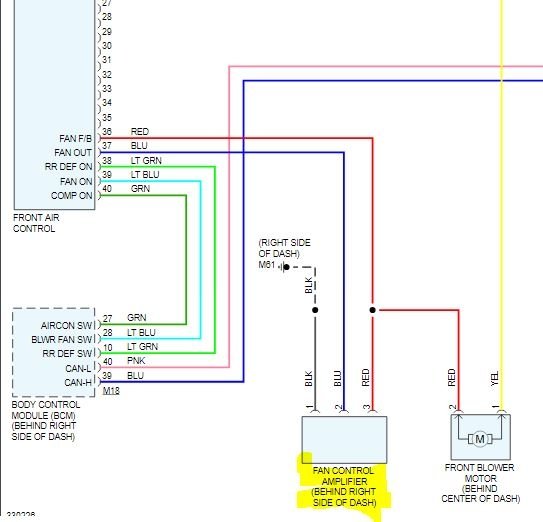

The motor doesn't send a signal back to the control head per say, the head sends out a pulsed ground and reads the amount of amperage to determine if the fan is responding. The blower motor really can't stick on high as it doesn't have that ability, It is just the two wires that powers the motor. The power feed comes through the fan relay and it is on all the time if the key is on. The ground goes to 2 places, one of them is staying on full time which causes the fan to run only on high. Those are the main control head and the fan control amplifier.
The amplifier is the item in the second picture tagged as 2 with the red line pointer and the third image. If that is the part you changed, and with it unplugged the fan still runs only on high the issue is something in the control head in the dash. Either the ground wire to the motor has a short which would make it stay on high or the controller in the dash has a problem. To look for a shorted wire isn't hard, unplug the connector to the control amplifier, then the one that goes to the front air conditioning control in the dash. If you turn the key on and the blower comes on, the wire is shorted, however yo mentioned that with the control amplifier unplugged the blower didn't work so it shouldn't be a short.

The marked item and the third picture was replaced. When that is unplugged the fan does nothing. He took it to the dealer and they mentioned replacing this part which we have done then their second guess was the blower noted itself. So it sounds like it has to be the control in the dash. We bought one off of eBay but when we plugged that one in we still have the same issue. Is it possible we just received another bad control?
