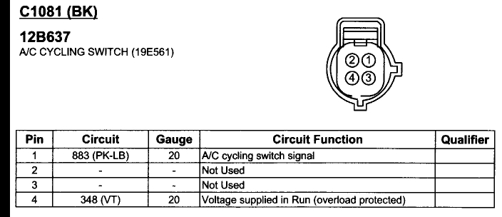

i forgot to mention, the first thing i tried was shorting the connector for the low pressure switch, it has three pins and the high has three pins, i tried all combinations with a paperclip on the low and nothing happened.

Forgot to add image. four pin connector. Also if the switch is not on drier it will be on the low pressure hose. Pink with light blue stripe wire and other wire is violet.

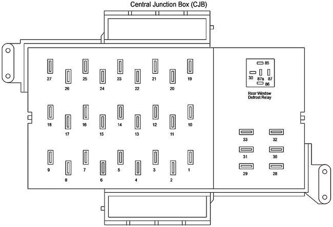

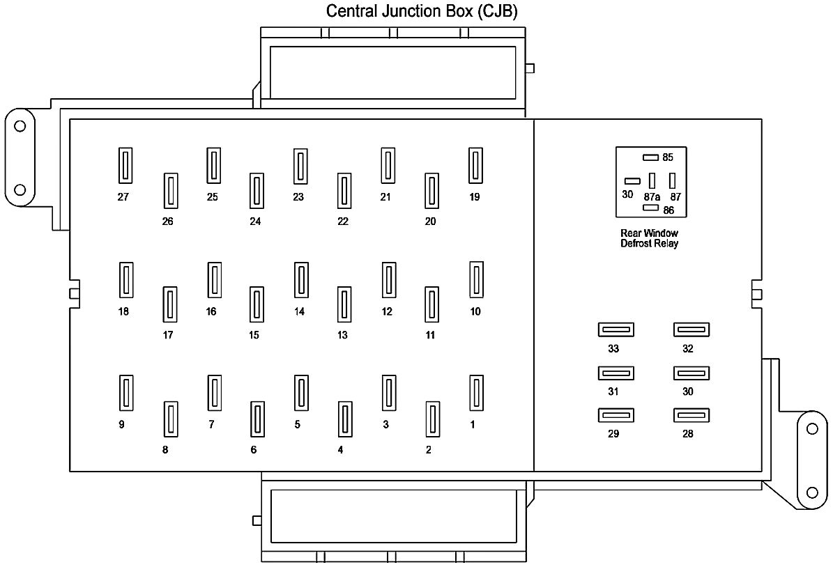

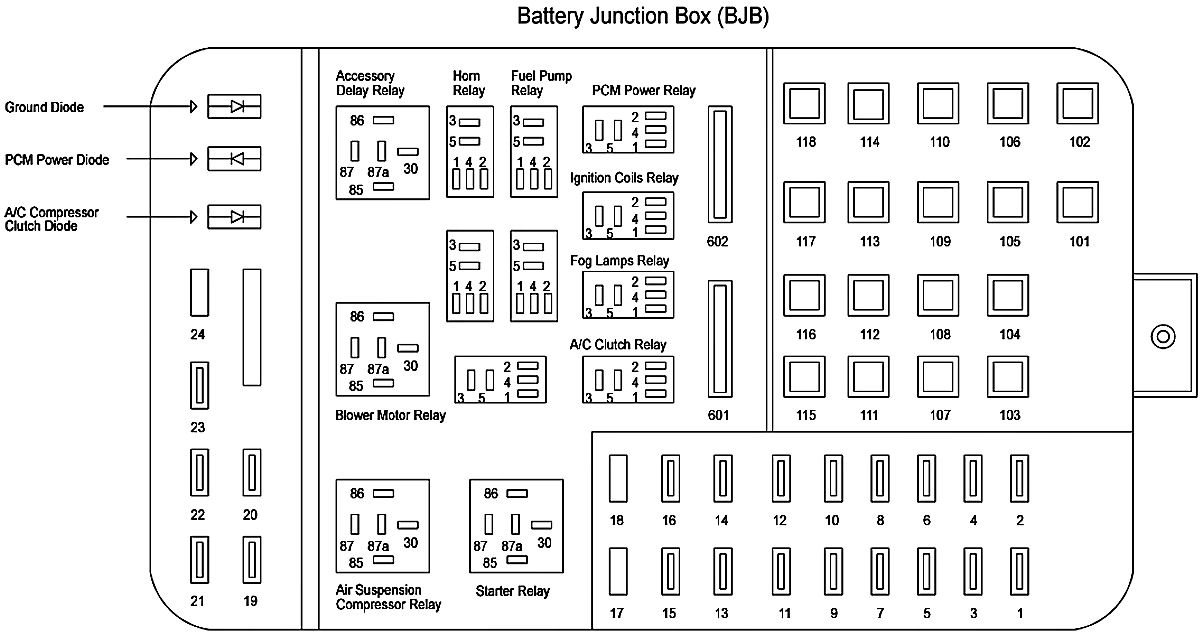

Check fuse 11 15 AMP in engine compartment and fuse 31 10 AMPS inside vehicle fuse box. If okay then you will need an advance scanner to look at data and see if the PCM is getting AC request from the climate head and to see if you can command the A/C clutch relay on and off with the scan tool. Once the PCM receives the AC request the the PCM grounds the relay so you could have an issue any where from the wiring to a faulty PCM. Also low refrigerant level will cause the PCM not to ground the relay. System needs to be evacuated to weigh the refrigerant so this can be something simple as a top off?

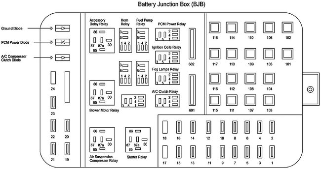

i checked the fuses, they are all good, i tried swapping the diode, a friend of mine has a town car with working AC so i am not wasting money buying parts.
the PCM was replaced with one that was fully tested from another issue that the car had.
there is a ground diode i didn't touch because i am not sure it has anything to do with the AC.
