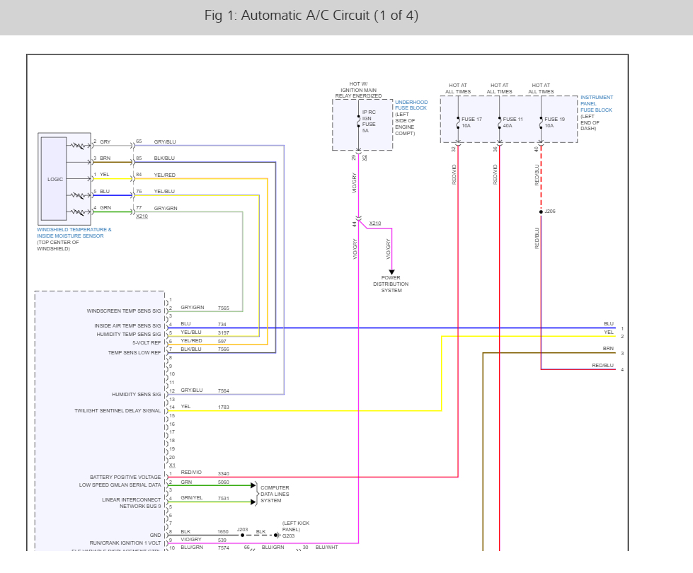

A/C control has no power
100,000 MILES • 2.5L • 4 CYL • 2WD • AUTOMATIC
JUNIOR1322
Replaced the relay A/C fuse also replaced the A/C control and still no power.
May 27, 2021 at 12:54 AM
  • 55,740 POSTS

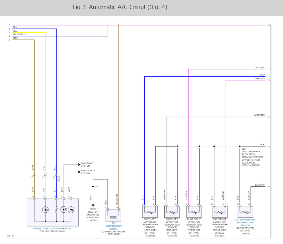

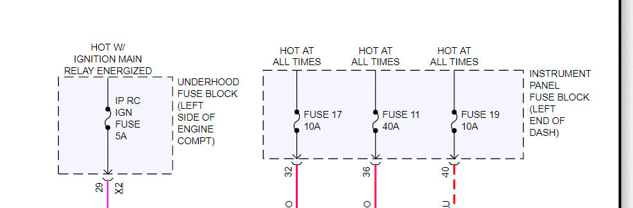

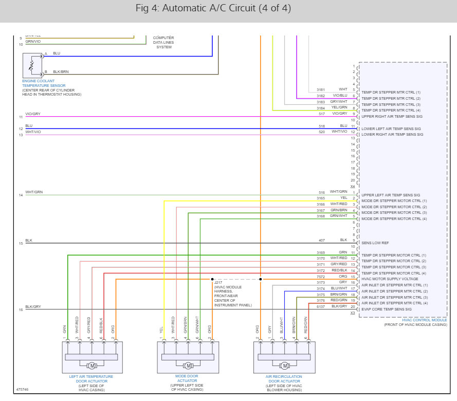

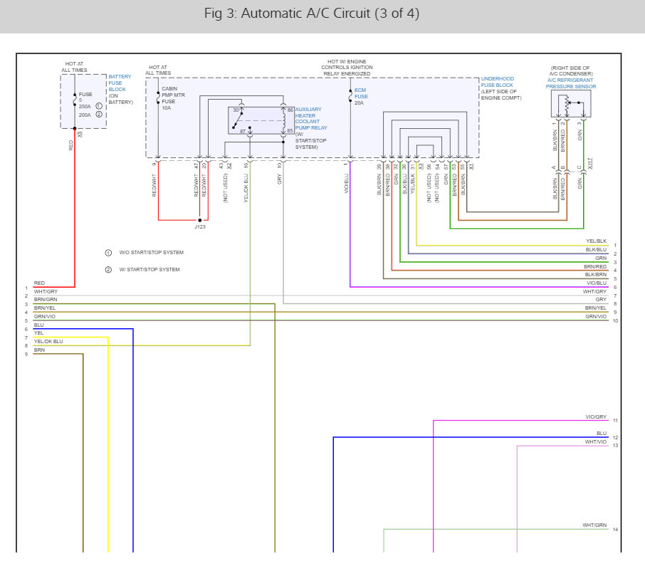

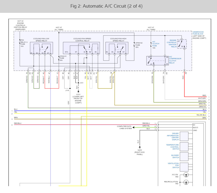

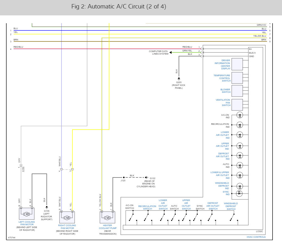

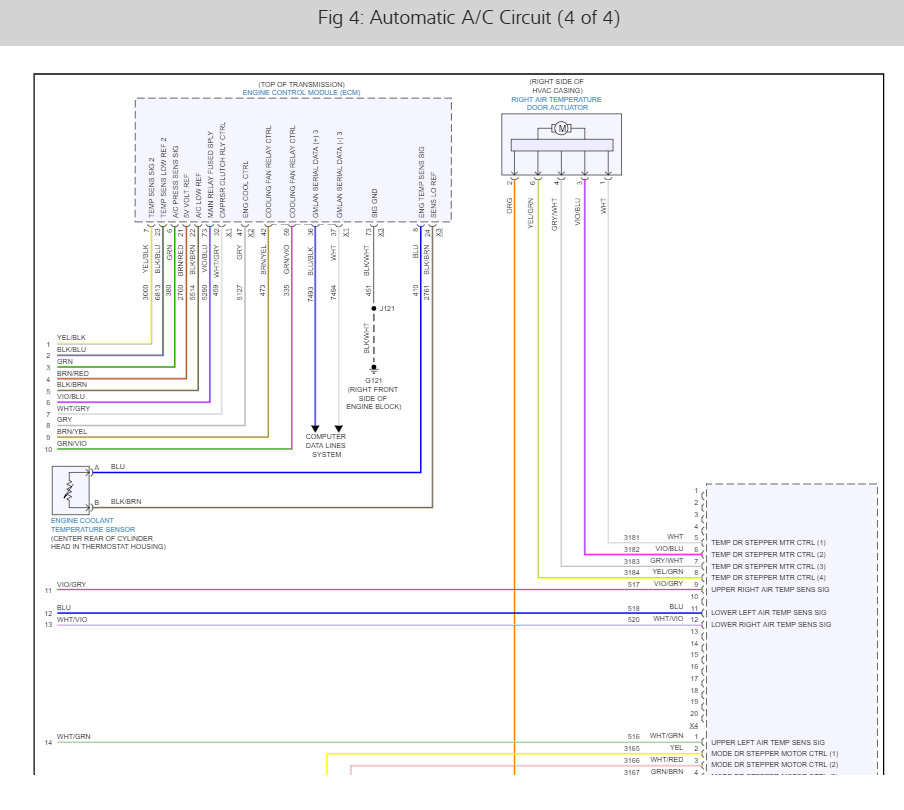

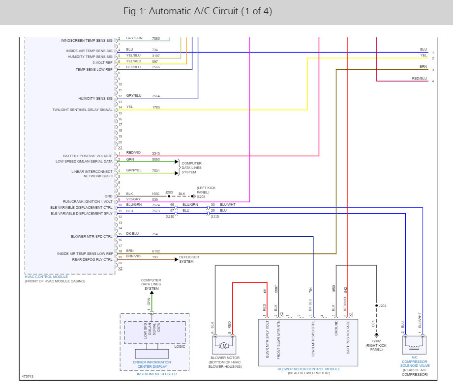

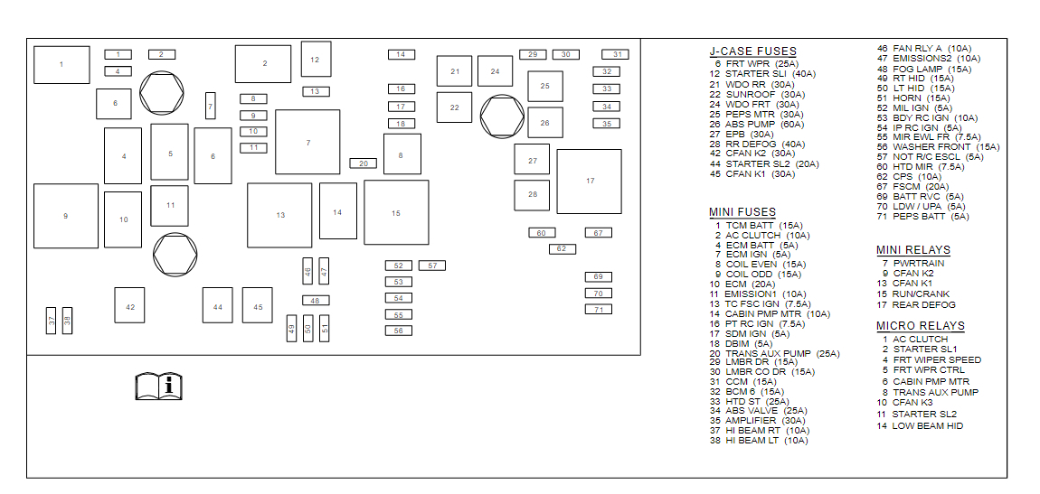

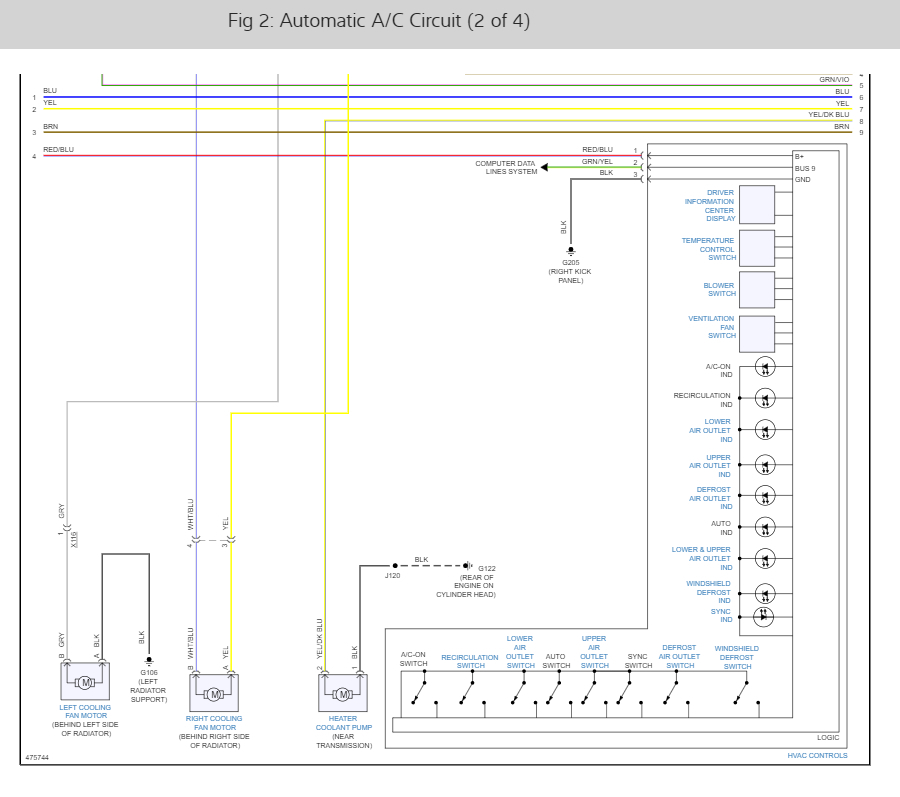

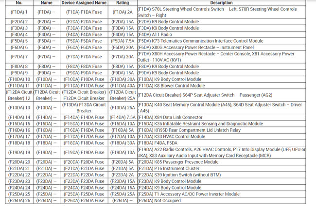

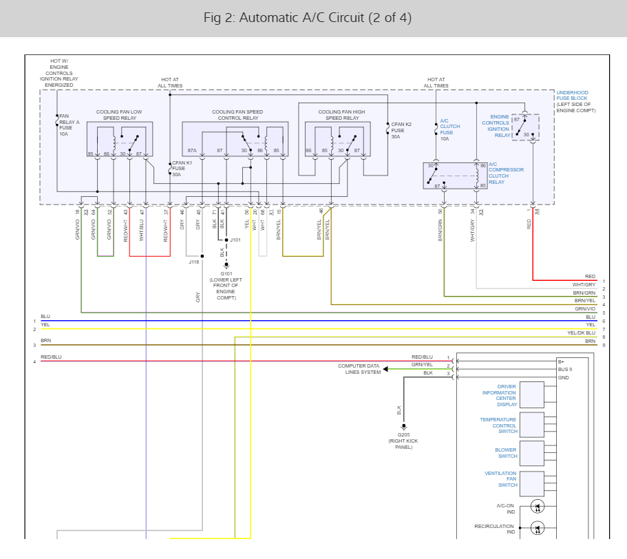

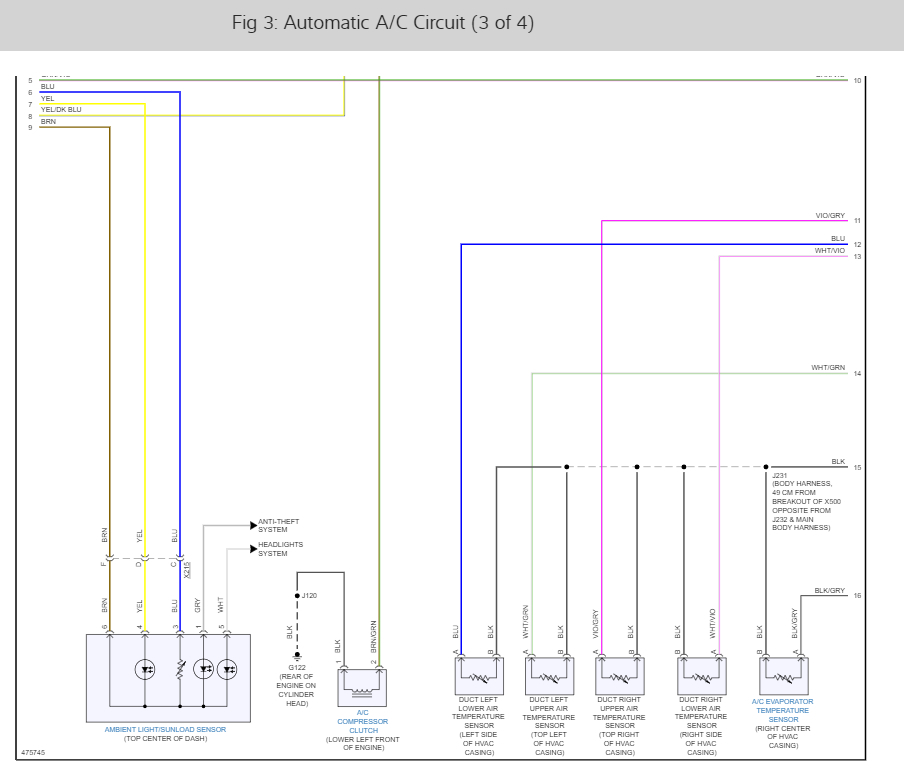

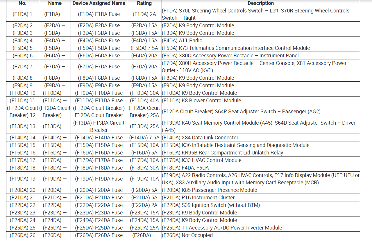

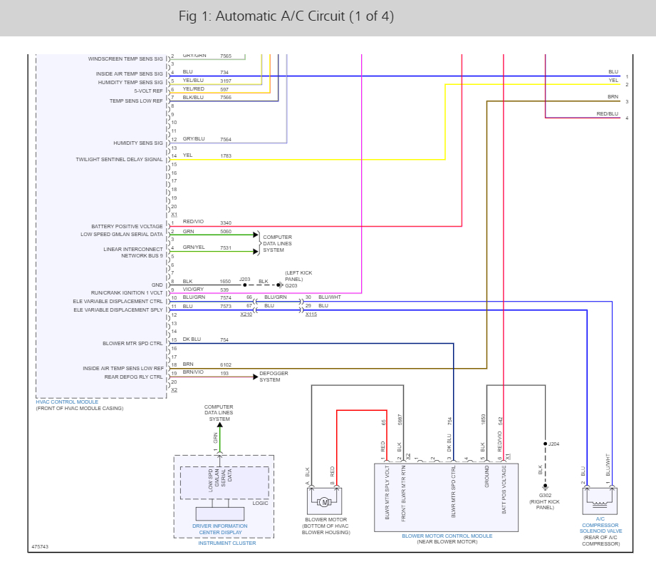

We need to check for power at the fuse (located in the diagrams below). this guide will help. Also I have included the air conditioner wiring diagrams so you can see how the system works and which fuses to check.
May 28, 2021 at 3:27 AM
