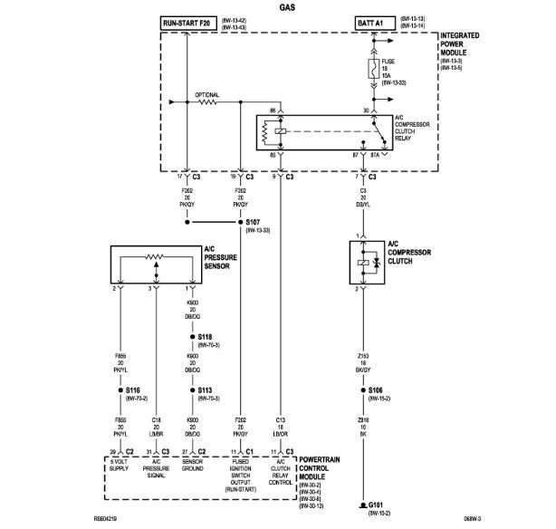

A/C compressor clutch not engaging
130,000 MILES • 3.8L • 6 CYL • 2WD • AUTOMATIC
JOSHUA LEE BARTENHAGEN
The A/C compressor clutch will not engage. It has rear air and there are no visible leaks. I have tried to see if it is getting power and checked relays and fuses looks to be fine but it does not seem to be getting power.
Jul 1, 2018 at 9:45 AM
Good morning.
The first thing you need to check is the Freon. The system needs at least 20 lbs on the low side for the compressor to engage.
Do you have a gauge to check the pressures?
https://www.2carpros.com/articles/air-conditioner-how-to-add-freon
Jul 2, 2018 at 8:24 PM
Yes it has Freon and fuses are good and the relays are good too.
Jul 3, 2018 at 12:10 PM
What are the exact pressures?
