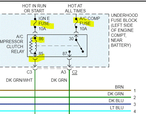

Hey guys, I am having a problem with getting my A/C compressor clutch to engage. I put gauges on the low and high side. Without the compressor running I have 90 on the low and 100 on the high. I jumped the low side switch, and it still did not kick on. I jumped the high side and had the same outcome. I took out the relay and jumped it and it kicked on. I checked the gauges when it kicked on and the low side was around 50 and the high was around 80. I changed out the relay with a relay I know is good to no avail. I checked every fuse in the box under the hood and in the compartment, all good.

With the A/C turned on and running I have 4.5v on the plug for the low-pressure switch. I have not checked the voltage at the high side plug. I know I am getting power to the compressor because it will kick on when I jump the relay 87 to 30.
I am kind of at a loss and any help would be appreciated. I could use a wiring diagram for the A/C system if anyone had one that could help. Thanks.

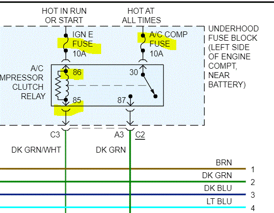

If you can jump 87 and 30, we know power is available. Did you check pins 85 and 86 to make sure one supplies power to trigger the relay and the opposite is providing a ground path? See pic 1. Note: Pin 86 supplies 12v from the ignition E fuse in the under-hood fuse box. Pic 86 is the ground side which provides a ground path via the PCM.
Let me know if you checked that. Also, let me know the outside temperature when you checked pressures and confirm the pressures you mentioned. In addition,
Let me know what you find with the relays and if this has automatic climate control or manual.
See pic below.

Okay, I just tested it. Pin 85 is grounded and pin 86 has 12 volts.
May 2, 2022 at 11:19 AM
  • 110,248 POSTS
Hi Mark, if pin 26 has 12v and pin 85 is ground, then the relay isn't switching on. Have you tried a new relay? Based on your test, pins 87 and 30 should be completed sending power to the compressor. It runs when you jump those two pins, so the same thing should be happening with the relay being powered.

Okay, I moved the truck to the shop and tested it again. 85 is not grounded.
May 5, 2022 at 10:22 AM
  • 110,248 POSTS

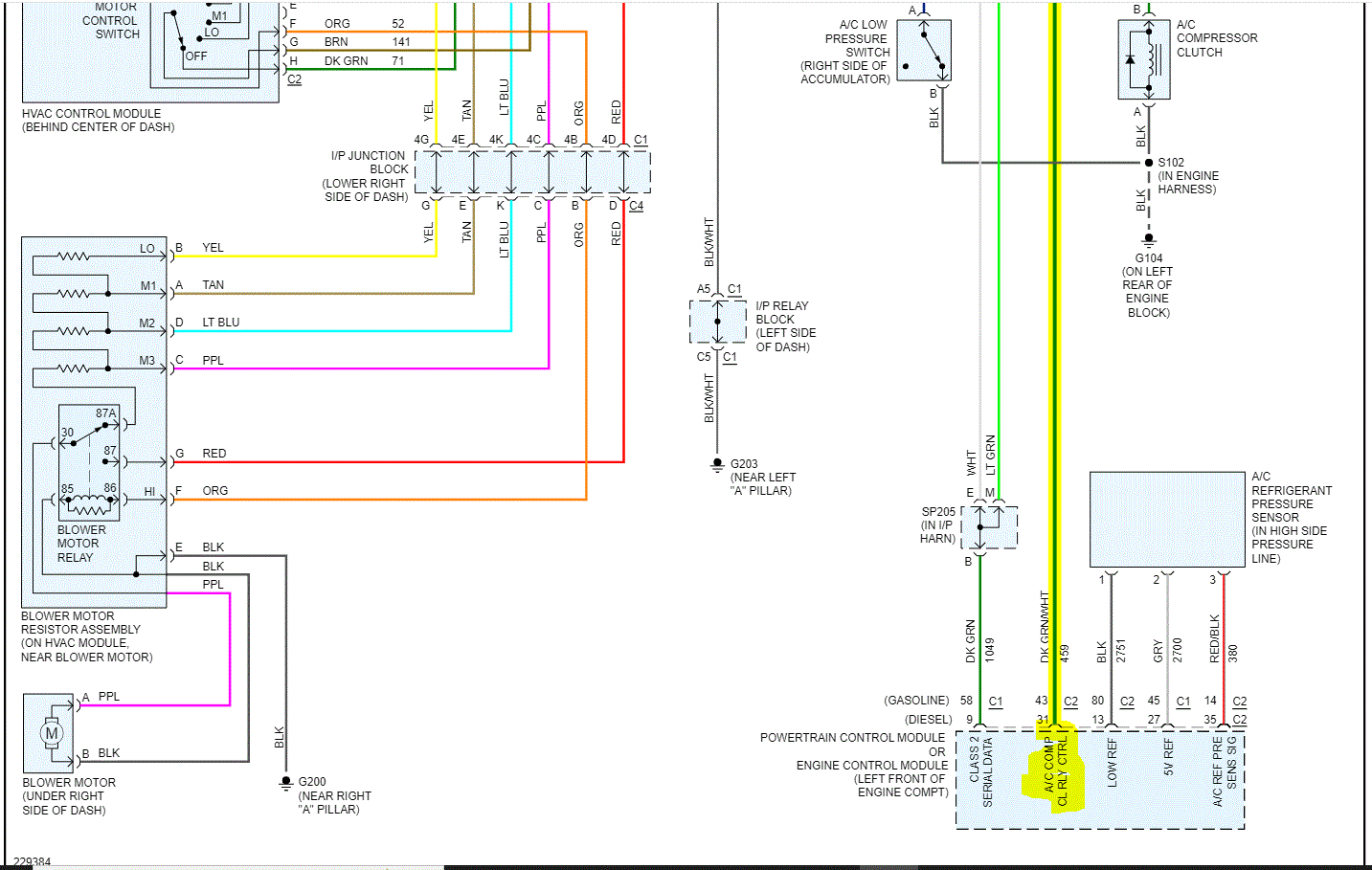

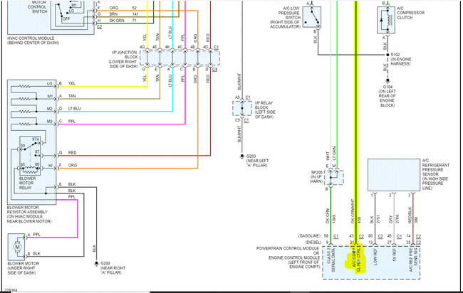

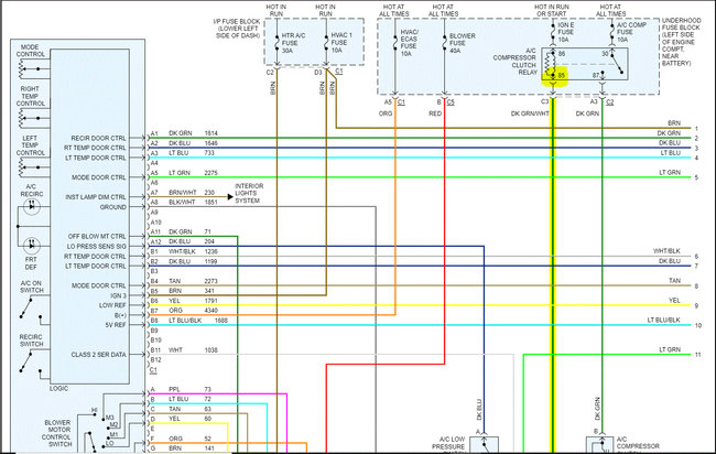

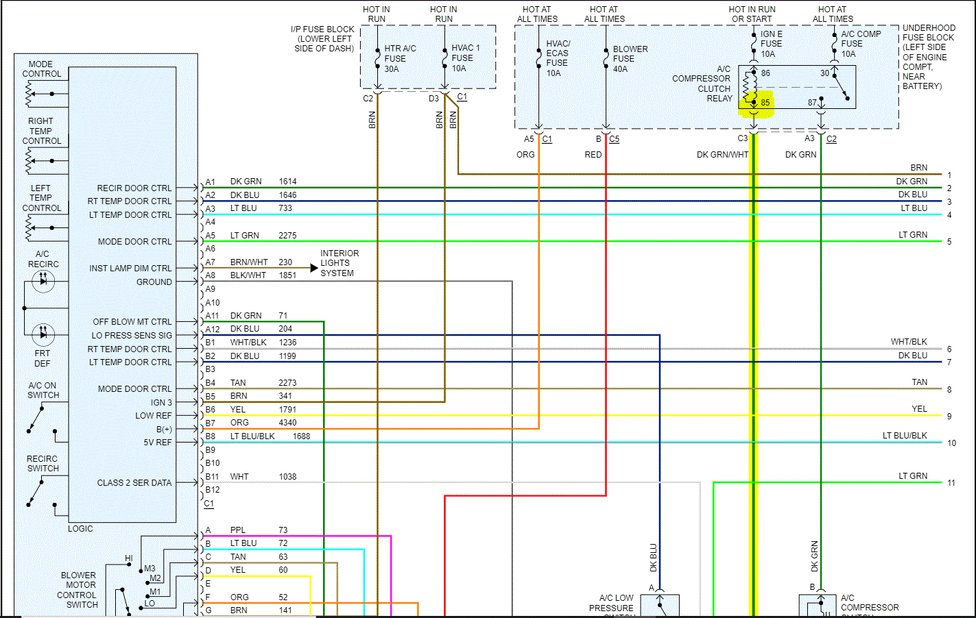

When you checked the ground, did you do it with the key on and the A/C turned on? That ground is a "signal ground" which means the ground path is provided when needed. In this case, it is by the PCM.
Do me a favor. The signal ground is provided by the PCM via a dark green wire with a white stripe. I need you to check the condition of the wire, and connectors, and then test the wire itself for continuity from end to end.
See pics below for the schematic.

I know this has been a long time gap between messages. I am still having the same issue with the truck. I was working on this with Joe before and I ended up getting hit by a guy pulling a trailer and he put the truck out of commission until now. I have checked continuity on pin 85 to the connector at the pcm. The wire is good. I checked the high pressure switch wires with truck running, the ac switch on, and the high pressure switch unplugged. I am not getting any voltage on either wire.
Aug 23, 2025 at 1:22 PM
  • 55,628 POSTS
So the high pressure switch has three wires, do you mean the low pressure switch? The high pressure switch should have 5 volts at the white wire only, while the low pressure switch should have no voltage to either wire. How much residual pressure in the system do you have?
