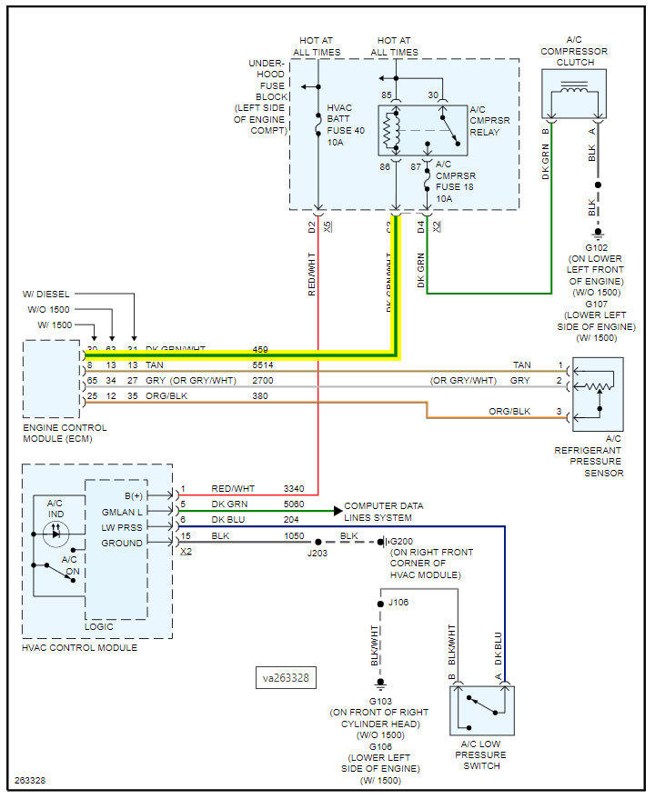

I found where Joe had posted wiring diagrams for a 2008 on this site at: https://www.2carpros.com/questions/a-c-compressor-not-engaging-57604804
and have tried to trouble shoot with no luck.

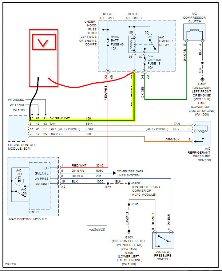

One test that we need to do that will get us on the path we need is to see if the PCM is applying the ground with the A/C is on.
The test you did is not exactly definitive of checking for ground through the PCM because the PCM applies the ground but it is not a direct path so there are times that the PCM does not display continuity to ground but is grounding the relay.
So the way to test this is we need to put your red meter lead on battery positive and the black lead of your meter on pin 86 of the relay with it removed and then turn the engine and A/C on. Your meter should read 12 volts.
Theoretically this should show the same as the continuity test but I have been burned by trusting just continuity on other PCMs but this way is definitive.
If that does not show 12 volts then the PCM is not commanding the clutch on. This is either due to a PCM issue or other input that is telling the PCM to not turn the clutch on.
Let us know what you find. I attached the wiring diagram below.

So the next test is to do what is called a voltage drop on just the wire.

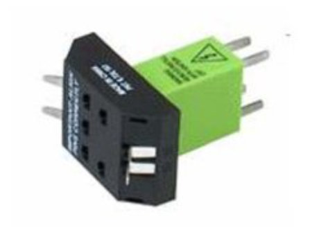

So put the relay back in and we need to back probe the connector on the fuse box (so you will have to take it loose and try to get enough slack in the harness to flip it over or turn it). Or you will need to install a jumper in the relay that will give you access to the pins with the relay installed. They sell these at most parts stores.
Then back probe the connector on this wire at the PCM. Turn the AC on and see what the voltage is on this wire. The normal scenario for any circuit is the load uses all the voltage except for what is needed to complete the circuit back to ground. So on a typical 12.6 volt circuit, the load will take about 12-12.2 volts and the remaining voltage will be used by the wiring and circuit boards to return it to ground.
In this case, if you have 14 volts coming into this relay, I would expect to see less then a half volt on this wire. If the wire is the only issue then you will see all but what the circuit board of the PCM requires which would most likely not be measurable. This means you would have about 4 volts on this wire.
I doubt that is the issue because I don't think a wire with that much resistance would still be intact. Which means I think you have a PCM issue.
Take a look at the wiring diagram below for detail on this.

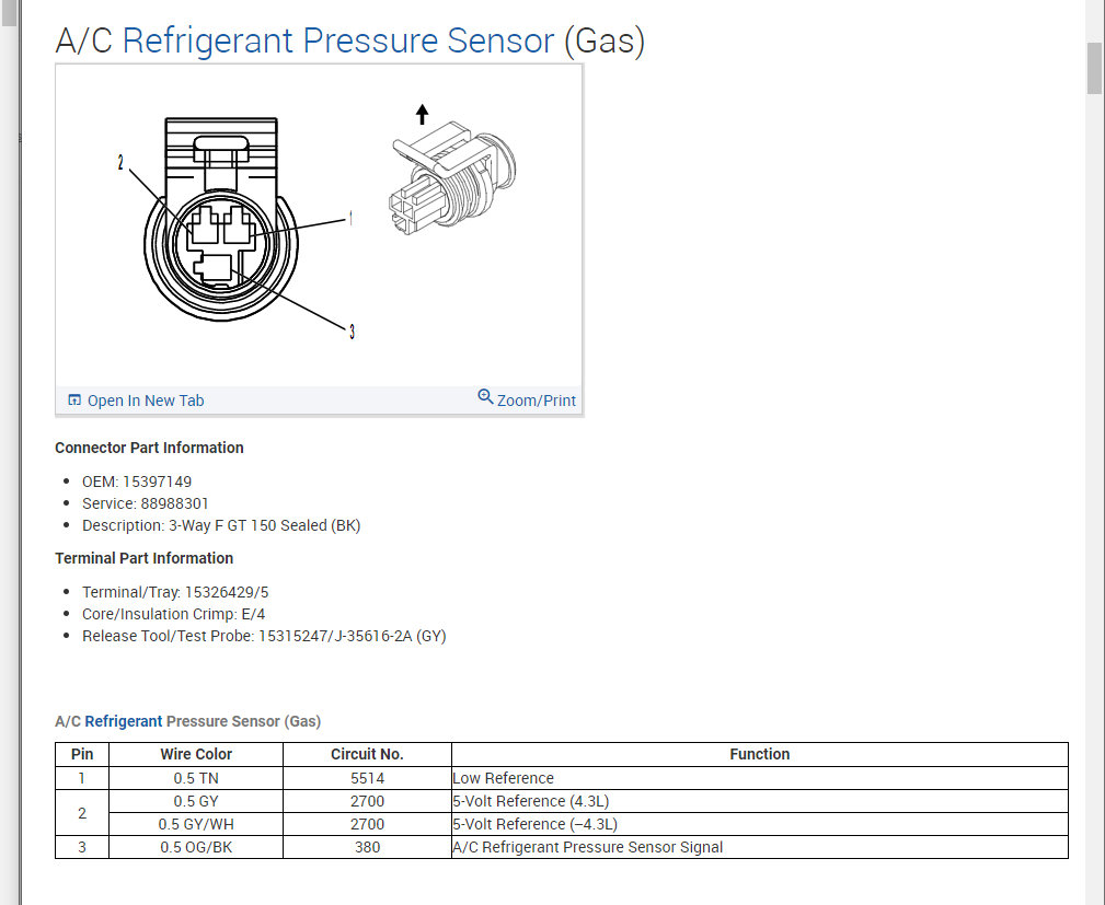

2) The high pressure switch is a three wire so you need to remove the connector and check for 5 volts on the reference wire from the module. Check the low reference at the same time by putting your meter in pin 1 and 2. You should have 5 volts.
Then the 3rd wire is the signal wire that needs to be monitored by back probing to find out if the voltage is moving steady and not jumping around. This would indicate a faulty sensor. In order to see proper pressure you need to hook a scan tool to the module and see what the sensor is actually telling the module. I don't have a voltage conversion chart on this vehicle but normally higher voltage is lower pressure and it drops as the pressure increases however, GM has used the inverse as well.
