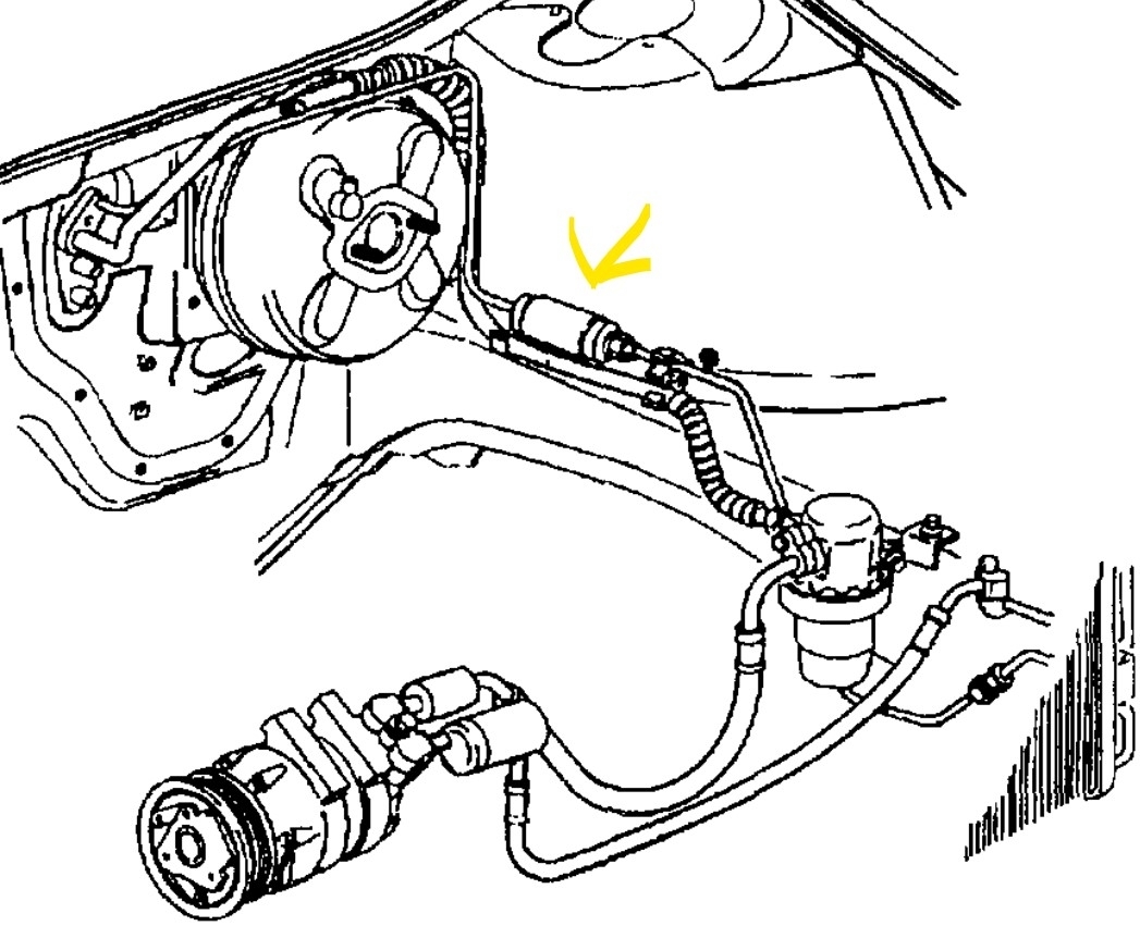

can the hold port be replace? look like the leak is around the port to does the port have a o-ring around it?
Aug 12, 2025 at 7:04 PM
STEVE W.
  • 15,421 POSTS
Take a picture of it and post it, the ports are part of the lines and parts, the only way to change them is to replace the complete line. I've never seen one leak at the welds unless they were damaged in an accident. If it's what I think it is, you are likely seeing leakage from the valve that the gauge coupler caused.
