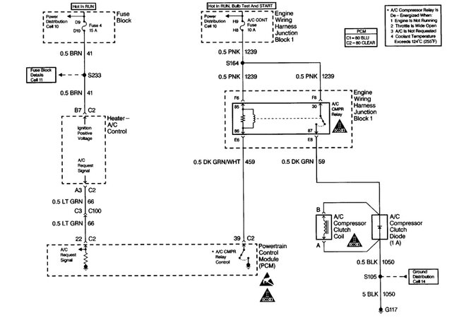

how do i check for power at the compressor wires?
Jul 7, 2025 at 9:33 AM
STEVE W.
  • 15,239 POSTS
You could substitute a test light, One is ground and the other is power that is controlled by the AC system. Power comes from AC fuse 10 through the clutch relay and to the clutch. A simple way to test it would be to go to that relay and jump from terminal 30 to terminal 87
If the clutch engages the wiring for it is OK. I suspect the issue is not the compressor or the wiring. The compressor only engages when there are certain items that work. The system has to have a full charge, that triggers the low pressure switch to closed. That sends power to the high pressure switch which should be closed. That then tells the ECM and BCM that the system it can engage the compressor if the control head has the AC on.
You had zero pressure which means a leak, you put in about half the charge. As soon as the compressor engages, the pressure drops and the compressor shuts off.
Your initial test shows the compressor and wiring works, it also shows that the low 134A charge is one problem. However the loss of all the 134A in the first place means there is a large leak. in the system and charging it will be a waste of money because it will simply leak out. So repair the leak. Then pull a vacuum and recharge and the system should work again.

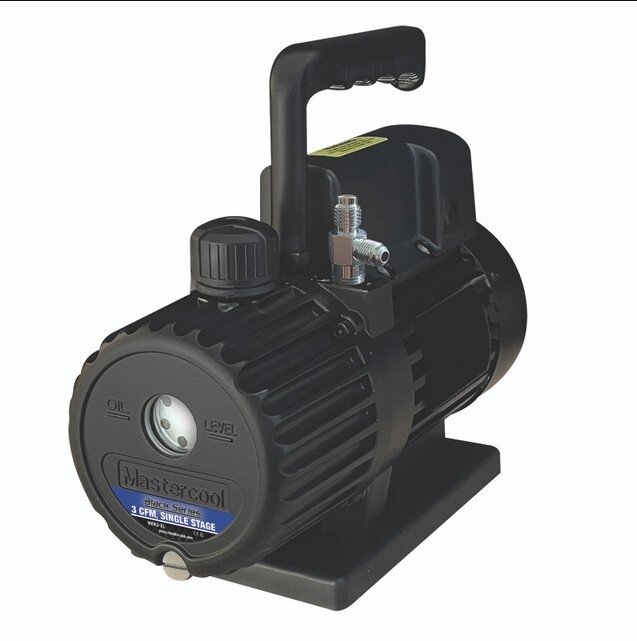

what does a vaccum pump look like?
Jul 10, 2025 at 12:20 AM
STEVE W.
  • 15,239 POSTS
Most are a variation on this. Many parts stores have them as loaner tools.

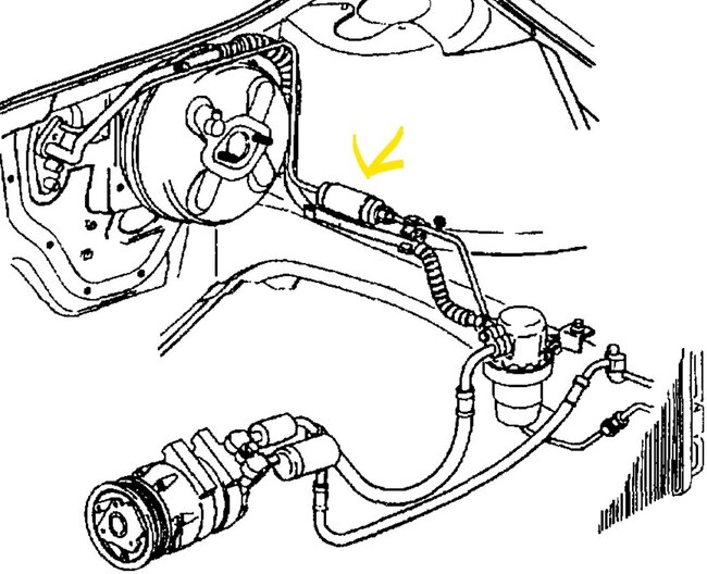

where does the orifice tube go on this vehicle?
Jul 21, 2025 at 7:05 AM
STEVE W.
  • 15,239 POSTS
Well, if they say it was filled I would almost trust them. They are the ones who have to warranty it if they didn't. The pulley will turn free, the front plate is what turns the compressor, that is what you need to rotate, it will be stiff but it should turn with moderate force.
Jul 21, 2025 at 7:17 AM
STEVE W.
  • 15,239 POSTS
Orifice tube goes in the high pressure line (smaller line) between the condenser core and the evaporator core in the dash. Be sure it goes in the same way the current one comes out.

can you send me pictures?
Jul 21, 2025 at 8:57 AM
STEVE W.
  • 15,239 POSTS
This is about the only image that shows the lines.
