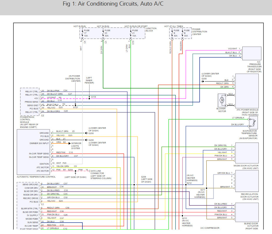

The A/C clutch burned out. Like the center of clutch where the rubber part is at about a year ago. I replaced it with a used one and now the clutch won't engage. I read different things on how to engage the clutch but not sure if I'm doing it right. Thought that it might be low on Freon so I hooked up a bottle on the low side like you are supposed to do. The have reads all the way to the red so I'm thinking that something else might be wrong or how can I get the clutch to engage so I can check if that is working? I would appreciate your input. I need cold air in the car when I'm driving to help me breath. Thank you

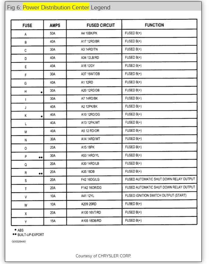

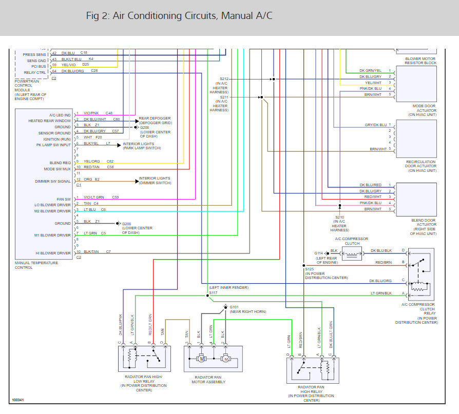

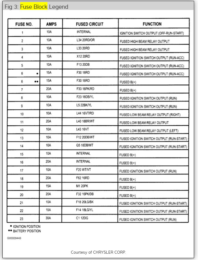

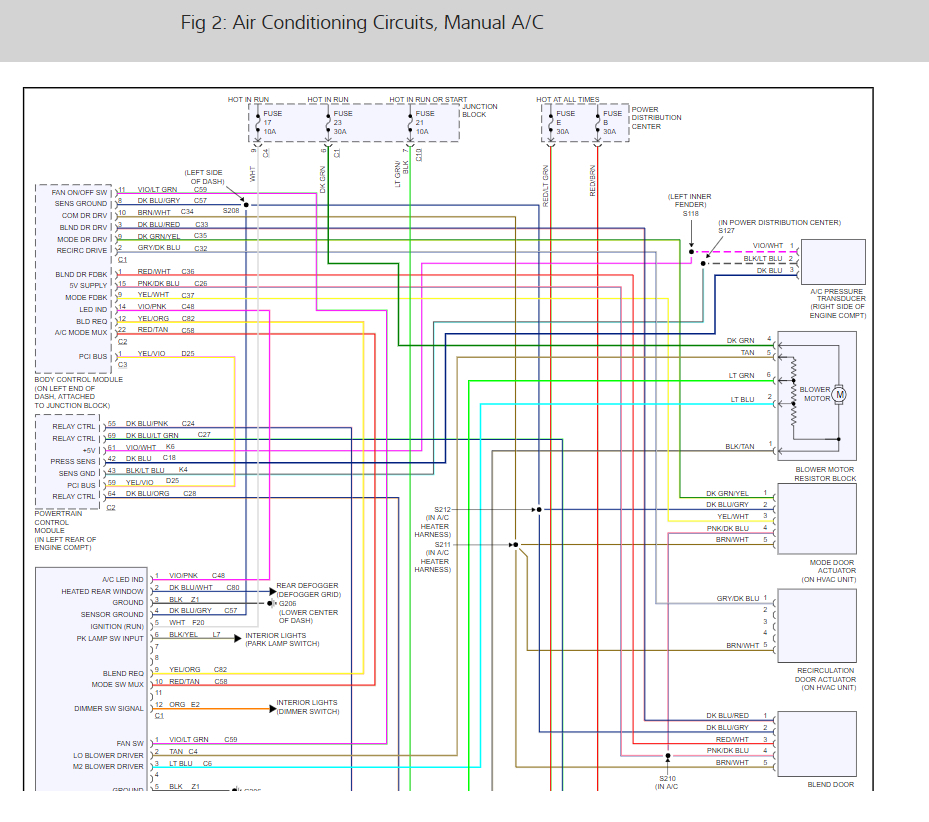

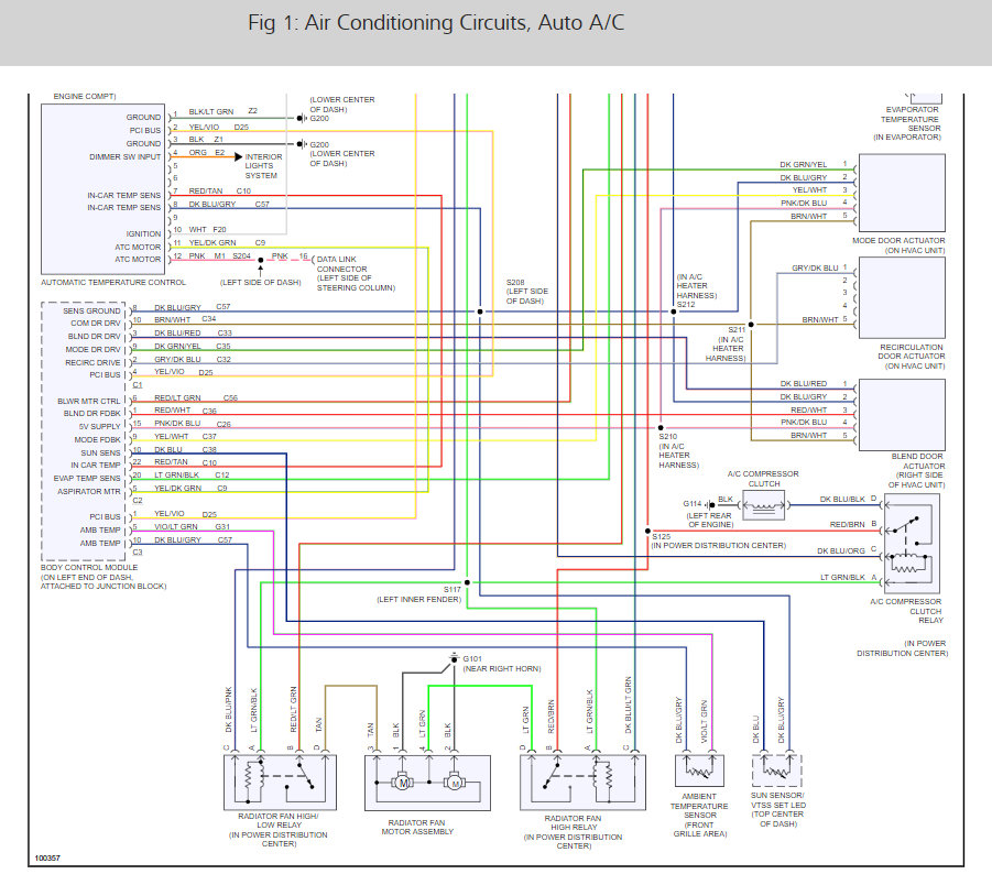

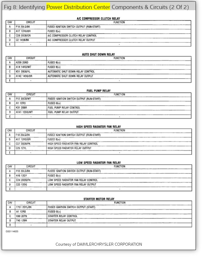

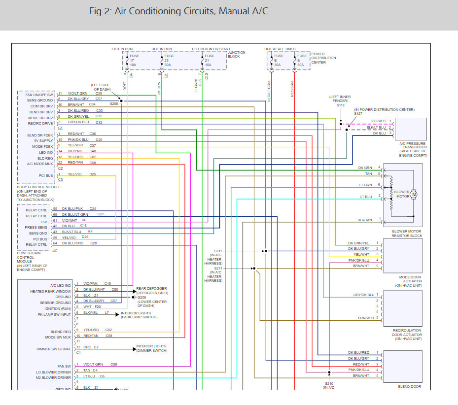

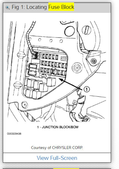

If I can jump in here. the low side gauge could be in the red because the system is not working (compressor operation). Here is an air conditioner wiring diagrams so you can see how the system works and to check for power at fuses #17, 23 and 21:
This guide can help as well:
