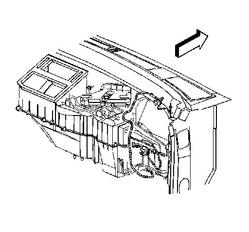

See pic 1 for HVAC control module.
____________________

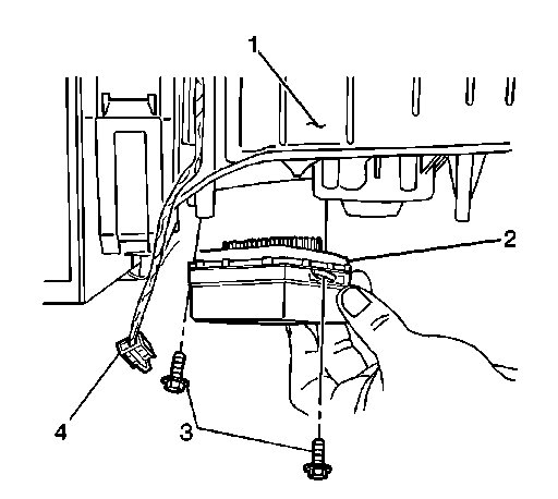

pic 2
1. If equipped, remove the sound insulator panel.
2. Disconnect the electrical connector at the blower motor.

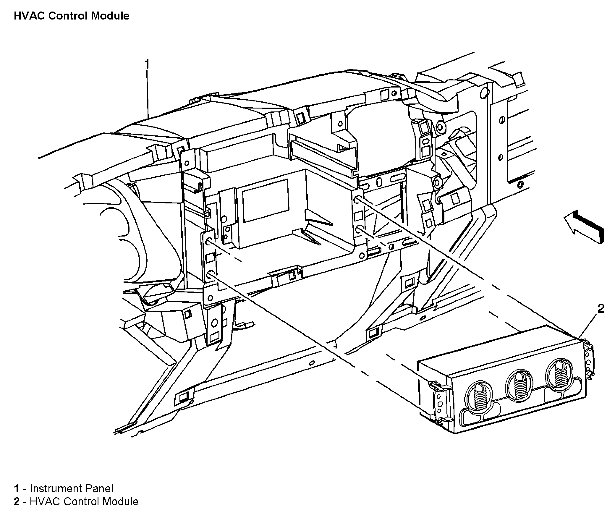

pic 3
3. Disconnect the electrical connector (4) from the blower motor control processor (2).
4. Remove the blower motor control processor retaining screws (3) from the HVAC module (1).
5. Remove the blower motor control processor (2) from the HVAC module (1).
