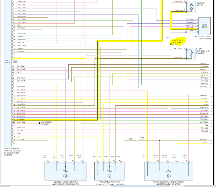

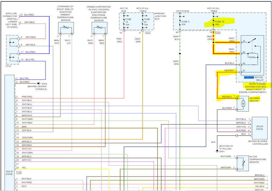

Hit a pothole, hard bump and the A/C blower stopped working.

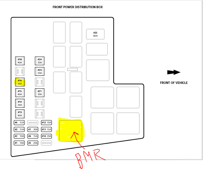

The first thing I need you to do is check fuse 16 in the engine compartment fuse box. In addition to checking the fuse, confirm there is power to and from it. If that is good, remove the blower motor relay and reinstall a different one from the box having the same part number to see if it works.
If there isn't one with the same part number.
Here is a link that explains how to test a relay:
If that checks good, I need you to locate the blower motor under the dash and disconnect the connector to it. There will be a red wire with a black tracer that should have power. Confirm that for me.
Let me know what you find. Also, let me know if the blower motor was making any strange sounds before you hit the bump.
I attached the wiring schematic below, so you have a reference. Additionally, here is a link that you may find helpful:
See pics below. Note: The schematic page was cut in half to make it readable for you. I overlapped the two pics so you can follow from one to the next. The last pic shows the fuse to check, and I highlighted the blower motor relay (BMR).
