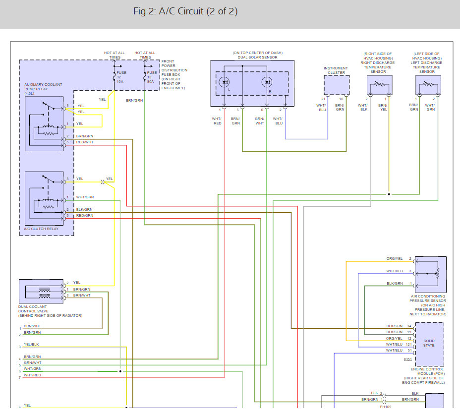

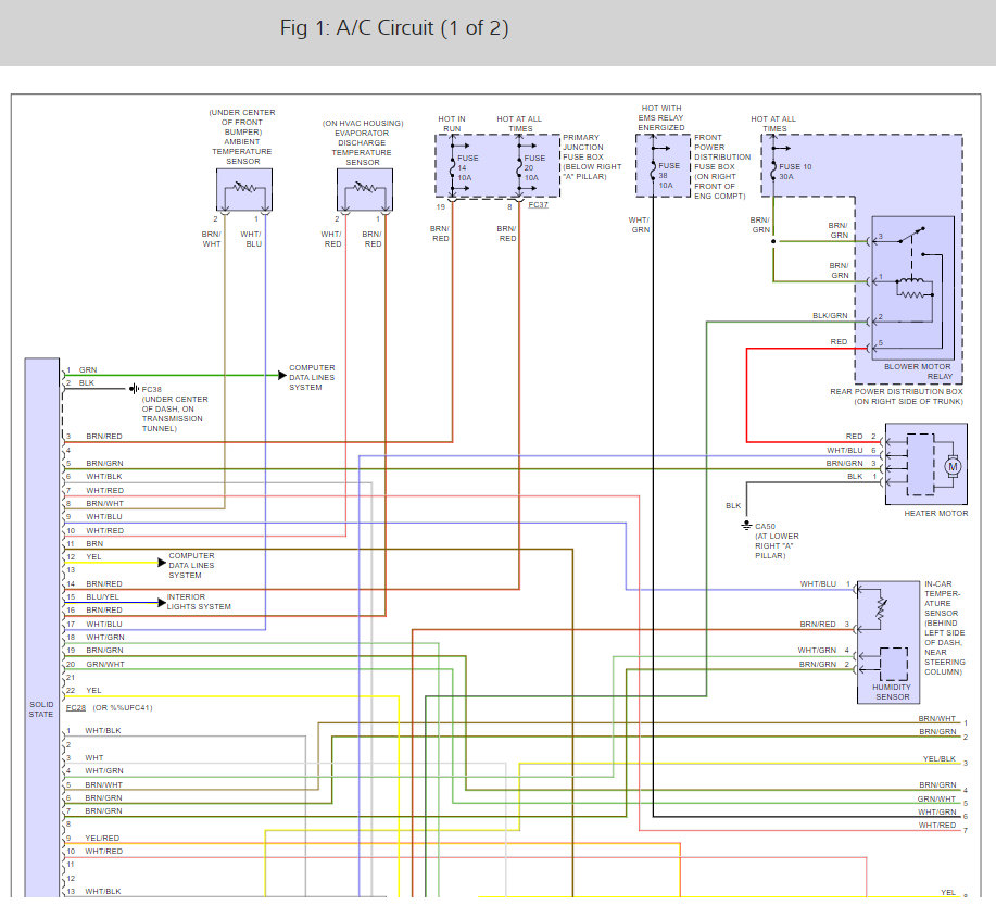

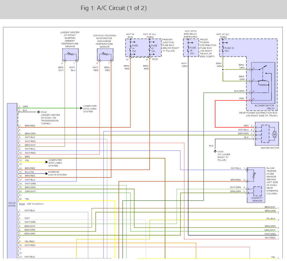

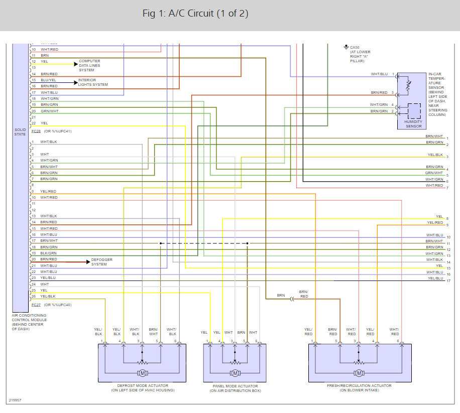

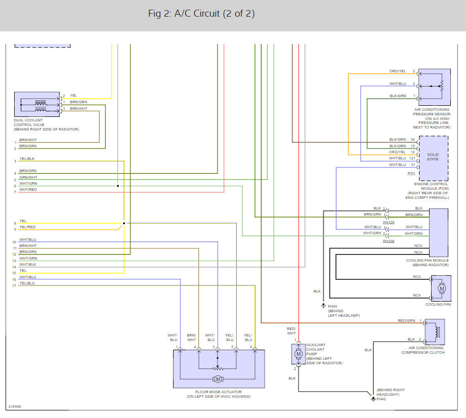

Hi 2carpros,

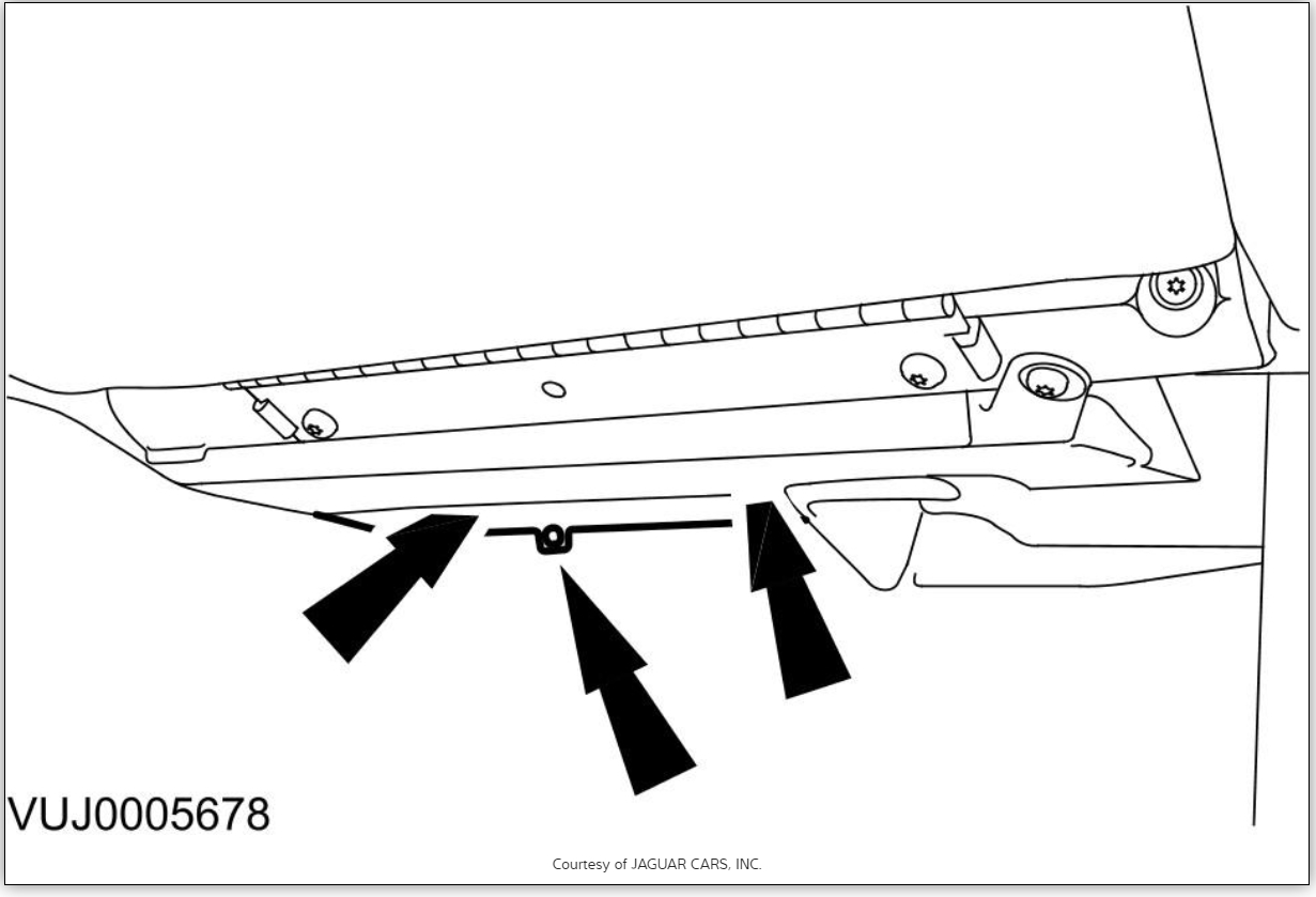

My 05 Jaguar ac/heater blower stop working, I already check all the fuses, and they seem fine, all the function on the climate control works too, just have no air blowing out, I like to know what wire I need to check on the control plug to see if there is any output going to the blower ?
Thank you
KC
Feb 24, 2010 at 6:07 AM
  • 55,649 POSTS

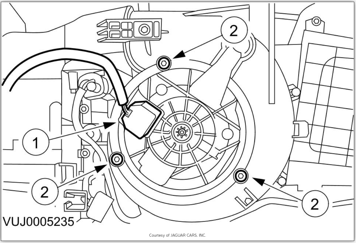

Is sounds like the blower motor has gone out but to be sure lets run a simple test by following this guide which shows you how to test and give you an idea on how to replace the blower motor if it tests positive for failure.
https://www.2carpros.com/articles/blower-fan-motor-works-on-high-speed-only
Here are the wiring diagrams for the blower motor (below)
