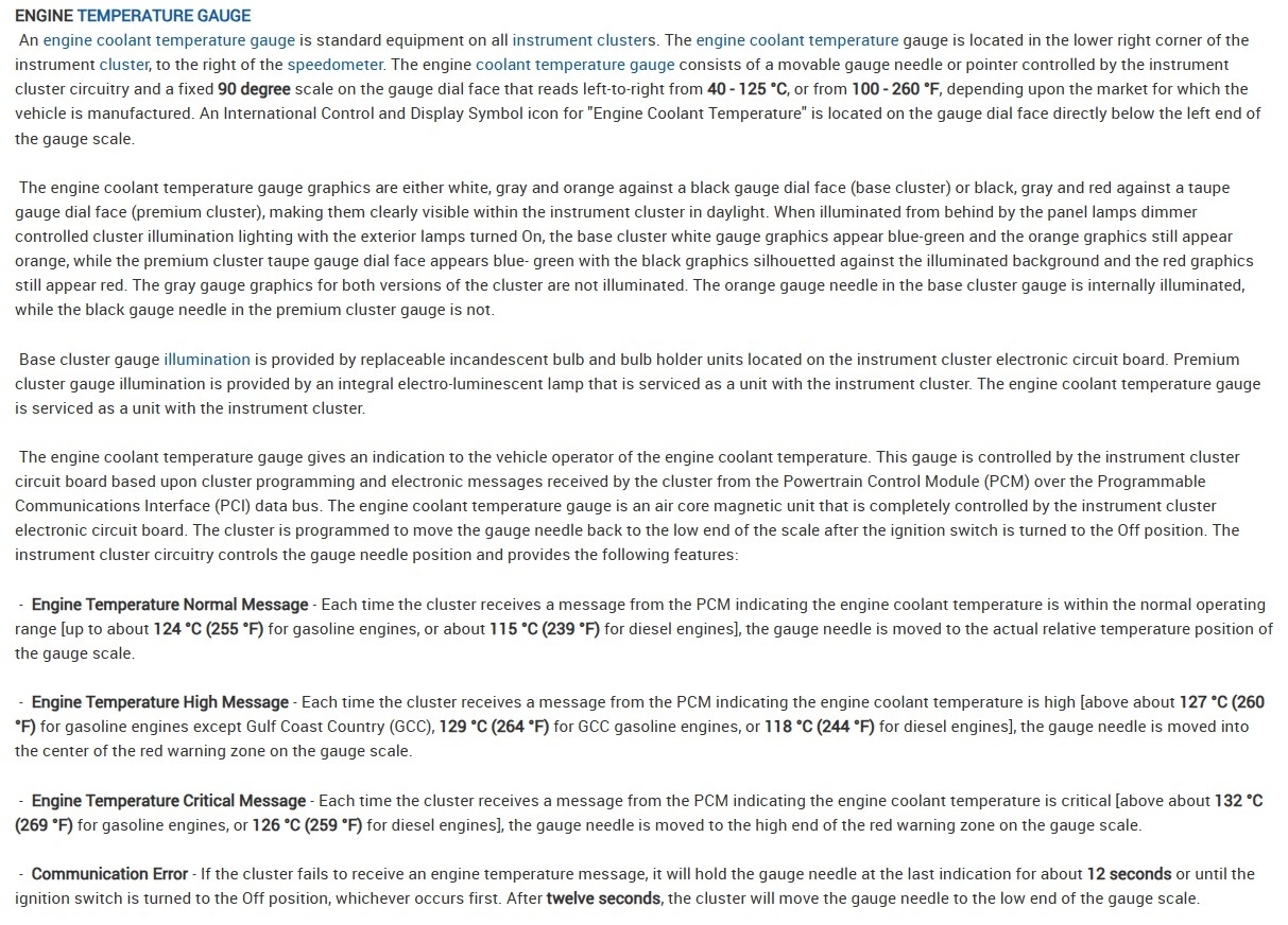

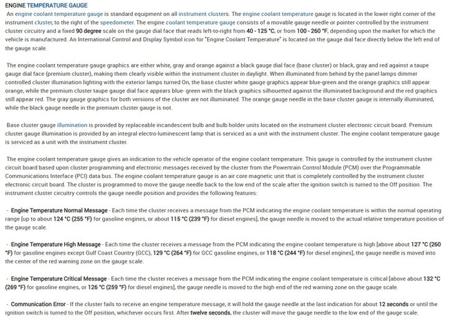

Well, I finally found some service info on engine temps and the warning messages, according to this you were receiving the Engine High Temp message because the coolant temperature was getting above 260f, and being below 255f is apparently within normal operating temperatures, which is why the message turned off, seems very high to me,
And 269f is where you will get a critical high temperature message.
The gauge on the Cluster reads 100-260f, that's its range, still you shouldn't see the ECT glitching out, But I guess 220 is within spec, that explains why you aren't seeing the fan on High at that temperature.
