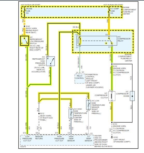

I also attached a wiring diagram for you to view in case there is Freon in the system so we can do some checks.

It have a leak but it’s more then enough in it to keep the system working.. so far I took my fuel pump relay put it in where the A/C compressor relay goes it still didn’t come on. I then jumped it with a wire and it came on.. Auto part store said it maybe my cut off switch. But a friend of my say it’s not a cut off switch that it can be the control panel..

Okay, I sent you a diagram. We are not going to guess here. We are going to find the failure.
First, I need you to remove the relay and turn the key on and the A/C. Test for power to the relay. There should be 2 powers present in the relay cavity.
Also, do you have gauges to give me the pressures?

I see the diagram but I don’t understand it.
