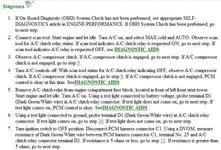

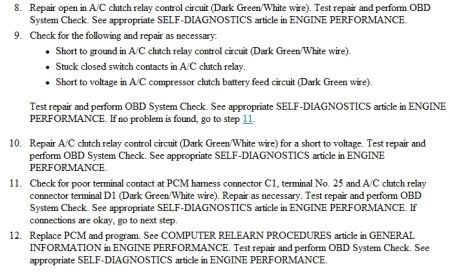

I recently had a tech check out my AC and he said the compressor isnt coming on, I have equal pressor (70 pounds on both ends) but the compressor isnt coming on. How do I diagnose if its the compressor or sensor? I would really like to save some money, Thanx!
Jul 17, 2020 at 4:55 AM (Merged)
BLUELIGHTNIN6
  • 16,542 POSTS
Hello The only true way to test the compressor circuits and see what the culprit is will be using a scan tool. If you do have a scan tool, follow the diagnostic steps below. But you can reset the compressor without as well, instructions below. The DTC's can be cleared in two methods, Scan Tool method or On-Board diagnostic method... Clearing (DTC)s On-Board Diagnostic Method 1. Press OFF and WARMER (digital IPC) or OFF and PASSENGER WARMER (analog IPC). 2. Press LO (fan speed) button until Air Conditioning Programmer (ACM)? appears. 3. Press HI (fan speed) ACM CODES? appears. 4. Press LO (fan speed), ACM CLEAR CODES? appears. 5. Press HI (fan speed) to clear codes. ACM CODES CLEAR appears.
https://images.2carpros.com/forum/automotive_pictures/261618_Noname_2410.jpg
https://images.2carpros.com/forum/automotive_pictures/261618_Noname2_782.jpg

if you have an AC code it wont turn it on
